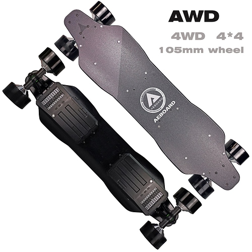

If you really want those 105mm hubs, you could buy an AWD:
upgrade your deck and enclosure:
https://www.eboardsperu.com/product/evo-40-ds-combo
and bushings:
https://www.riptidesports.com/electric-skateboard/
later, upgrade the battery, etc., and learn as you go.
best of luck.
