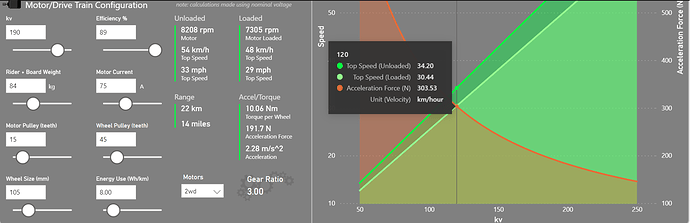

My Second Build. I wanted something small, portable and more maneuverable than my
Blue Dream , which became a chore to bring along while on campus.
This 31.5 inch “speed-tail” is 9.75 wide, has a 19 inch deck wheelbase, a 25 inch truck wheel base, and is ~13.5 inches wide at the wheels.
Current parts include:
Old School Pig deck
12s2p Molicel P42A
Flipsky BH 6354 190kv motors
Xenith 2.1 esc
Mboards enclosure
Flipsky 12" DKP trucks
Riptide DKP 93a kit
MAD 105mm wheels
14t/40t pulleys
This board is awesome and just fits my needs as a daily driver wether I’m on campus or on bike paths. It has plenty of torque and enough speed for most scenarios but can also cruise at >10mph without looking silly.

Enclosure, battery and ESC(replaced with Xenith).
Comparing the difference in standing platform. Cherry Angio easily beats Blue Dream .
Front end.
Ground clearance is great, and I love this back end.
Motor current max : 65a
Motor current max brake : -65a
Battery current max : 30a
Positive ramping time : .10s
Negative ramping time : .20s
Smart reverse ramping time : 2.00s
Throttle expo : 9
Throttle expo brake : 0
Throttle expo mode : Exponential
HFI samples: 16
HFI Start Voltage: 14.00V
HFI Run Voltage: 6.50V
HFI Max Voltage: 12.00V
HFI Gain: 0.100
Sensorless ERPM HFI: 3000.00
HFI Start Samples: 9
HFI Observer Override Time: 1.0ms
