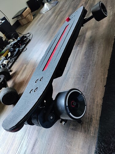

Loaded sent the 75mm wheels instead of the 85mm.
97s came in from Mboards, added Beasto built-in bearings. The wheels are not as wide as the meepo wheels and now she’s a hair less wide at the wheels.
My initial plan was to shave, dye or paint the white off these wheels but they’re kinda reflective. This would be helpful for being seen at night.
Wrapped the inside of the Mboards enclosure in gorilla tape and added some foam to the sides and bottom.
Now the battery has a nice snug bed to protect it from the world.
The board is ~20lbs and has some flex for me at 165lbs. The tail is kinda hard to use atm but I’m expecting grip tape may change that.
I wanted to see how changing DKP into TKP would effect the build.
First off, while reverse mounted, the motor mounts would not clear the deck. Forward mounted the motors would not clear the enclosure.
Second, the ride height was reduced by half an inch. Doesn’t sound like a lot but the board looked like a low rider.
Lastly, the truck wheelbase was reduced by ~2.5 inches. A 22.5" truck wheelbase is common on short boards this size.
It would have been nice to experiment between DKP and TKP on the same setup but the positioning of the enclosure doesn’t allow for it. I really wanted to compare the shorter, lower TKP setup to the longer, taller DKP setup.
If only I could keep the longer truck wheelbase while lowering the ride height.

Finally got the board in working order and took it out on it’s maiden voyage. The short wheelbase and dkp felt as maneuverable one would expect. It’s awesome.
I was able to get up to ~28mph while feeling uncomfortable loose at the trucks. I wasn’t sure if a 33mph top speed was too much but now I’m certainly optimistic she’ll do it easily. With the battery gauge not currently working, I got ~19 miles before I gave up on range.
The extra clearance, portability and maneuverability of this setup sometimes make me wonder if this jack of all trades build is the only board I’d need…

You know. If you are really going to take this all over you may like the MAD wheels on there from @fujio001
They are actually 101 not 105 so won’t seem that much taller.
And the grip is nuts dude. Good dampening too.
I bet it be way cushier than those 97s
You’re reading my mind. These are the main wheels I’d think to upgrade to.
