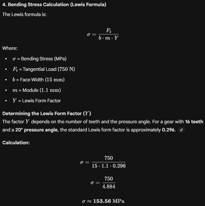

@Dinnye I really appreciate you taking the time to lay all of that out. I was trying to read and understand it last night but that information did not pair well with an edible :sweat_smile: . If I’m prompting Chat GPT correctly and if it isn’t purposely trying to kill me then it looks like these gears are well within acceptable limits. The steps it took are laid out below.

:five: Tooth Bending Stress Estimate
Using conservative Lewis-form approximation for:
  • 16T
  • Module 1.1
  • 20° pressure angle equivalent
  • 15 mm face width
Estimated bending stress:
Condition Approx. Bending Stress
750 N 120–160 MPa
1500 N 240–320 MPa
:six: Comparison to Material Strength
Conservative material yield estimate:
σyield≈900 MPa\sigma_{yield} ≈ 900 \text{ MPa}σyield​≈900 MPa
Safety factor (steady):
900150≈6\frac{900}{150} ≈ 6150900​≈6
Safety factor (shock):
900300≈3\frac{900}{300} ≈ 3300900​≈3
So:
  • Continuous bending safety factor ≈ 6
  • Shock safety factor ≈ 3
This does not include load sharing from herringbone engagement, which further reduces actual stress.

Some feedback to the “chatgpt approval”: it completely forgot about the existence of fatigue. The 900 MPa it guessed as material strength isn’t the number that anyone would consider acceptable repeated load. Acceptable repeated load is 25-30% of that number, especially for additive manufacturing. It might be up to 35-40% for substractive manufacturing. So lets say 250MPa in this case.
I don’t love that it didn’t write out the full equation how it got the 120-160MPa, but the correct value is 153MPa so it’s okay.
It’s below the 250MPa max acceptable load for fatigue resistance so you are good. The safety factors it calculated are completely messed up, but it doesn’t matter. Generally, on electric motors intending to peak at 25% material strength is already perfect fatigue resistance without extra safety factor, assuming the teeth is hard enough not to wear down (and thus weaken the teeth, by having thinner geometry) as they have very minimal torque ripple. Not to mention you won’t actually operate for much time at full torque. 60% of that magic 25% limit gives you fatigue resistance even with worn teeth.
I think especially with SLM, that teeth isn’t fully smooth to start with, relative prime teeth counts are a good idea.

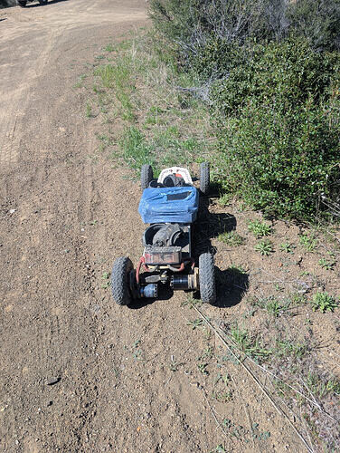

Major drive failure yesterday.
I lost all four bolts that pass through the hanger clamp into the threaded holes in the back of the gear tub. To make matters worse, the female threads are now stripped out.
It’s entirely possible that I forgot to use thread locker on this side. The other side is still tight.
Another potential cause is that there isn’t enough solid metal around each hole, weakening the walls of the threaded holes.
I’m leaning toward forgetting thread locker since this is the first time a failure like this has happened on any version of these drives. Loose bolts subject to vibration and impacts seem like they could destroy female threads pretty easily.

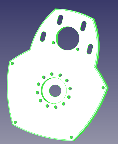

To be on the safe side, I’ve reworked the model to hopefully add a little strength to the threads. Some of the holes have been eliminated. The drive adjustment will be a little more limited but should still be able to find a good mounting angle.
I also reduced the diameter of the recess hole that slides over the hanger from 28mm to 26.5mm, adding a little more metal to the inside of the ring of tapped holes.
The tapped holes are deeper now too for more thread engagement.
I have a few other ideas to correct this if the threads decide to fail again but this was the easiest fix so really hoping it works. Replacement pieces should be here in a few weeks!
