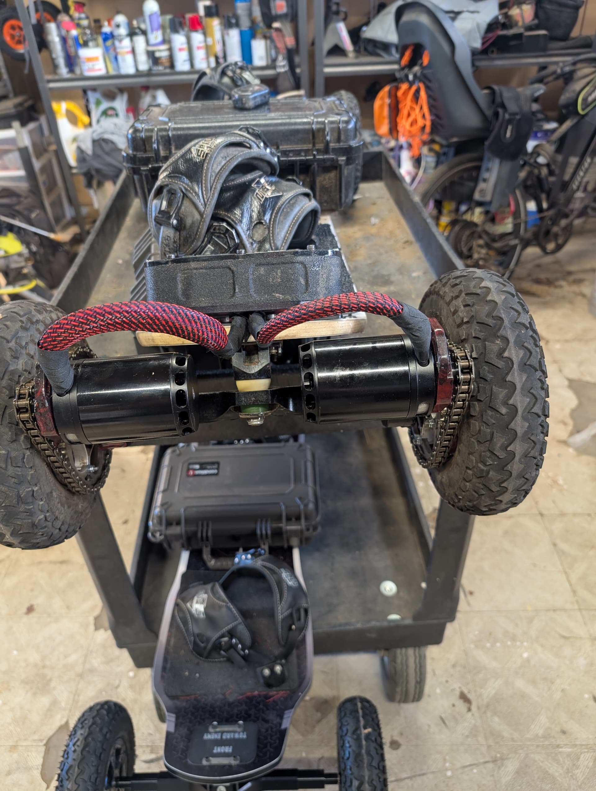

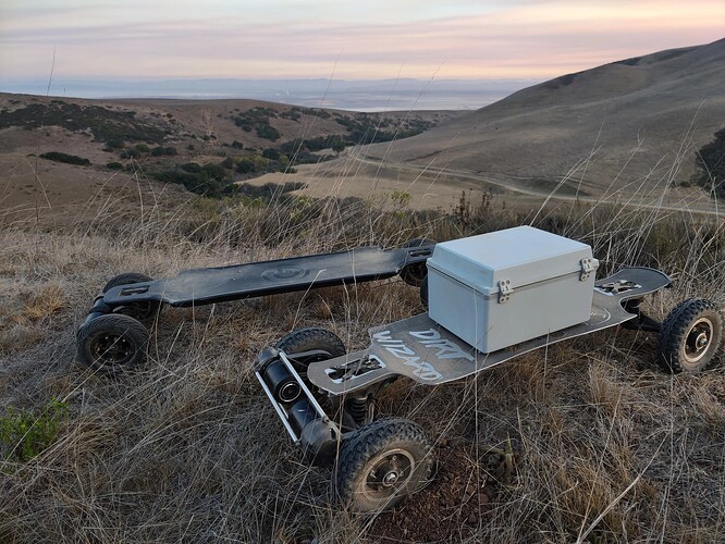

Here are the builds as they were a week or so ago before the recent changes.
Setup for this one was
Trampa big boi deck with wings
Apex Airs
Apex Chain Drive @ 1:5
MBS F5 bindings & heel straps
Trampa Phatladz with L-Faster 9" tires
Maker X DV6 Pro
Flipsky 63100s @ 170KV
VX4 remote
Motor Amps - 95
Battery Amps - 60

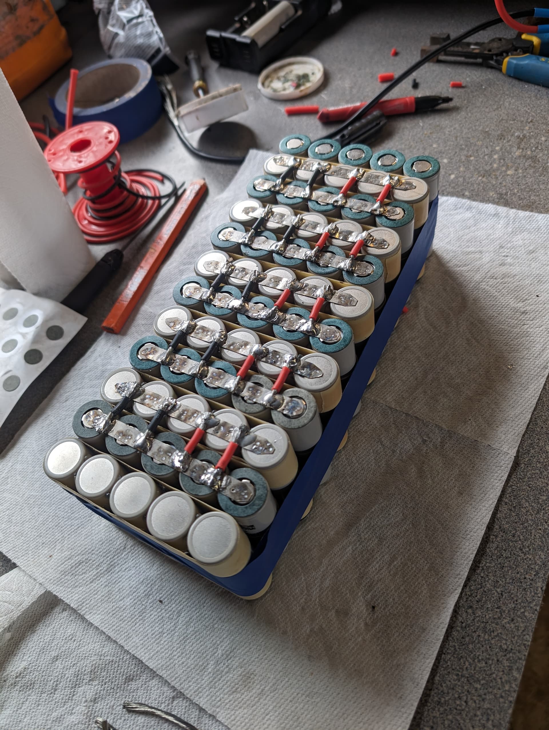

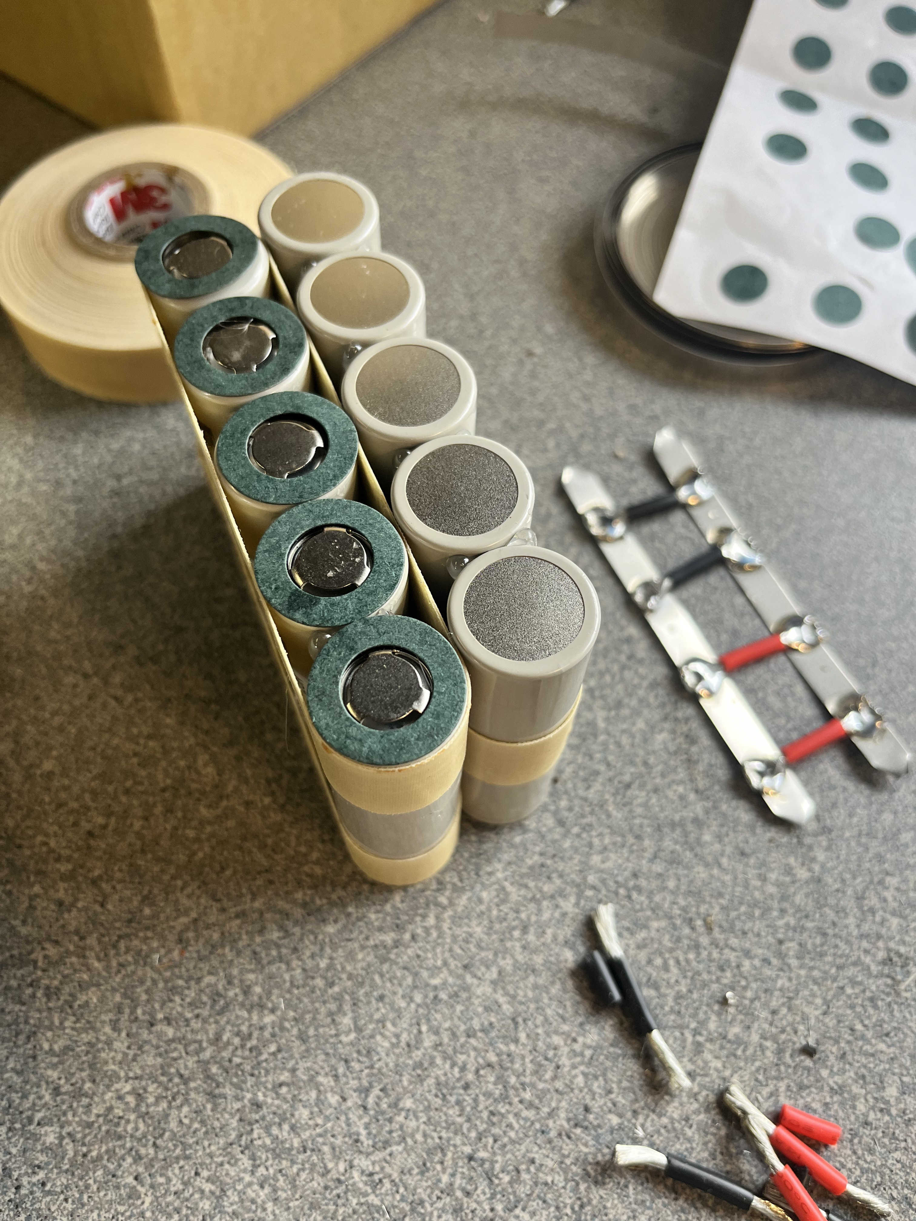

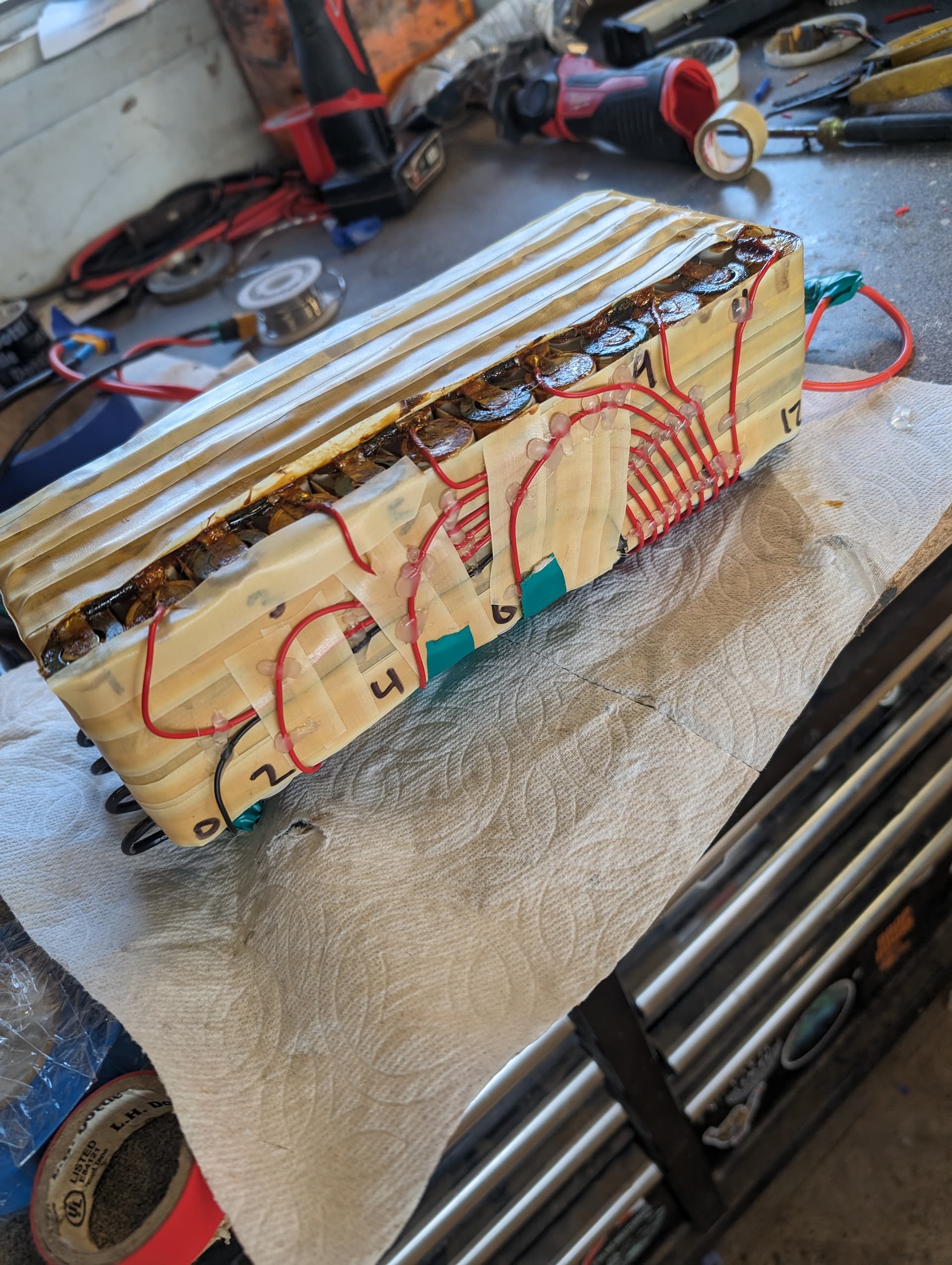

I have two batteries that can go into either board depending on what type of ride we’re doing. One is a 12s 6p of p45B and the other is 12s 4p of P42A. We’re all still stuck in the 12sverse but plan to change that in the near future. Battery photos below are from a 12s 5p P45B pack for one of the other guys but they’re all built pretty much the same. I’m no pro builder, but have built 9 packs that have held up well.
A couple of notes on the battery…
Cambric tape is used in place of fish paper for insulation between P groups and general abrasion resistance. It is used in the electrical industry for basically the same purpose and is a proven product for insulating and protecting conductive metal in tight spaces subject to vibration.
The brown goo you see on the cells is called Skotchkote. It’s another product used in electrical applications. Main purposes are water proofing, abrasion resistance in industrial applications subject to vibration & just generally locking things together.
Cambric tape is woven. When combined with Skotchkote, the “cells” in the tape absorb it really well and create an extremely durable non conductive shell. This stuff wouldn’t be practical (or necessary) for most battery builds as it’s pretty expensive, but I have a large stash of both leftover from projects over the years so decided to use it.

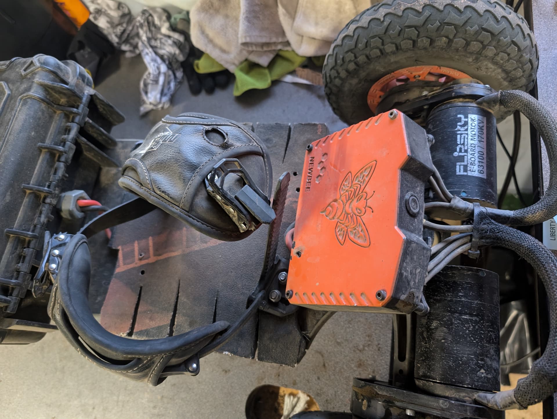

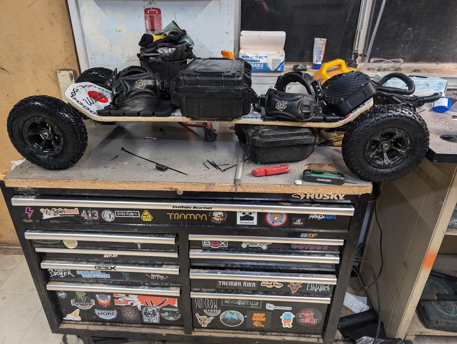

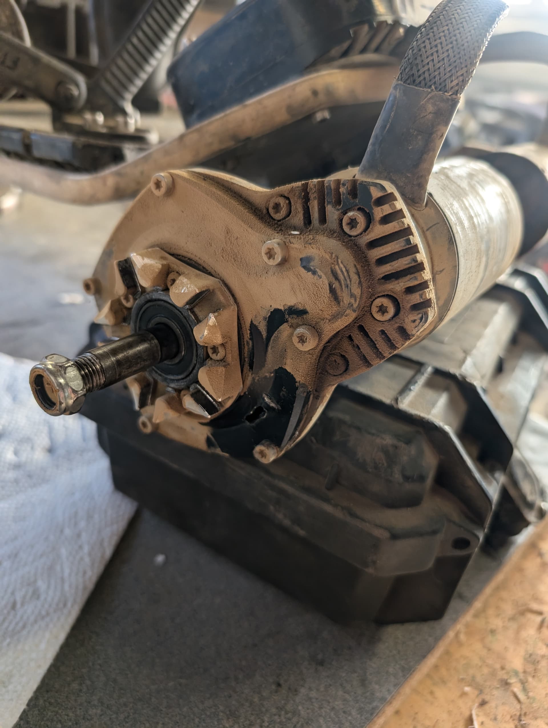

First priority was the chain drive build. I wanted to convert this board to gear drive and decided to try out the Boardnamics M1AT steel gear drive @ 5.2.
A couple of trial runs and I was happy with it. A little disappointed to receive helical gears instead of straight cuts like the website says, but life goes on. I’ll have to be sure to check the pinions every few rides or so.
One of the 170kv motors was taking a shit. The can was spinning lopsided, probably from bashing a rock riding at Refugio Road. Great ride with a mix of single lane asphalt, plenty of dips, banked turns and hills, then as far as your battery will take you on some rough rocky dirt roads with plenty of small jumps sprinkled in. You’re riding a mountain ridge with a great view of the Channel Islands and Lake Cachuma, and it’s rare to see anyone else up there. If any of you are in SB county and looking for some fun scenic off roading, hit me up.
Flipsky is having a flash sale and the increased ratio from switching to the BN drive made me want a higher KV so ordered some more 63100s @ 190kv instead of 170. You know how it goes, if you’re already changing the motors & drive, might as well go deeper…
Already had extra grip tape laying around since it was ordered at longboard length and I only use enough to cover the Trampa wings.

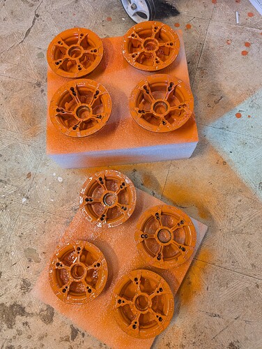

The Newbee case was looking old and so were the hubs so decided to put a quick coat of orange enamel on both. The wife was busy in a zoom class all day so I was able to expedite the hub cleaning. If she comes out for a break, she’ll just think I’m doing dishes…
Two new tires, a lot of scrubbing and this thing is good to go. I haven’t had a chance to take the new motors out for a ride yet because the other board really needed some work. Hoping to get it filthy in the next few days.

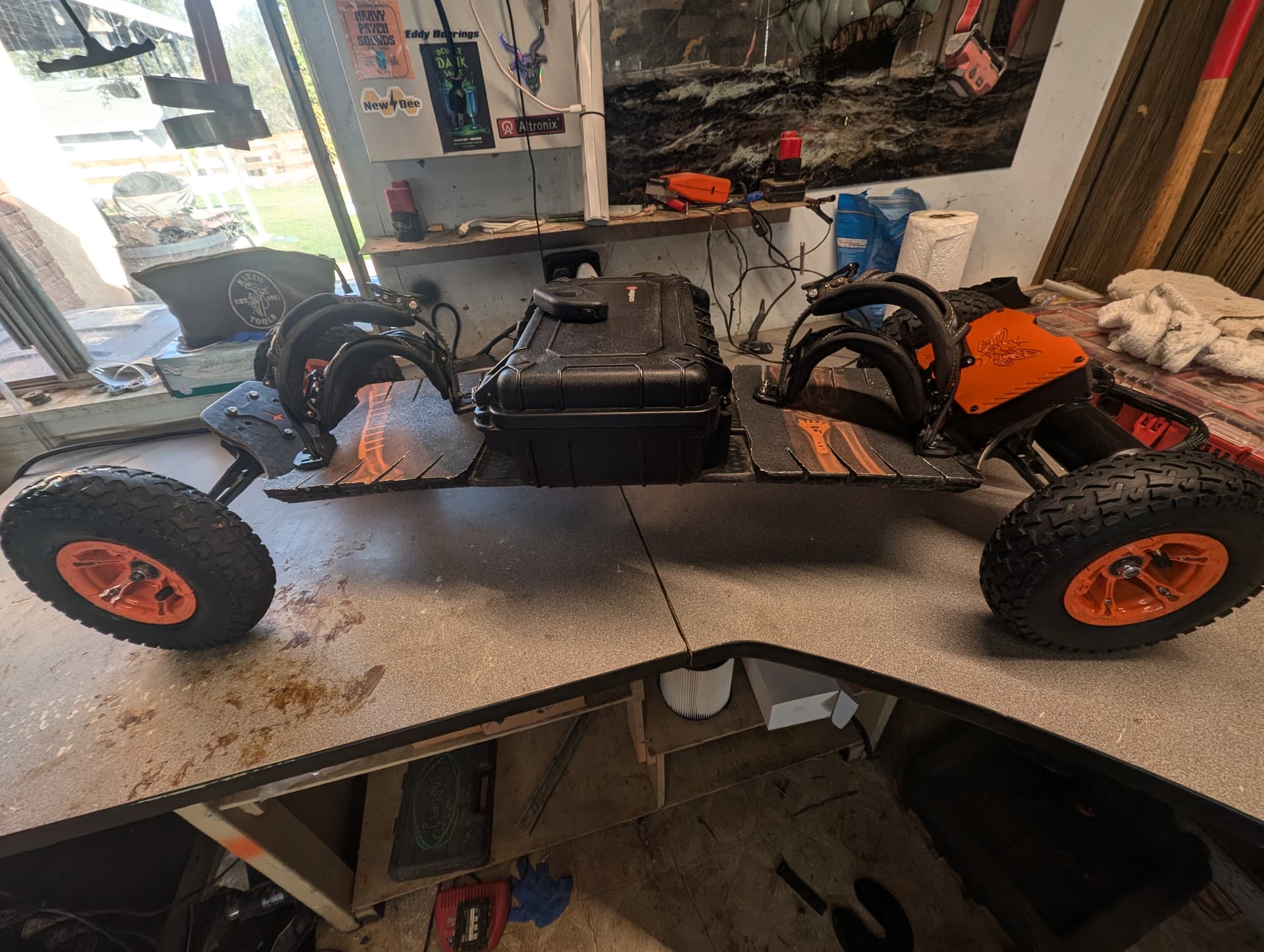

Now on to the other board. This thing really needed some maintenance. I used red permatex 21700 instead of green loctite 648 on the bolts that mount the slave gear to the adapter. This resulted in bolts backing out inside of the tubs and a lockup. One of the bolts tore through the tub cover, everyone made fun of me, nothing good about this situation.
I did just receive a box wrapped in Apex tape with all of the replacement parts needed to get the drive running again, but decided to save the Jump Drive for when the Agent deck comes out. The Warren deck is just begging for a chain drive and my life would not be complete without a functional one so cleaned up the drive previously mounted to the Trampa deck and put it on the MBS.
The existing motors on this thing were 190kv which seemed a little too high for the ratio. A lot of our rides are sustained steep uphill for miles so wanted a slightly lower KV with the 9" tires. Ordered two 6485s @ 173KV from SKP, along with some Solos in the 3d Servisas enclosure. There was nothing wrong with the Stormcore but it probably wouldn’t let me take advantage of the higher current Reachers. Added another set of #10 wires from the battery to the 3D Servisas enclosure since each Solo requires a connection to the battery.
Setting everything up was painless with a little help from SKP. It was throwing ABS overcurrent faults when bench testing unloaded. All that was needed was a firmware update then everything was good. I’m comfortable using the VESC tool basics but am always hesitant to fuck with firmware without confirming it’s OK to do so.
Four new tires and it’s good to go. (photos are before I put the mounting plate under the enclosure.)

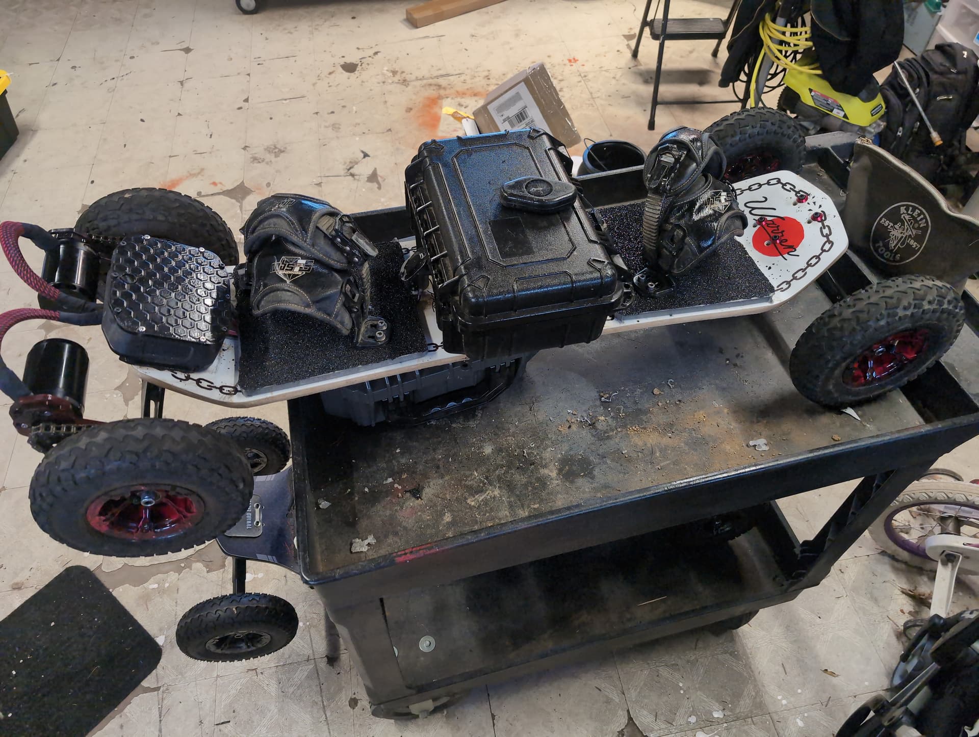

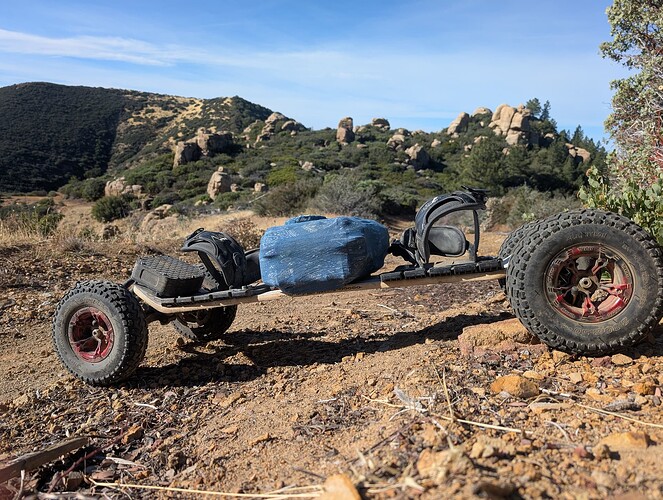

Immediate disclaimer, this is not a fishing attempt for BOTY. The board does not qualify because it existed in '23. The only recent changes were SKP motors, Solos/ 3d servisas enclosure, slightly bigger battery and swapping from jump drive to chain. New hubs too but they’re the same Phatlads. Thought it would be fun to hydrodip some red ones with my daughter.
I’ve finally spent enough time on this thing to give it a proper name, Dick Chainey. Yes, it’s a bit on the nose being a chain drive and all but trust me, it has more power than it deserves with a complete disregard for human life. I’ve read a lot on here about how much better reacher motors are than flipskys but honestly never would have guessed it would make that much of a difference. This couldn’t have come at a better time because a ton of forest road work just finished at Figueroa Mountain and I swear they made these roads with us in mind. No massive table tops or anything but the way back down has around 8 good jumps. Best part is it’s practically empty this time of year. I’ve said it before and I’ll say it again, if you’re in Santa Barbara county HIT ME UP! I’ll point you to some sick rides based on whatever board you’re on! Enough bullshit. Pictures!

It’s my favorite ride. Started off with jump drives then swapped to chains. This deck is a perfect middle ground between the Bro and the Trampa Big boi. Adding the Trampa wings is a bit unorthodox but feels great and creates a good tunnel for the four #10 wires feeding the Solos. I guess the only complaint would be not having inserts for the battery enclosure, but I could just add them. Would definitely recommend.

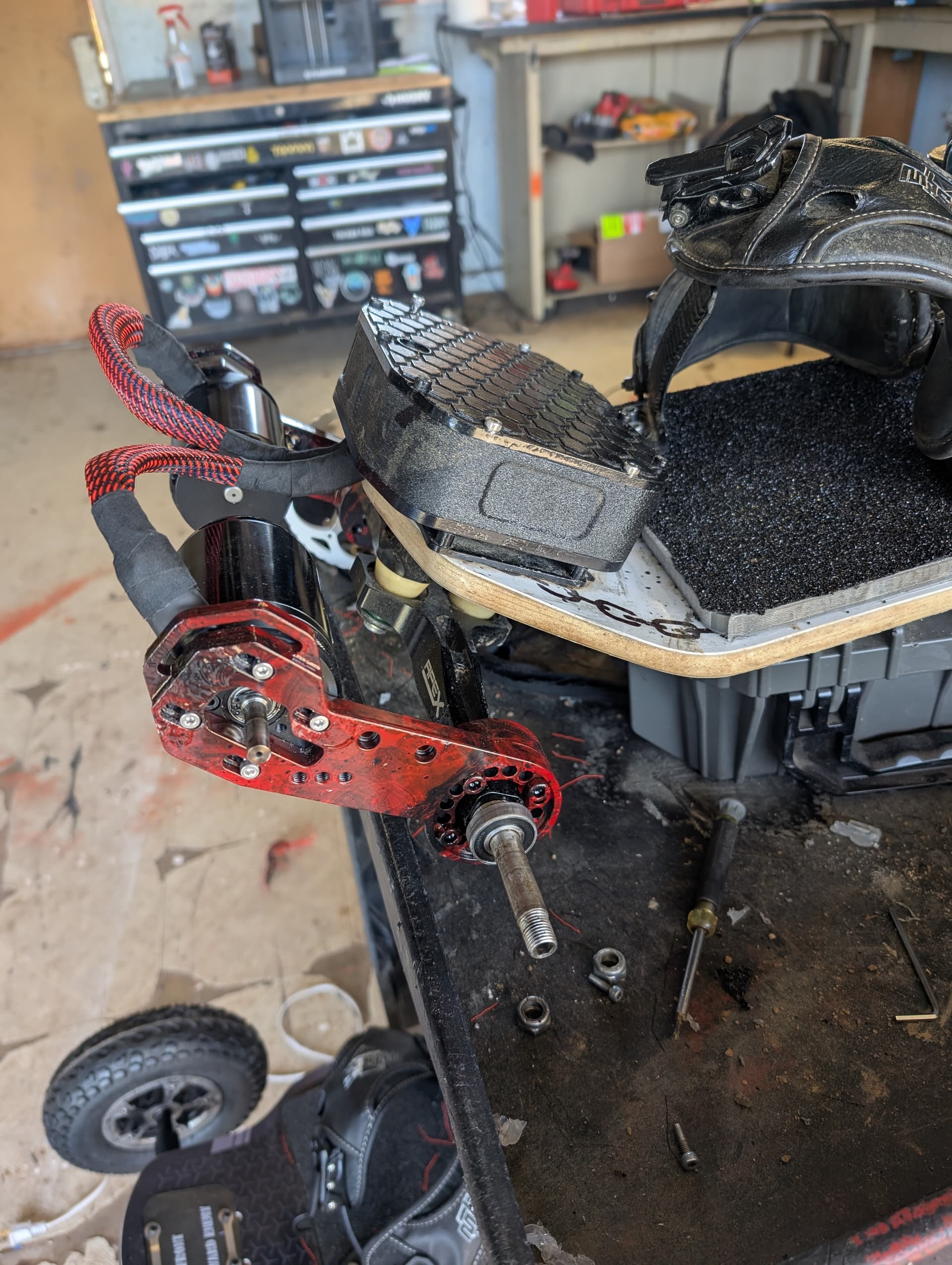

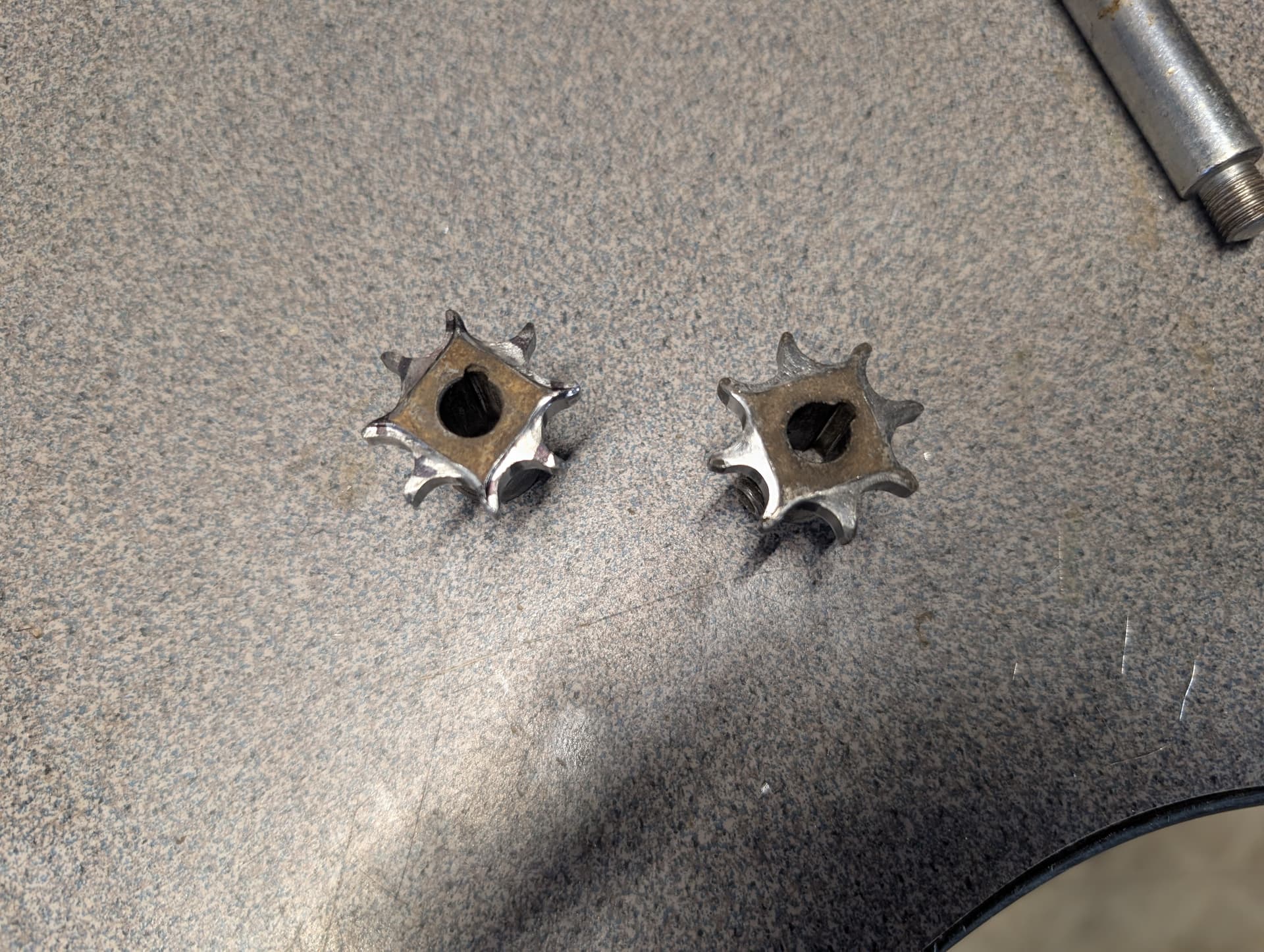

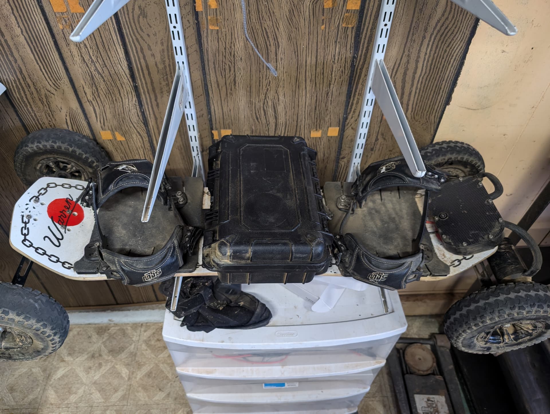

So still not able to ride, but that doesn’t mean I can’t work on the boards. Almost 6 weeks with no mountain boarding and I’m going a little stir crazy but got a big win today.
This is what caused my lockup back on 1-11 resulting in a broken elbow.

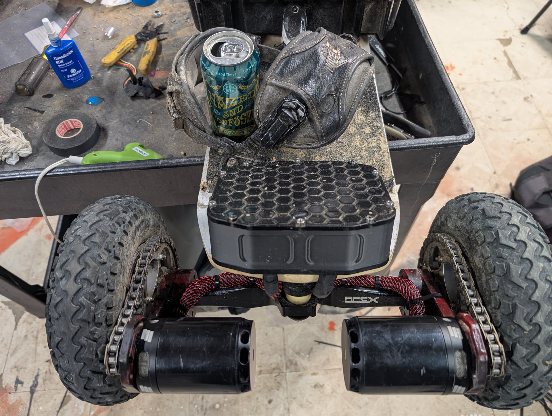

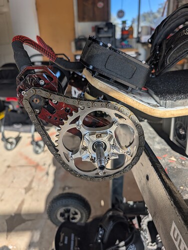

The motor sprockets were in horrible condition. I had always thought that the chain would fail before anything else so never even thought to inspect them. Lesson learned the hard way.
Luckily, @Facko is a chain drive wizard. He gave me a good chain drive education. I always thought it was just two sprockets and a chain, and while it is, designing a system that wears properly takes a lot more than that. I won’t go into too much detail but a lot of math goes into it and a properly designed setup considers how many rotations it takes for the same chain link to land on the same tooth on the sprocket, proper distance between sprockets and the right amount of links to make all of this happen.
To get a properly designed system, I had to get longer mounts and opted to go with a set from @IDEA . They allowed for correct spacing between sprockets.
My favorite part of the Apex chain drive was the push fit adapters. After being spoiled like that I did not want to go back to having a sprocket mounted to my hubs. Working with Facko, a few measurements and test 3d prints later and we had a new sprocket that would mount to the Apex adapters. He has this design now so anyone else needing replacement sprockets for the Apex push fits should be able to hit him up.
The new ratio is 4.8. We could have gotten to 5 but it would have sacrificed longevity of the drive. I was already overheating the 6485 motors with the previous reduction and @Skyart offered me a good deal on some lightly used 6495s at 140kv. Hoping the lower KV and larger motors will generate less heat.
I also found the stomp pad STL file for the DWII deck that @Regular_Michael posted so decided to ditch the Trampa wings and print a new set. Much better fit, thanks dude.

She’s ready to go.

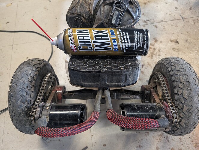

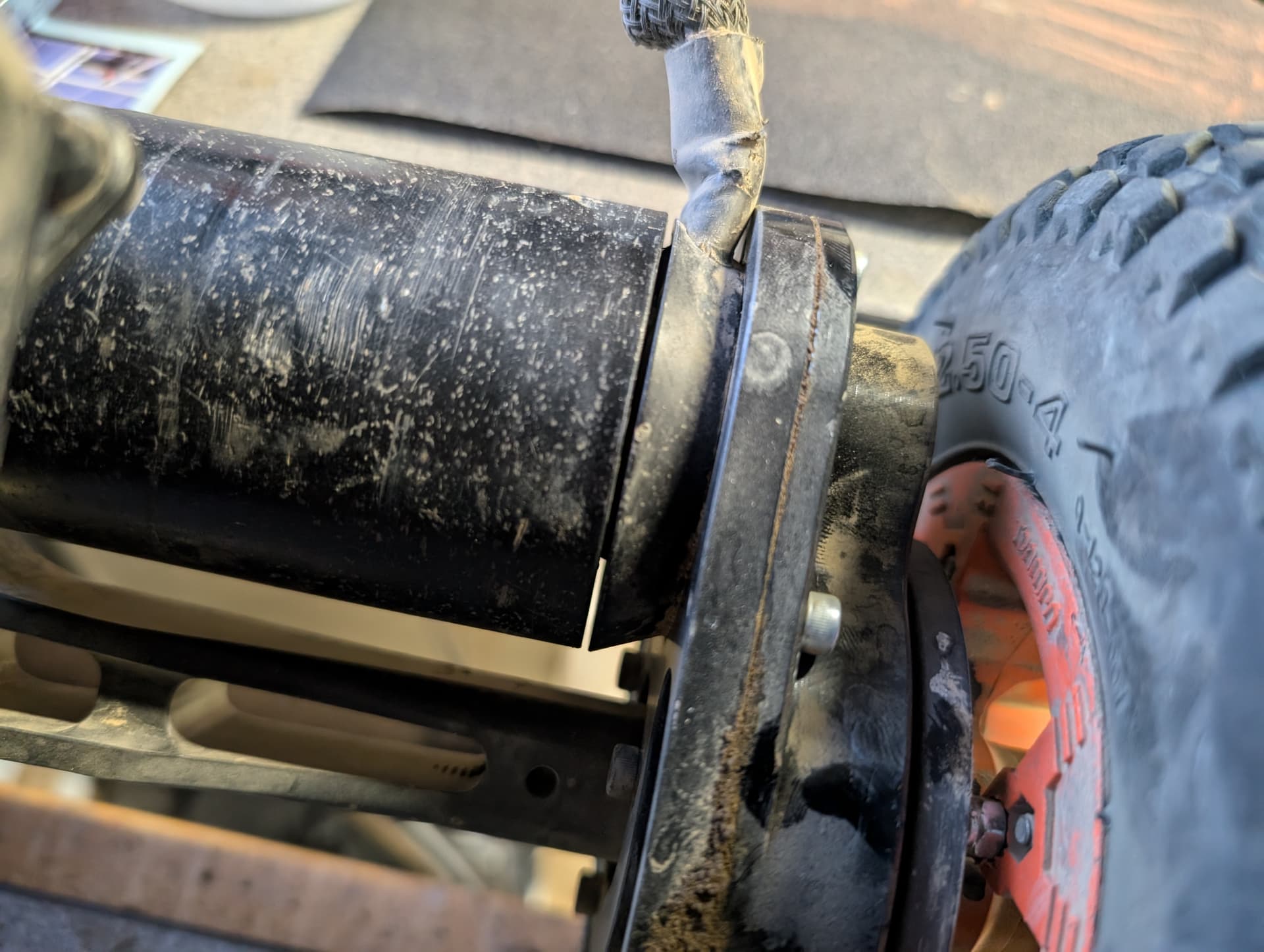

Quick PSA for those of you using chain drives. Got out for a quick run today. We’ve had a decent amount of rain the past couple days so the trail was tore up and a little muddy in some sections. In the past I’ve always used either wet or dry chain lube but decided to try out this chain wax. Even in good riding conditions I’ve never finished a ride with the chains looking this clean. They still have a waxy lubricated feel too. Would suggest trying it out of you haven’t already.

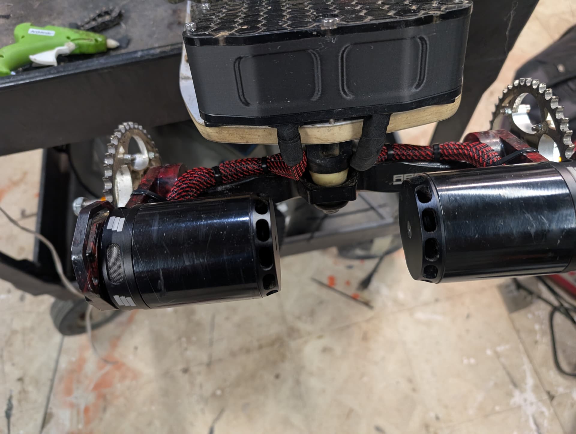

In an attempt to chase down a failed hall sensor, I had one motor on the bench. Unfortunately all of the conductors were fine so the issue is probably in the motor can. Waaay too lazy to open it up and troubleshoot so HFI on one side it is!
One good outcome from this, I saw @glyphiks mention his dislike for motor leads running free air to the ESC enclosure and that they should instead be secured to the top of the hanger. Not sure why I had never thought of routing them this way. The photo above from the last post reminds me of McDonald’s arches. It looked like shit and you guys should have told me :wink:.
Decided to pull the other side off and reroute everything. No more McChaindrive. It looks a lot better. There were some scratches and dings from rocks even on the top side of the hanger where the leads are now mounted but I think two layers of PLA braided sleeve should protect the cables well enough. Time will tell but for now very happy with the new look!
