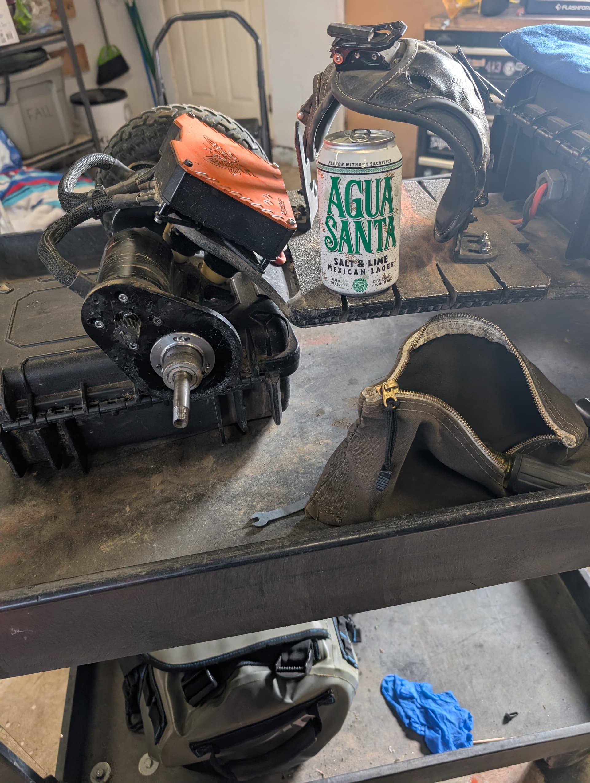

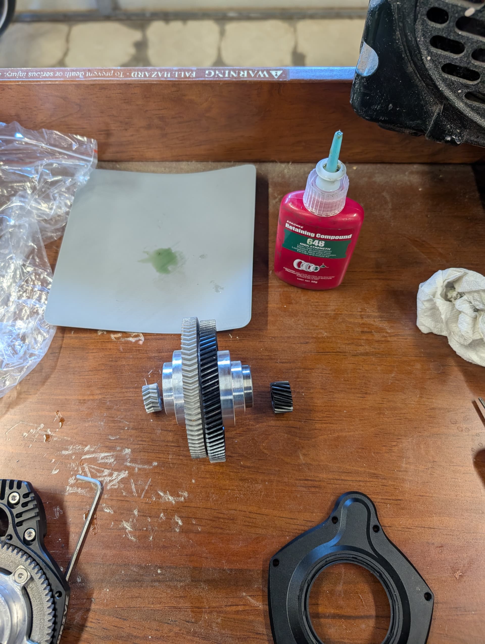

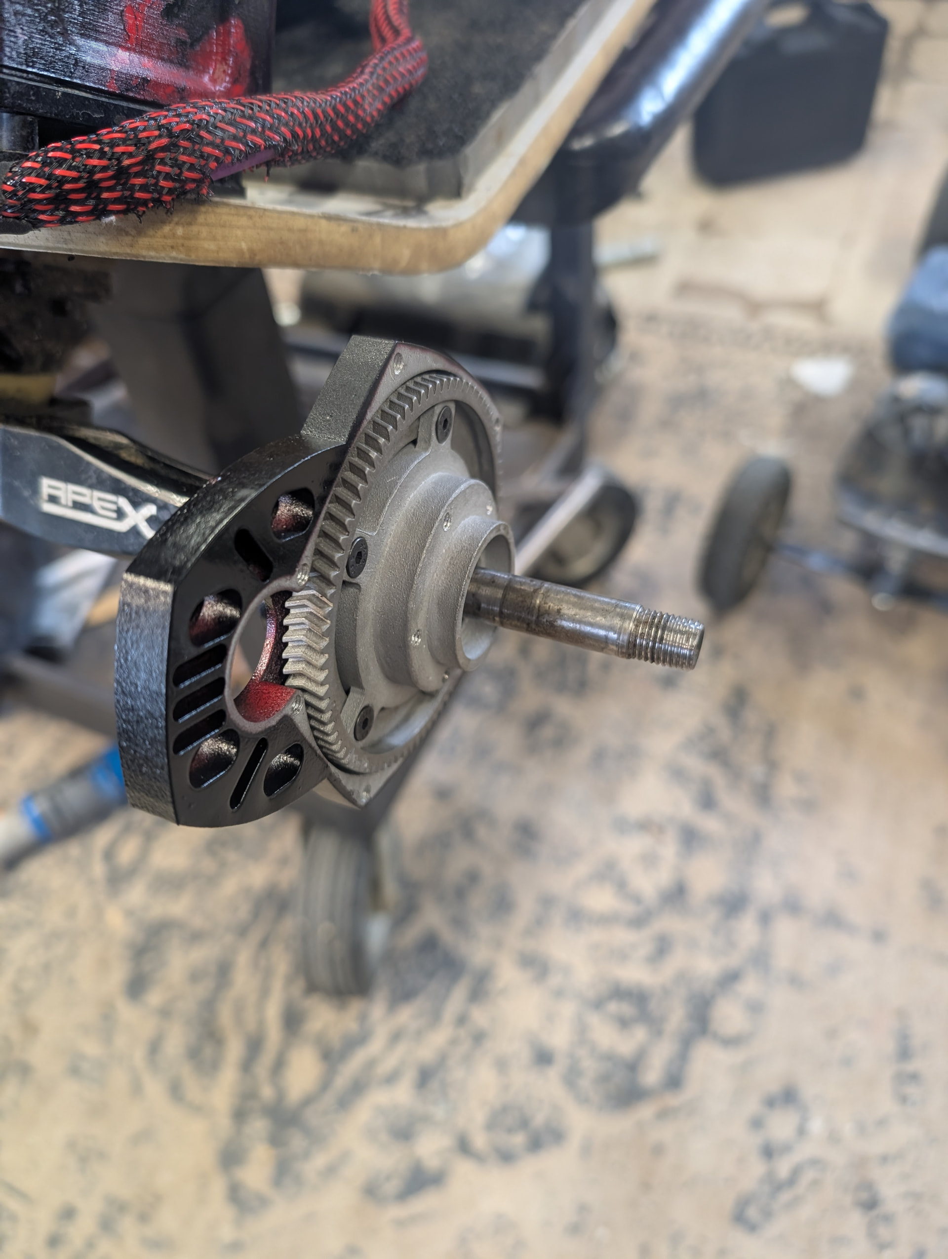

Last time I took this board out the retaining compound on the motor pinion failed and disengaged with the driven gear. It was field repairable enough to finish the ride, but it happens more often than I want to deal with so decided that a life of cleaning motor shafts and pinions and re-applying retaining compound just isn’t for me.
Good bye helicals! Into the bag until I can figure out your purpose in life.

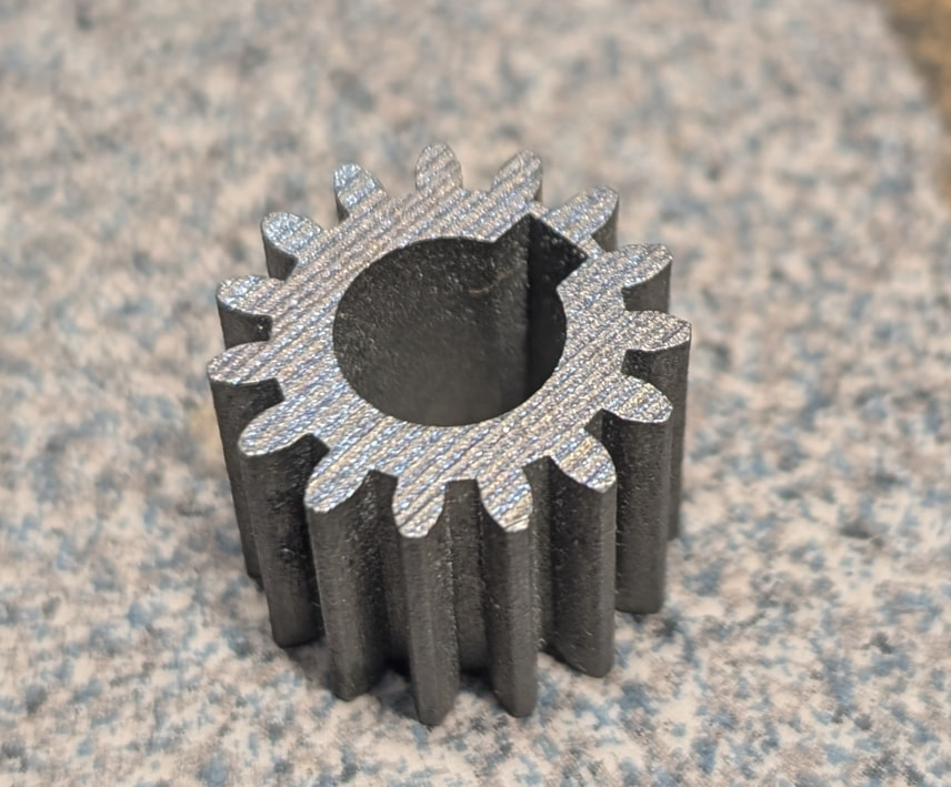

I picked up these Jump Drives from another forum member a few months ago. Been hesitant to use them because they’re probably the last pair I’ll get my hands on. Also the helical thing was still an issue without Apex motors. Slightly less of an issue since the helical gears are directional on the Jump Drives but failures can still happen.
So far, the SLM printed gears on the other build have been holding up great. Definitely still in the testing stage but they’ve taken some abuse and are still running strong. My confidence in the technology is growing so decided to make a SLM printed herringbone gear set for the Jump Drive.

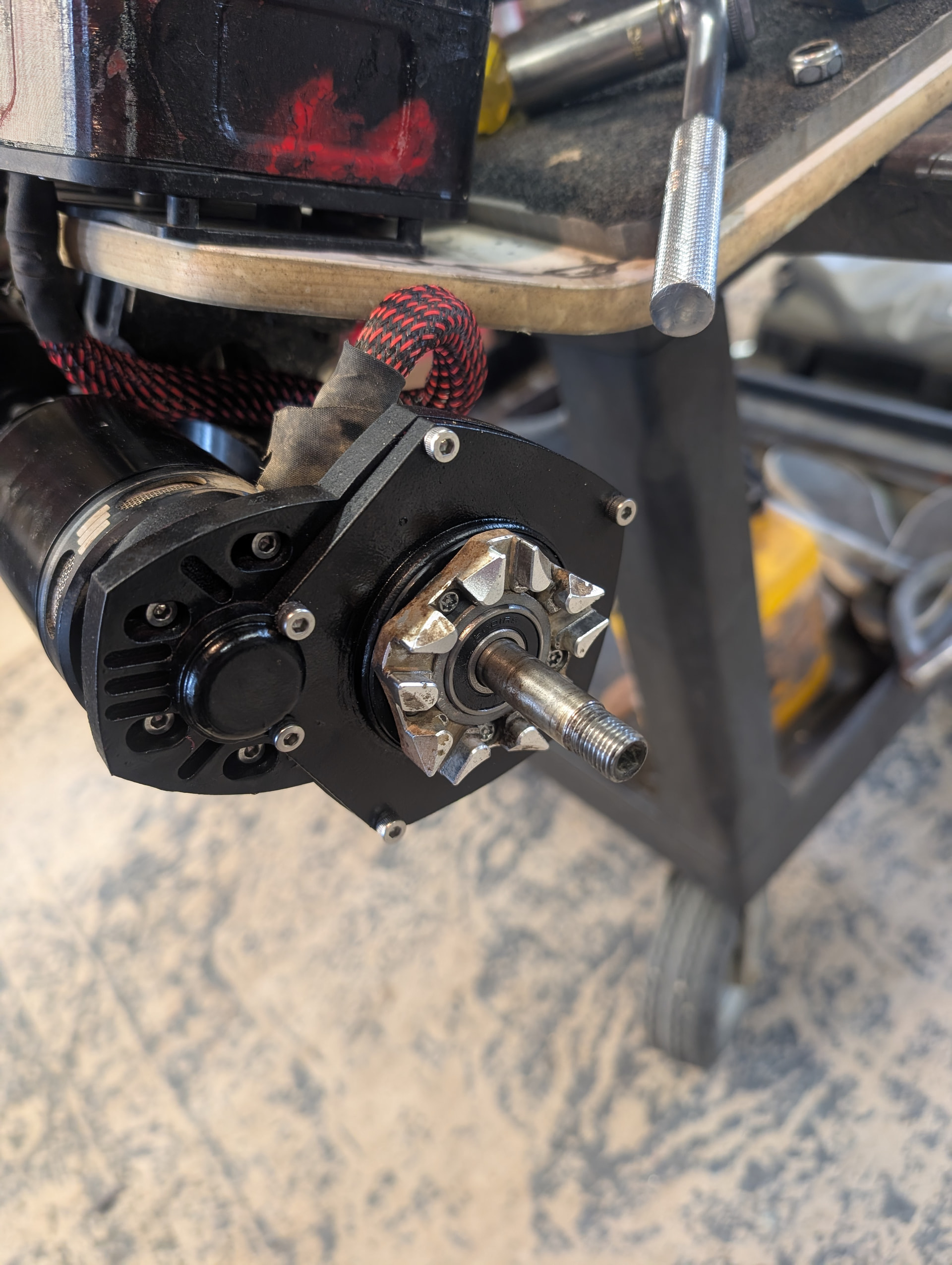

This set is printed with a stronger grade of stainless than the set that’s on the Double Agent Build. They’re 17-4ph with a rating of 1150-1300mpa as opposed to the last set of 316l at 590-700mpa. Hoping this is a win because it’s a relatively cheap upgrade that could make these drives more reliable when using non Apex motors. Everything seems to mesh well. Here’s a quick video of bench testing the free spin. I’ll try to get it out this weekend for some real testing.

Finally got a chance to test these retrofit herringbone SLM gears in the Jump Drives today. 19 mile run, about 50-50 asphalt and rocky hard packed dirt. They definitely exceeded my expectations.
The free roll is much better than the complete SLM “Beer Drive” system that I designed. Guessing this is due to the rotary shaft seal in the Jump Drives vs the TPU seal in the Beer Drives. Going to have to change things up on the other board to accept a rotary seal. Using 17-4ph stainless instead of 316l probably helped too. The surface of the gears is much cleaner.
Hoping some of you will start experimenting with SLM. It’s already being used in more demanding applications and is pretty damn cheap for a small batch, especially when you consider what machined herringbone gears would cost. I’ll keep trying to break these things in both boards but knock on wood, so far they’ve handled everything I’ve thrown at them.

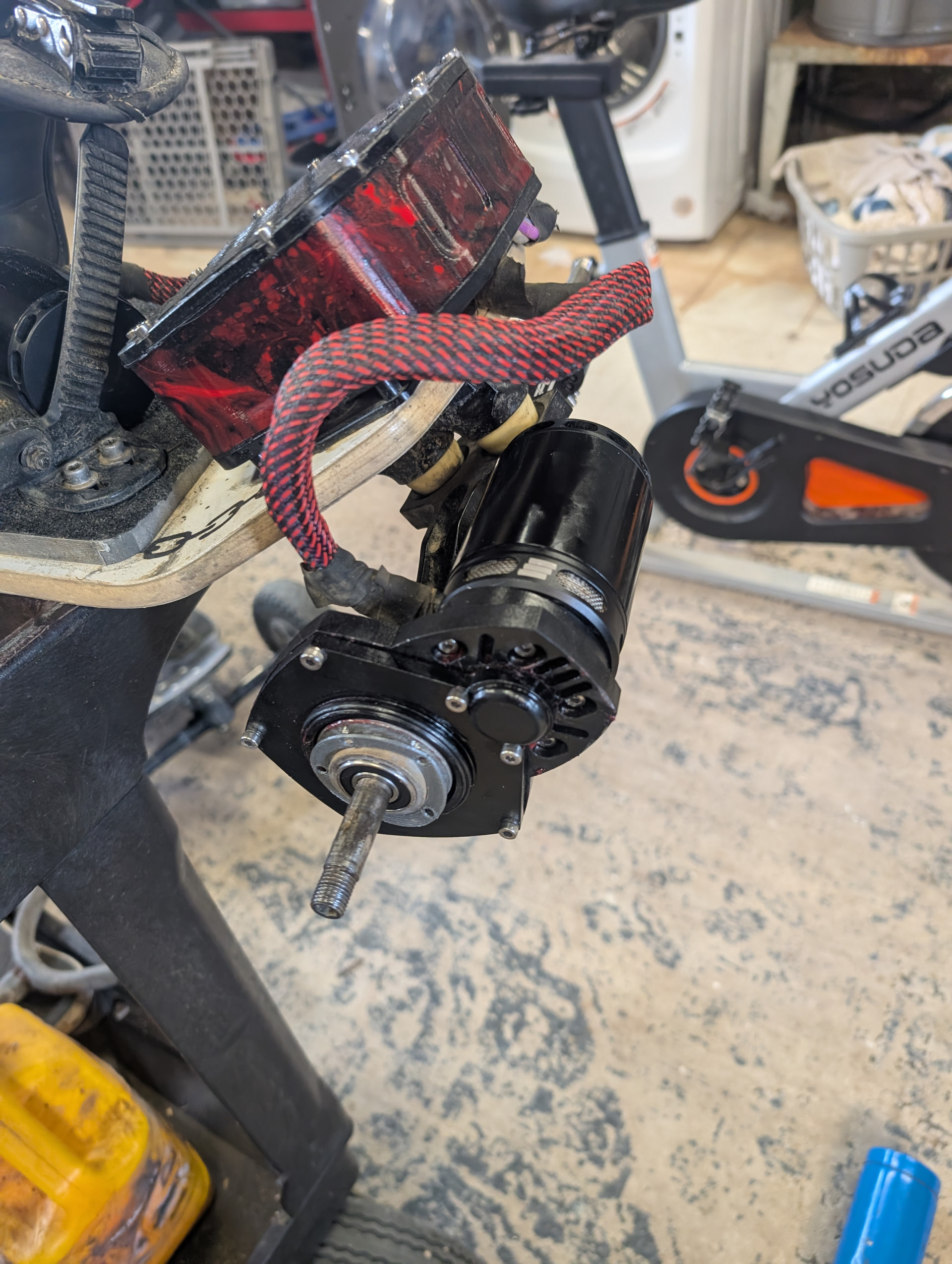

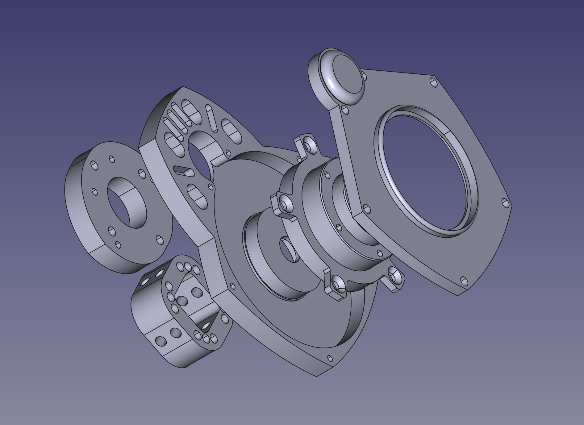

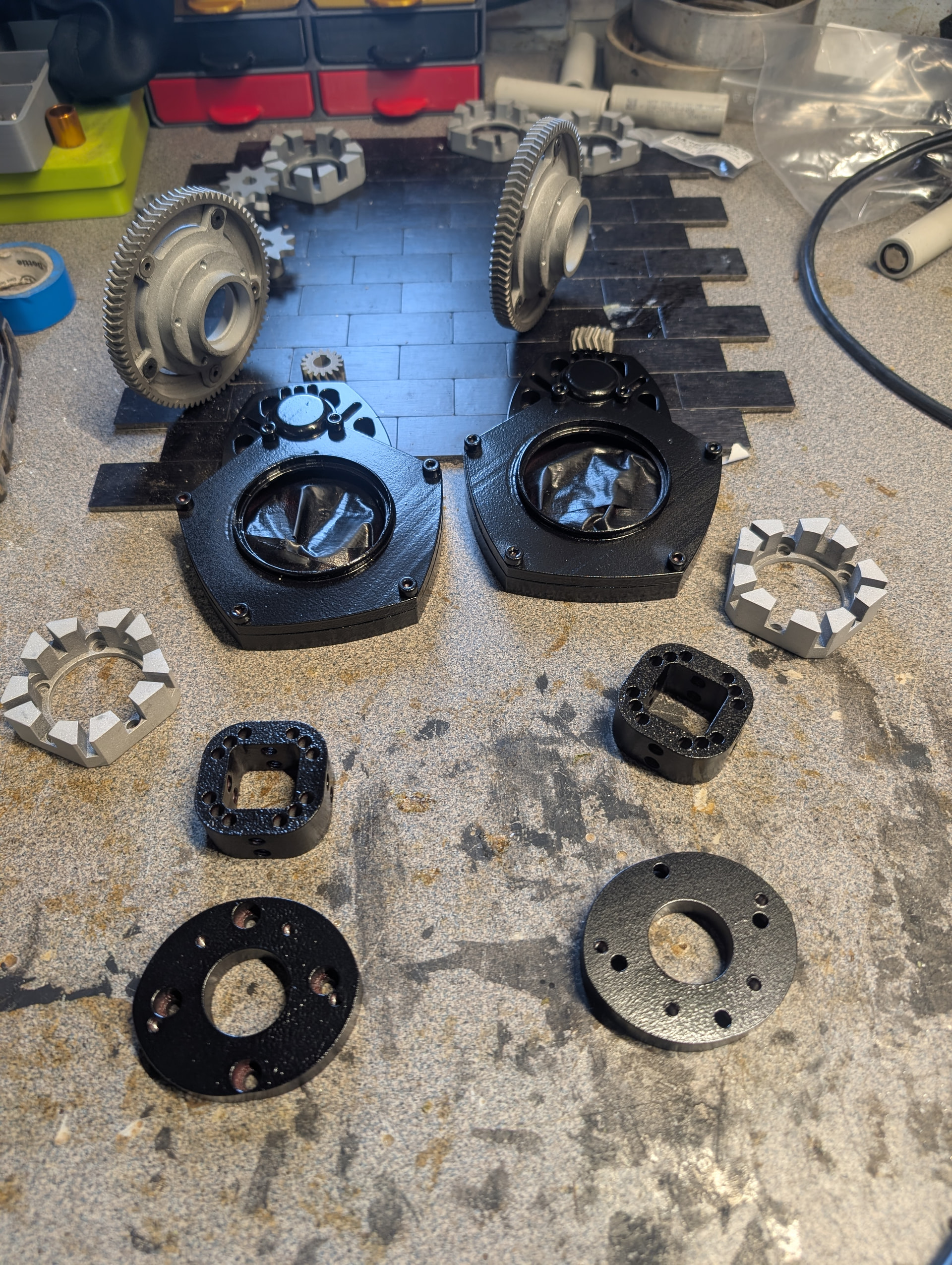

New gear drive time! I’m finally getting around to installing what should be the final version of these SLM herringbone mountain board gear drives, dubbed Beer Drives. I’ll make a post about them eventually but until all of my thoughts are organized they’ll live here. Quick note, order and use at your own risk. I have run two previous versions of this drive without issue. This is the final design with QOL and cost saving improvements.
The goal of this project is to have a reliable herringbone gear drive without proprietary parts. Replacement parts can be ordered from Craftcloud or any other SLM manufacturing service. Cost of production is cheap when comparing to small production runs of CNC parts (or at least any I could find.)
These are extremely DIY… You’ll be doing a lot of tapping. You might want to do something about the raw aluminum parts finish. These aren’t quick to put together but depending on what you want out of a gear drive, the juice may be worth the squeeze.
Drive Information
  • The gears are mod 1.1 herringbone at a ratio of 16:80. Any mod is achievable without special tooling using SLM production.
  • Truck clamps are set up for 22 x 22mm hanger. The truck clamp file could be edited to fit 20x20.
  • Hub push fit adapters can be chosen for MBS Rockstar II XL or Trampa Phatladz.
  • A 17t pinion has been added to the files section per great advice from @Dinnye. Using it should ensure more even wear across the teeth over time. I have not tested it yet but will soon.

You’ll need high quality M4 taps and drill bits for the M300 miraging steel gears.
Threads in aluminum can be made with lower quality taps.
Always run the appropriate size drill bit before tapping. The manufactured holes are a little tight.
Tap tap tap. You’re going to be doing a lot of tapping.
Use green Loctite 648 or stronger on bolts securing the gear adapter to the gear threads.
Permatex red 27140 or equivalent for grub screws in truck adapter to hanger. Same for bolts that pass through truck adapter and thread into back of gear housing.
Blue stuff for all other hardware
You will likely need to file the bore of your motor pinions. A chainsaw file works great for this. Run a precision file through the motor pinion keyway opening to remove rough surfaces and get rid of excess material. SLM openings print a little smaller so don’t be surprised if you’re filing for awhile. It’s better than printing an opening that’s too loose.
SLM surfaces have a slightly rough surface. This includes your gear teeth. Don’t worry! Run the gears for awhile and they’ll break in. You could probably use lapping compound but it really isn’t necessary.

The gears are mod 1.1 herringbone. Yes, 1.1. No special tooling is needed to produce these so you can do what you want with the teeth. The extra .1 adds a little strength.
Choose M300 Maraging steel for gears. It’s the strongest material available. I still have gears made with 17-4 ph stainless that have been running great for almost a year. M300 is an even better choice so pay the slight extra cost.

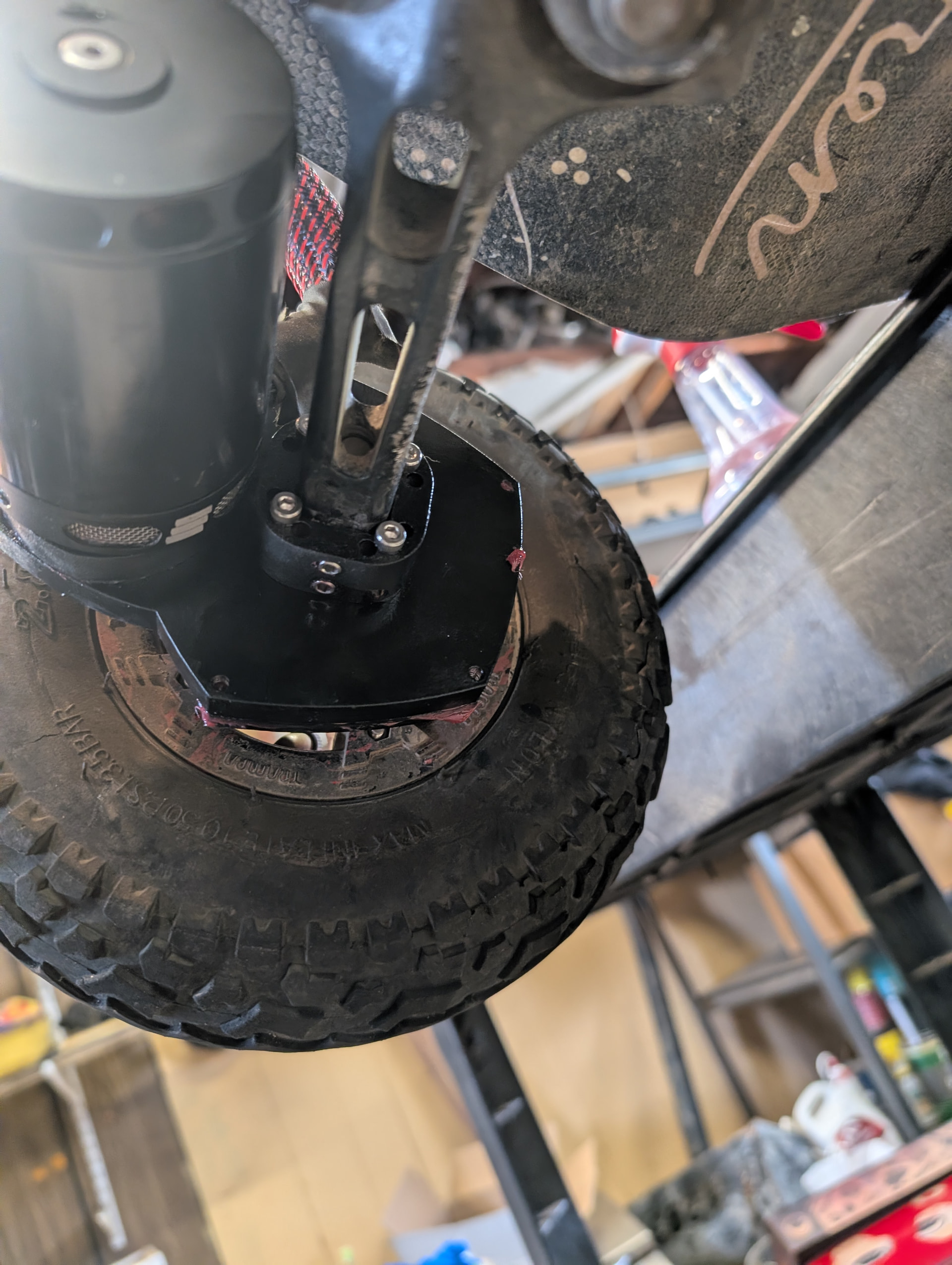

Yes they do. The goal was to make something that used their push fit adapter design, along with their rotary shaft seal. I also picked their same basic housing shape of a pentagon with a riser. It’s not an exact match but it’s really damn close. Same goes for the gear adapter. I experimented with other shapes but the one they already came up with really is the best solution for connecting the push fit adapter to the driven gear. The similarities are obvious.

How is wear on the ones you’ve been running for a while? And how much torque does the board have that it’s on? I kinda want to try using SLM for my double stage drive.
How many sets do you have out in the wild so far?

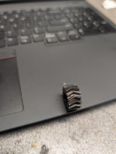

No fatigue related failures like cracking or such with any SLM gears?
There’s a set of these gears installed in a Jump Drive on one of the boards. Same modulus of 1.1 and same tooth count at 16:80. The metal used for them is 17-4ph stainless which isn’t as strong as M300 maraging steel. Here’s a photo of the pinion. No damage that I can see.

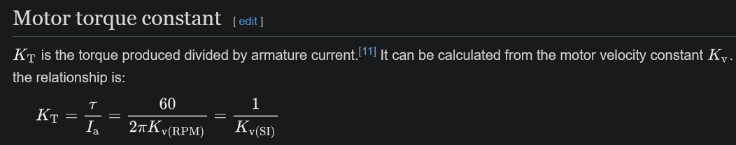

Not sure how to figure out how much torque. It’s on 173kv 6395 reachers with an 18s battery. Motor amps are set to 100 if that helps.

From wikipedia:
Your motors have a torque constant of 0.055. At 100 phase amps, that’s 5.5N-m. For a M1.1 16T gear, that’s an average tooth force of 630N.
So you’re saying I need to up the amps…
evil-smile-jack-nicholson
I was mistaken, they were actually at 120a. Either way though, I’m not sure what that torque value really means. How is 630N compared to other drives?
