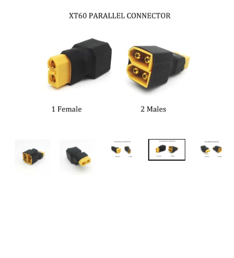

Can run 2 Battery Packs with BMS in parallel
Looking for words of wisdom if this is going to be ok to do.
I am working on a little mountain board build and can’t drop the cash on a real battery for now.
So I want to use the 2 Meepo ER batteries I have in Parallel.
They are each 10S2P 40T Packs, with Charge/Discharge BMS. 30 amps maximum discharge.
I plan on connecting them in parallel going into a Focbox Unity.
All good?
Yeah that’s good, just make sure they are the same voltage when you plug them into each other. I think you can wire the charge port in parallel but I’m not 100% sure
I was planning on keeping the charging ports separate on each battery.
keep us posted. I’m not sure if charging them individually while the mains outputs are connected in parallel will have undesired effects.
Well… that makes me nervous… would it be best to connect the charging ports in parallel?
Didn’t @anorak234 do something like this with a bunch of old hoverboard batteries?
@Jacobee They were 10s2p packs Meepo-style with BMSs in each. I supplied charge current to each BMS through a massive parallel adapter so I could use one charger for everything. 10s12p and it worked quite well.
I did something like that time ago. I used to charge both packs individually. I never had problems at all.
What about 2 packs in series?
I did that too. No problems.
I mean if you charge them together, like 2 10s packs with 2 10s bmses charging at 20s voltage
I did this on my board. You can check out the process here ( Evolve GTX 2nd battery in parallel ). I have sense removed all evolve electronics and am running a unity.
2 years ago I did the same thing with the crappy 10s2p samsung 22p batteries.
I definitely recommend wiring the charge port in parallel. The connector is a JST-RCY.
I have a similar setup with 2 meepo batteries and 5 one wheel style batteries for a 10s14p set up everything is connected in parralel and I use one of the meepo battery charge ports, the entire battery charges fine with a 5amp charger. Because everything is connected in parralel voltage remains the same in the entire circuit. Does not matter if you connect 2 or 3 or 5 ports in parallel. Everything will charge at the same rate. I guess one advantage would be less heating, but you should have any heating at 5 amps charge rate
