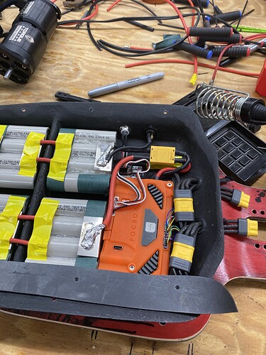

Thiccc gasket?
Looks like its gonna need it :frowning:
How thick? I would try using a 3mm gasket to start off with. Once all the hardware is bolted in with the gasket those gaps will be eliminated I would assume.

I also made a gasket
I had the same issue and a 3MM gasket seems to do it.

I couldn’t leave the 10awg wires on top of the batteries at the end of my pack without the deck laying on them before the enclosure touched the deck. Also the xt90 couldn’t be on top of the unity without the same problem.
