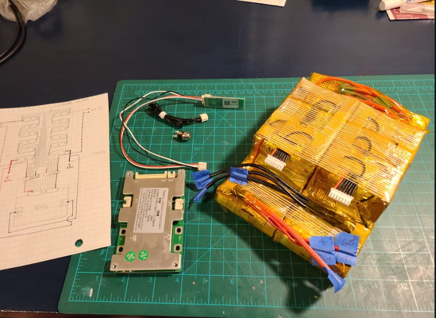

Before starting on the 2nd half of the pack I decided to do some more fine tuning of the spot welder and did some pull tests. Apparently it’s having a hard time properly welding the 0.15mm strips on the A123 positive ends. I can’t get consistent results to pass the pull test.
I did the same tests before starting on the 1st half of the pack but I think I only did with the negative ends which work much better with these strips. I think it’s a different metal (the positive ends for A123s are the same as the whole cell case), the negative ends seem different, more “shiny” if this is a clue.
Dammit. Now I don’t know what to do… I’d so not want to take the finished pack apart but I also can’t be 100% sure that all the welds are fine. I’d even more so would like to not have to get a different welder. Fusing strips to strips and strips to the A123 negative ends works great, doesn’t even need to be on the highest power setting…
Any tips here? Anything in particular I’d need to do to prep the A123 surface before welding? I did lightly sand but doesn’t seem to help…
Yes, the wrapped pack is coming apart. I cut out just one section of a positive end and the strip popped right off with just a bit of nudge. Dammit. I might have better luck with some 0.12 nickel strip I have… might do that and stack a few layers on the main ends.

ok, everyone’s naked again. Going to start over.
It was weird, almost all positive end strips came off easily and most of the negative ends were stuck ok. Either way, better to clean all of them off and re-do properly.
What does nickel like more, shiny smooth surface or rough sanded one?
No reason to rough it up for spot welding, only for soldering.
I think the roll of nickel strip I used initially was crap.
This time I used the 0.15 one that came with the welder a while ago and it stuck on much easier. For now all the parallel pairs are connected, going to make the series connections tomorrow.

I ended up stacking 3 layers for the series connections. For the main leads I welded one end of a stack of 3 strips, soldered the wires and then welded each layer one by one to the first/last cell groups.
Happy to be done with this pack, especially with having half of it basically re-built. What should’ve taken one afternoon, ended up a 4 day quest.
Everything seems in order so far but the conclusion will be tomorrow when we connect the BMS for the first time.
Also, it fits in the box but it’s a bit more tight than I would’ve liked. Not going to print another one, but there’s no more room for foam tape or any sort of vibration insulation in there.

It’s alive!
The BMS app connected right away, no issues there. It does have a lot of settings so I’ll need to do some research. Not sure what I need to set up in there so it does what I need - balance.
Is there a way to set it to balance the cells all the time, not just while charging? Should it do that?
It did ask about the pack capacity on the first start up, which with my 12s2p setup should be 30Ah (198Wh).
This is what it shows. Not sure why different colors for cells and I haven’t connected the charge port yet to see how that works.

I think I didn’t connect something with the BMS. It won’t charge. I just connected the main battery + and the C- from the BMS tot the charge port and nothing happens… hmmm…
It should work, on all the drawings this is what I saw, C- and pack + to the charge port.
Is there a setting to change to enable charging? It’s the boosted 43.2v brick I’m trying to use. It does output that.
is your charge port open in the app?
good question, how do I find that? This is the android app I’m using, I read that some settings might be missing from here
Edit: you mean the “charging” button slider on the main dashboard? Yes, it’s green, should be on, see the screenshot above… or there’s another setting?
