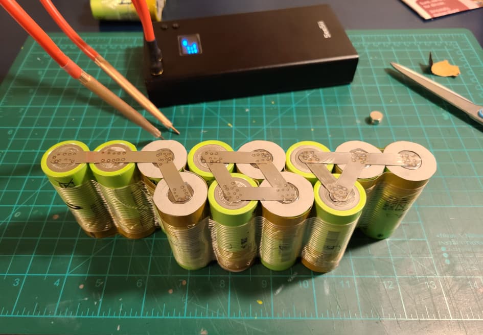

2nd half is glued together, we’re almost ready to start welding

Not the prettiest welds but I think they’ll hold. Taking this part slowly, I really don’t want to short anything…
If it all goes well, maybe we’ll finish up the pack tomorrow. 2nd cell section, wrap and leads are still left to do.
This is not going to win any beauty contests, that’s for sure.

I welded extra tabs for the balance leads, everything will be on the top, I don’t have room for wires on the sides, where the welds are. Even on the top I don’t have that much room, I wanted to leave some space for foam tape to insulate the pack from vibrations… might get too tight.
This is how I ended up connecting the main leads. Should be enough, I won’t pull more than let’s say 40A total. It’s 0.15x8mm nickel strip (the welder can’t handle more than this). I soldered the strips first to the wires, cleaned them up and welded them over the existing strip which connects the parallel cells.
If anything here looks completely wrong, please stop me.
I know, I could’ve found a way to not cross the balance leads, but I wanted to stick to my initial plan of two individual 6S packs making up the 12S. This way I’ll have two 6S balance leads.
We might run into a bit of space issue, I might have designed the box a bit too tight, I hadn’t considered that I need to route wires on top of the cells. We’ll burn that bridge later…
All connections are good, voltage reads are as expected.
Yes, I intentionally left the balance lead so short, it’ll make sense once it’s all in the enclosure.
