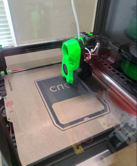

Before leaving I did get to spend a bit more time on the case… I sort of started from scratch, didn’t like the previous design and some measurements were off. I know, I’m overthinking it, it’s a simple enclosure that needs to hold the pack. I can’t help it but we’re almost ready to print. We’re going to have a small top hatch for easy reach of the charge and balance leads to be able to charge it up with an external balance charger when needed (until the BMS arrives).
Only question left before tidying it up and printing it, is where to put the loop key connector. It will likely be somewhere in the front of the enclosure but not sure yet. It need to be easily accessible but away from potential snags while riding…
Oh yeah, one more thing… is there any “alternative” similar to fishpaper? I don’t think any retailers have this nearby and I’d like to get started on the pack sooner that I could get some delievered.
Is having the loopkey plug towards the front a really bad idea?
I would’ve liked a different place, not to have the loopkey peppered with rocks or random stuff from the ground while riding but I really can’t find another suitable spot. I do want to keep it on the battery case, not on the vesc end.
That’s it, I’m done. I’ve spent way more time with this box than needed. The loopkey socket will stay in the front and we have a charge port mount too. The bottom will have a slight curve to match the board profile. It’s all drawn up with the idea of printing in one piece, with the “top” of the box on the print bed, without any supports. On a quick look it will take about 12 hours for the main part plus some more for the lids.

Mean time, finally we started printing the box. Fingers crossed it works out, we’ll see in about 10 hours:

The box is coming along nicely, quite a few more hours to go. In the mean time I started cleaning up the cells from the original pack and I’ll start prepping them for the new layout. I’ll post some pics later.

:partying_face: we have a battery case!
In hindsight, I would’ve probably designed a few parts differently, suited better for printing. Some of the overhangs aren’t perfect but it won’t be noticeable.
