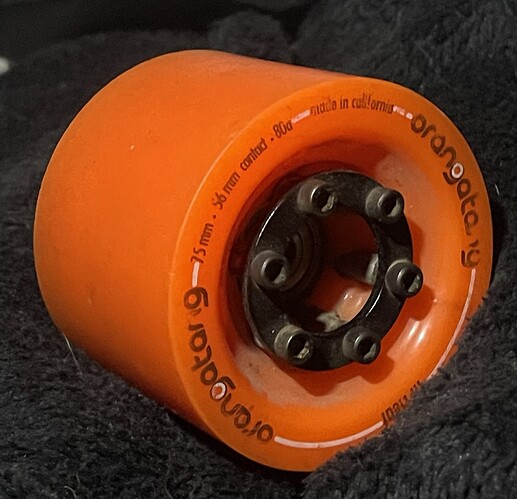

I’ll send you a v1 wheel with pulley if you post pics with fish paper between cells and bms.
:laughing: Deal!
I do need to get some fish paper though… was planning to anyway.
I only have one, pm address.
