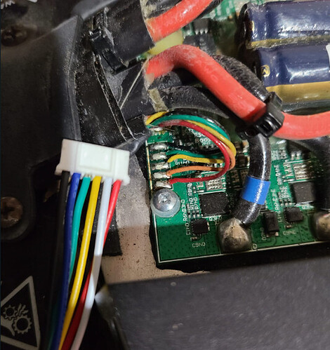

Has anyone seen the original boosted v1 sensor wires pinout?
Trying to figure out how am I going to make these connections. Boosted motor sensors have 5 wires and the leads which came with the DV6 have 6 wires. Also colors don’t quite match up. Is there a way to tell?
Those old motors likely don’t have a temperature sensor wire, but that’s about as much help as I can provide… anyone else have ideas?
Well, white is the temperature wire for the DV6 so we can ignore that. Red and black will be +5 and GND for sure.
I guess I can just try to match H1 H2 H3 from DV6 to orange, yellow, green from the boosted motors.
What could happen if I don’t get the correct sensor wires order? Is there a way to tell from vesc tool if the sensors are connected correctly?
@b264 this seems like something you’d know
The white is usually the temp sensor, you can just pull the pin out of the jst connector and it will work fine. Orange yellow green to blue yellow green- order shouldn’t matter as much as orientation. They are just the position sensors on the motor and motor detection should straighten it all out
