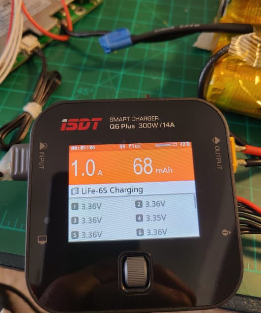

Strangest thing… one cell group started getting charged faster and faster until it reached the overcharge limit protection and the BMS stopped charging. Good to know that works, but why the hecc did it do this. Haven’t touched it, didn’t even go near the thing for the past 30 mins…
check if you didnt forget welds on a cell in that group maybe?
It’s definitely not pure nickel, that is iron oxide imho and would explain why it welds better too as the steel has a higher resistance and therefore gets hotter at the same settings than the 99% nickel. I would re test the suspect strip but prep a little differently so make sure it is just a lower percentage and not plated. Take a piece and lay it over an edge and use a file or sander to cut it in half by thinning it out - this way when it corrodes it will indicate if it has layers of different material better and you can judge it accordingly. Heavily salt the water to speed things up. Hopefully it’ll just be impure and you can just lower your vesc settings :face_with_diagonal_mouth:
This is a bad sign unfortunately, seems like one of the cells in a p group isn’t in the circuit :frowning: seems like it charged twice as fast as the others? Definitely need to check which means opening up your beautifully wrapped pack imho.

Indeed this was the obvious first conclusion but sadly it may be something else.

  • After all this I plugged the charger back in and it’s the same, the voltage on this particular p-group immediately start going up fast. Dammit!
Can one of these two cells just be …bad?
Is there anything else that could make one group charge so fast?

It could be one of the cells is bad but it just seems unlikely to me but I don’t know exactly why - just a hunch that it’s the nickel. Take the nickel off one side before disassembling the whole pack and check voltage again. Do you have any way to test the cell internal resistance? A known resistor and a multimeter that uses a 9v battery for power is better than one that only uses Aaa batteries.
You could charge/discharge the suspect p group cells individually and that would let you know if one or both of those cells is an outlier. I have to do discharge testing capacity and IR on all my cells before they go into a pack now because i use used/repurposed cells for my personal setups - no other way around it I’ve found that doesn’t involve headaches/heartaches lol
Good idea. I do have a smart balance charger I use with LiPos for RC stuff that measures internal IR while charging. For a quick check, I can connect it to half of the pack (it’s 6S max). I’ll do this shortly. On the other hand, this will connect through the nickel to the cells so I don’t know how relevant it will be.

Strange, it’s been charging for about 5 mins now and the voltages are still behaving.
IR also seems fine, A123 tech data shows 6mΩ and it’s close to what we’re seeing:
If it won’t start running away with this charger, could the LLT balancer be bad? I guess we can test, I can disable balancing, charge it up again with the boosted brick and monitor the cells.
No.2 is the p-group which was running fast.

I don’t know how long it took to fix the large delta, I turned on the LLT balancer last night before going to bed and by morning all the cell groups were at the same voltage. Then I hooked up this charger in the morning and it charged them all up to 3.60v.
Nothing weird this time with group #2. It charged up in line with almost all the rest.
I say almost all because now I noticed something maybe strange with group #5. It got up in line with the others up to about 3.45 and then it stayed there. When the rest of the cells were at 3.6, group #5 was still around 3.4 and then the charger slowly balanced it up to 3.6v as well. As soon as it stopped charging, group #5 pretty quickly (within a couple mins) got down to 3.50. Should this be concerning or still “within spec”?
