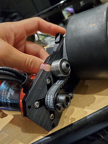

I have 2x boardnamics idler mounts on the precision hangers, 97mm ABEC 11 wheels, and the new Maytech motors from the Fiori group buy. I am trying to set up the mechanics of it and it is not quite working out. I have a 40T wheel pulley and a 14T motor pulley, the belt that I have to use for it is 320mm, which is what was suggested on the website and by several other people, however, I have run into some issues.
I cannot get the idler tight enough without crashing into the wheel. I don’t think I am doing anything wrong but it just doesn’t make sense that 320mm would be suggested as a size when even with the idler completely tightened, the belt is still almost too big. Am I just screwed here, needing to buy a shorter belt? Or should I pursue a different solution?

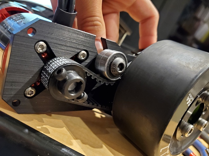

Flipping the motor pulley around doesn’t make any difference and the shaft of the motor is already too short for the pulley to grip with the allen screws, so I was going to need to loctite it anyway
Pressing the belt to almost the right tension, except the idler hits the wheel

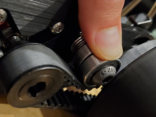

Definitely not tight in this photo either, idler crashing into wheel

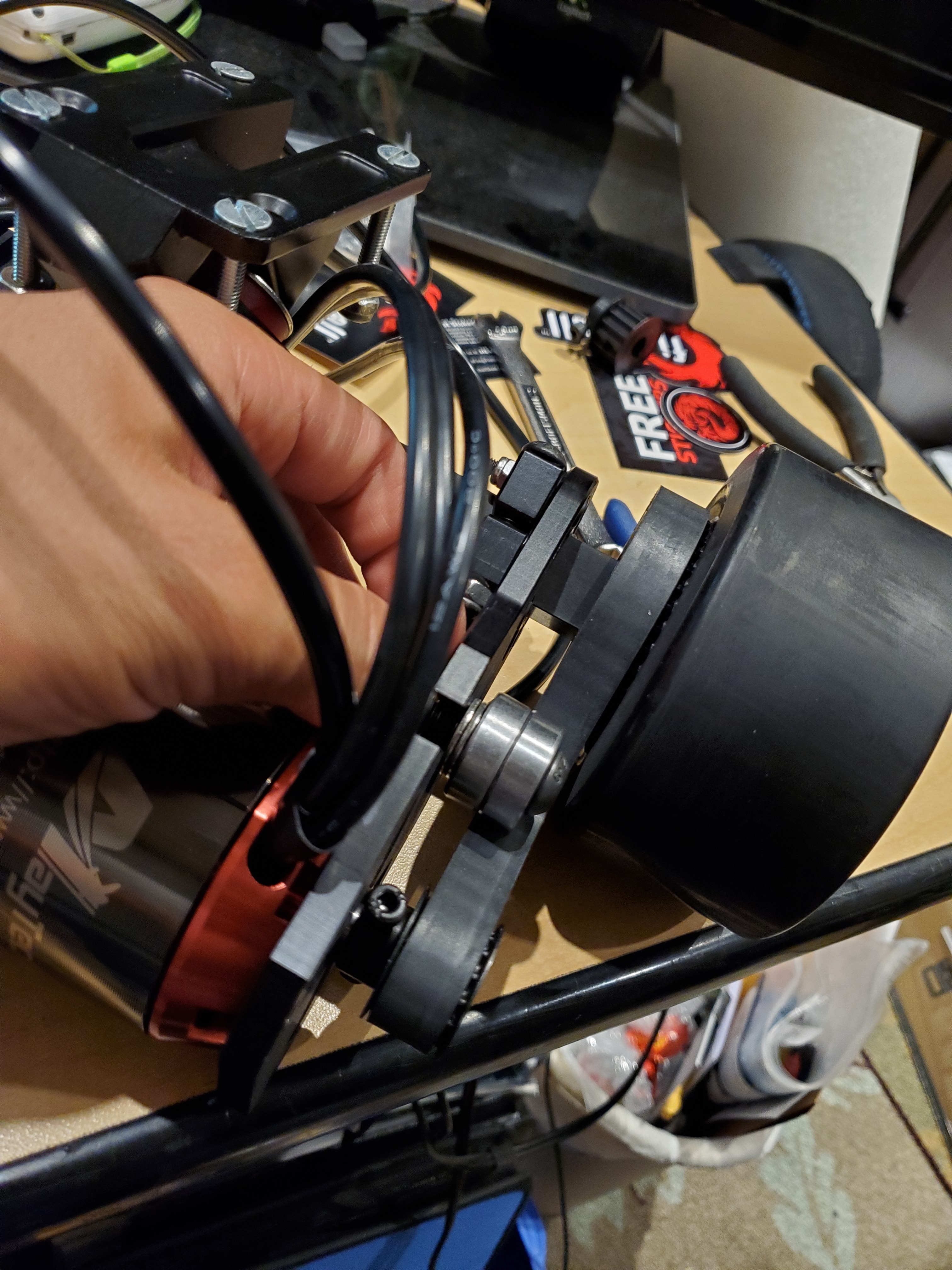

Pressing to right tension without the idler on - clear in this shot that the belt seems to be too long

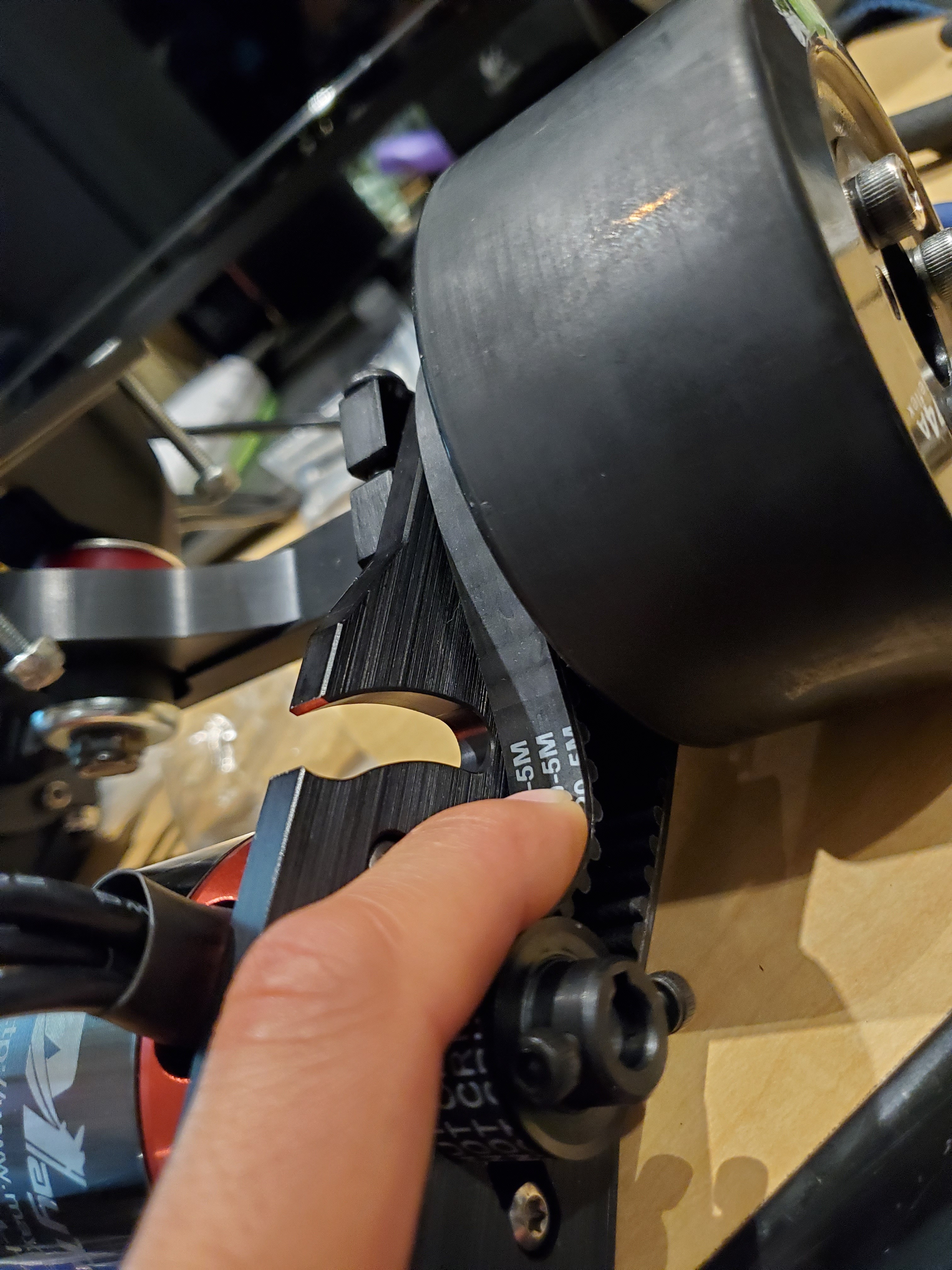

This clearly isn’t the solution either (flipping the pulley so that the allen screws grip the shaft) The overhang between the pulleys is crazy, will be shown further with the idler

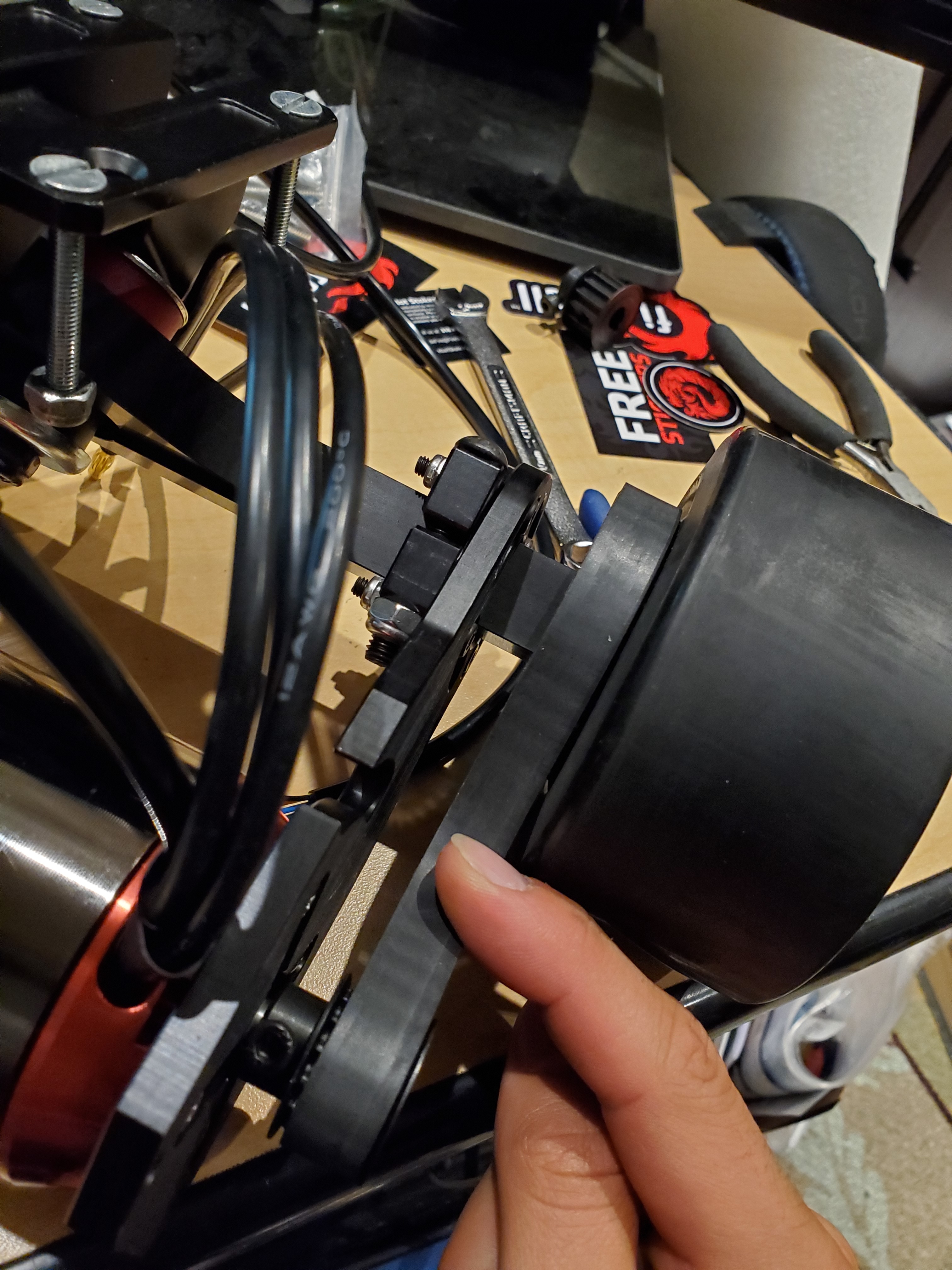

Obviously you can’t run the idler like this
Using all the washers from the other idler to put it in the right spot, still crashes into the wheel.
It really does look like the belt is too long.

You could always shave the back of the wheel a bit to clear the idler…
The belt only needs to be tight enough to not skip during acceleration/braking - any tighter just increases stress on parts. Have you tried setting the idler as tight as you can and testing it? You might be surprised how loose it can be and not skip.

320mm is for 16/36 ratio I believe
I realize that but I have 14/40, essentially the same thing. :man_shrugging:

Technically 320 would work if the wheels were smaller but with them being 97mm obviously they will take up more space
I am going to get a 305 or 300 from … well somewhere I can’t find any nearby yet
