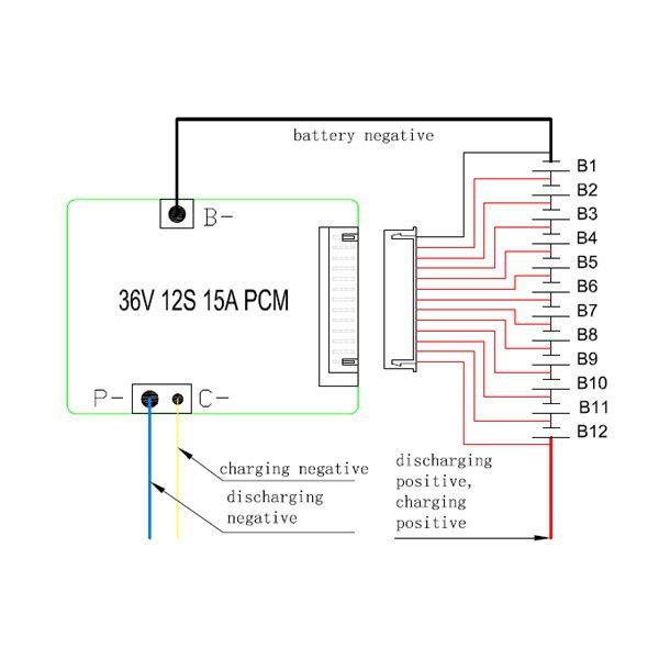

Hey guys i just picked up a 12s bms and im wanting to hook it up to my 6s lipos so i dont need to carry a lipo charger around wiht me on group rides, plug and run is what im after. i got an 8amp charger sitting around from my lion pack but i was wondering if their was anyone in melbourne who could wire up a bms with connectors for 2 6s lipo packs so i could plug and play.

The last P group on a lipo and the first P group of the next lipo are the same. so you have to skip 1 balance wire between the lipos. Does that make sense?
is that the negative wire on the first lipo
Which one? mark it on the photo.
A balance lead will have wires 1,2,3,4,5,N for its 6 wires. Where 1-5 are positive and the 6th is negative if I remember correctly

Diagram, original and edit
Thank you for this, when I get it in I’ll take some photos and re arrange to match diagram =)
Ahh so 6th and first wire go to same port thank you.

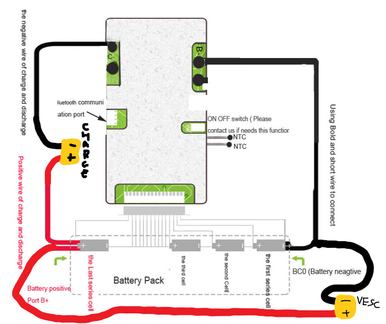

Depending on the bms the last and first wire of the 12 balancing wires may change, Check your specific bms diagram, if you are confindent go ahead, if not, post it and I can paint a specific diagram for you.
Ok thank you I will take you up on that when I get it. Don’t want to mess anything up as it can be quite dangerous
Just got bms in.
Original and edit
Thank you, I will take a closer look in the morning and see if I can make up a harness
