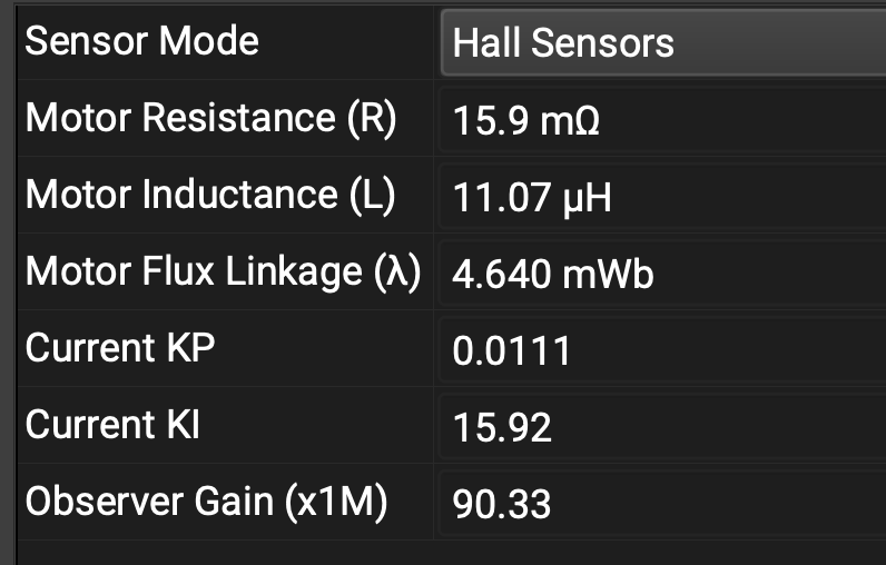

I think next I will re detect motors and see if inductance or anything else seems to have changed.
Old:
New:
Initially I got a reading of 8.?? µH for inductance. and I tried detect a few more times it seemed to narrow in on numbers around 13.?? µH
for comparison, I want to get this motor from the secondary side unhooked and check it with the inductance meter.
Also want to get that old replaced motor from the primary side hooked up to a focbox to do detection and see if it reads double the inductance via vesc_tool the way it did on the inductance meter.
