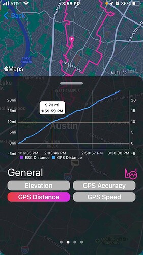

26 wh/mi, are these stock mad wheels? Did you have them inputted as 101mm or 105mm?
Stock wheels I have it inputted as 103mm. Stop and go killed my range.
Gps vs esc distance.
What do you get?
