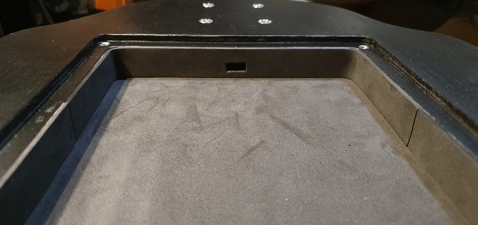

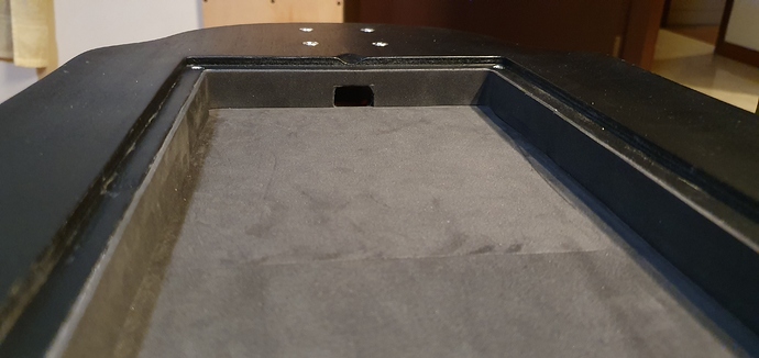

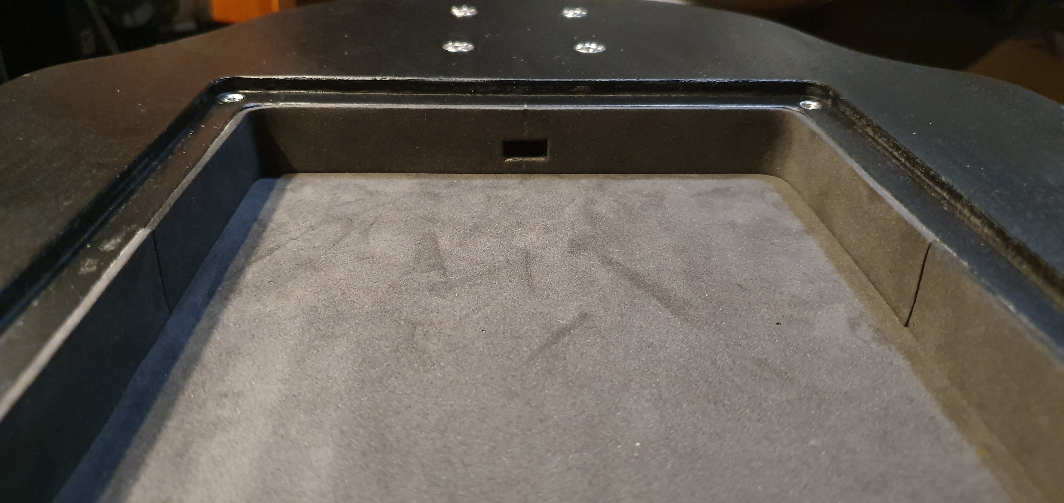

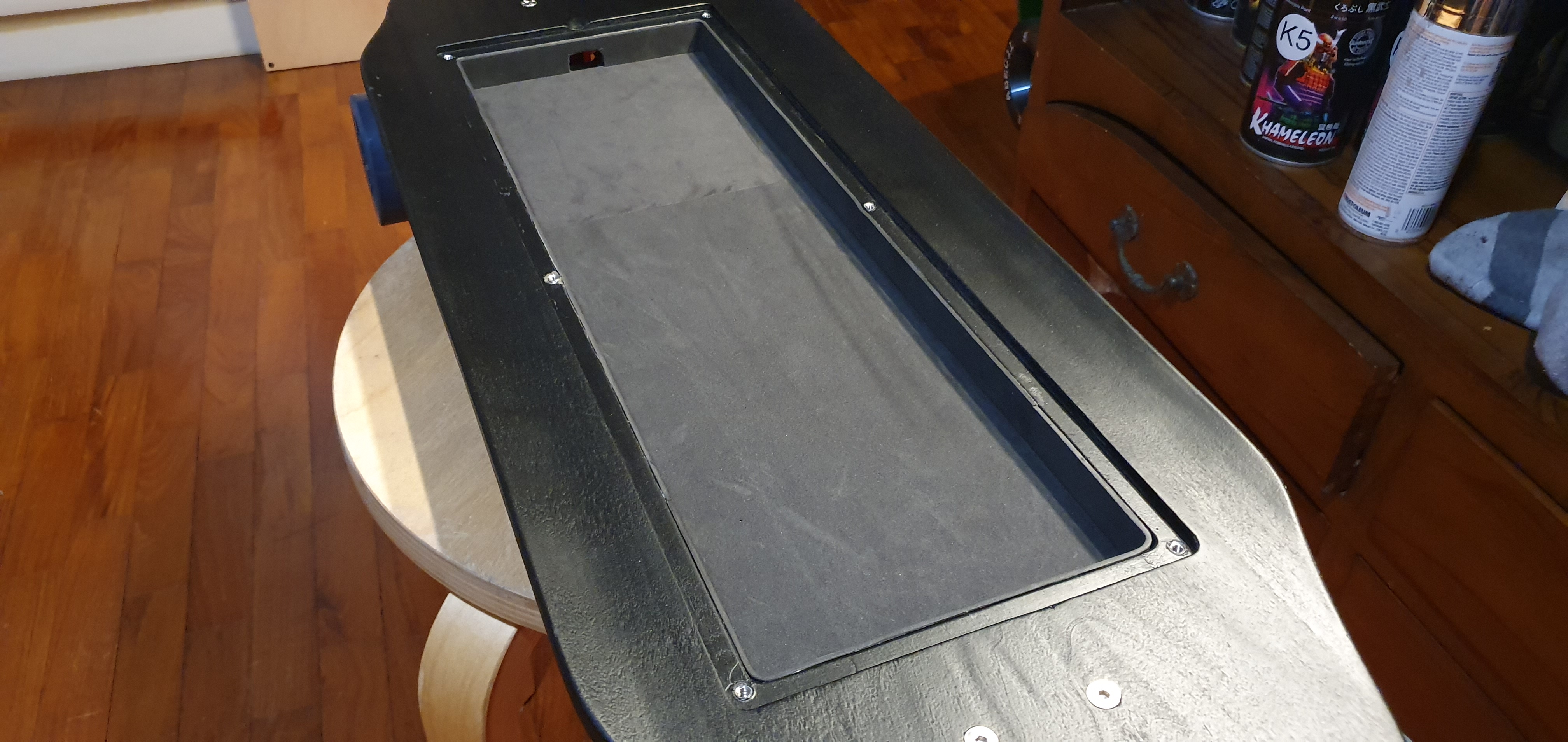

Some final touches onto the deck. Padding up the inside nicely with 1mm craft foam and some double sided tape. Also not forgetting to pad the lid as well since CF is conductive.
I made the lip on the deck to be 4mm. The CF layer is 3mm. The craft foam adds enough thickness so that when the lid is tightened down by the screws, it will sit flush with the deck.

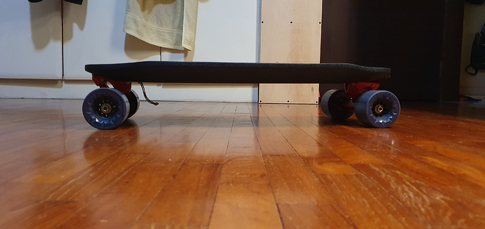

2 profile shots to show the stealthiness of the deck, if that’s a word.

Yea when i uploaded the pics i thought i loaded the wrong ones because they look like the ones i took before.
All nicely padded up now, and just gotta waaaaaaaaait.
