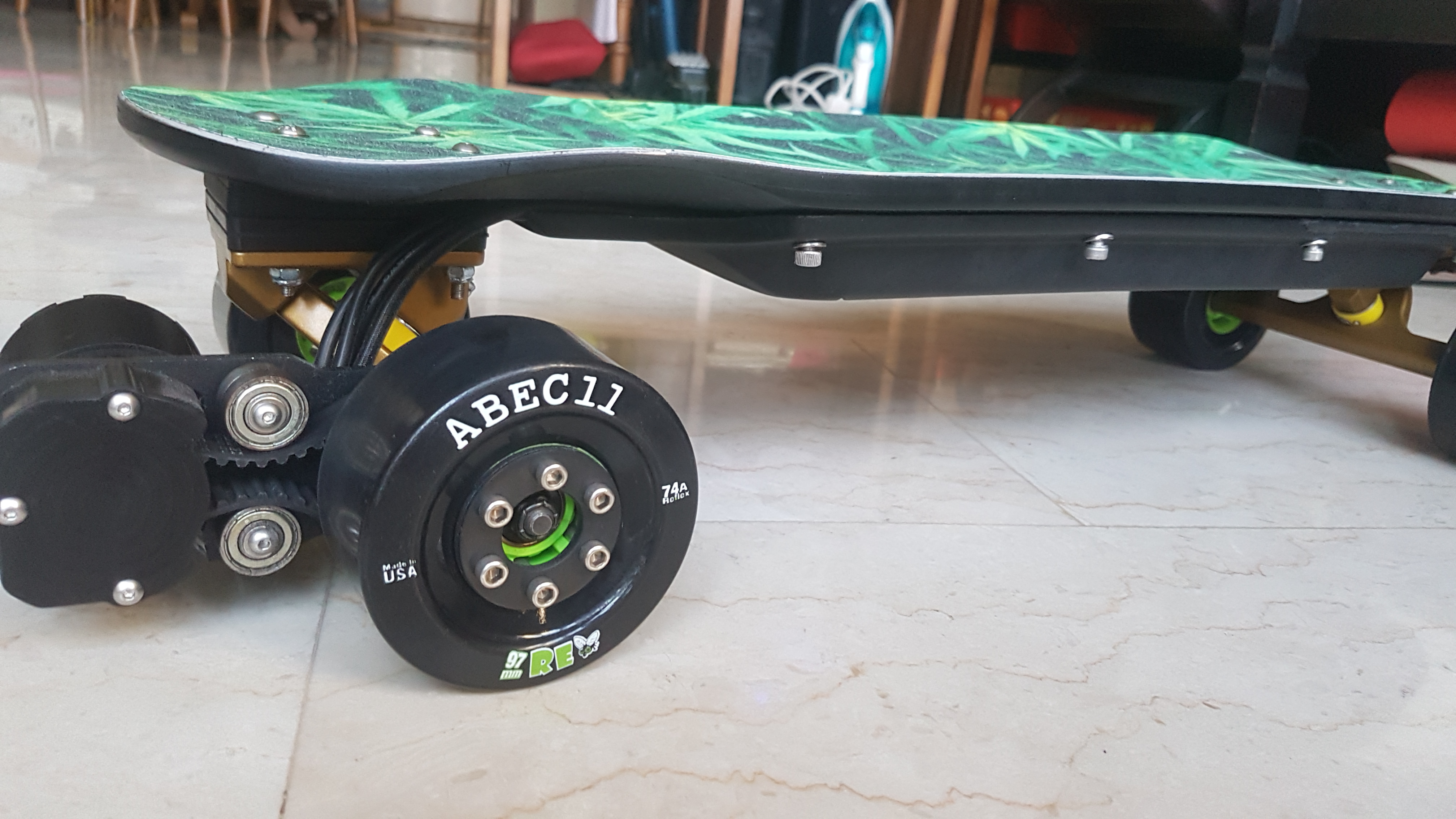

Hence, i chose the Jet spud. This measures 74cm/29", so even when mall grabbing this, it wouldn’t touch the floor. I’m also a medium sized fella so this deck is perfect.
Paired with it were gold Caliber IIs and Abec Reflys 97mm

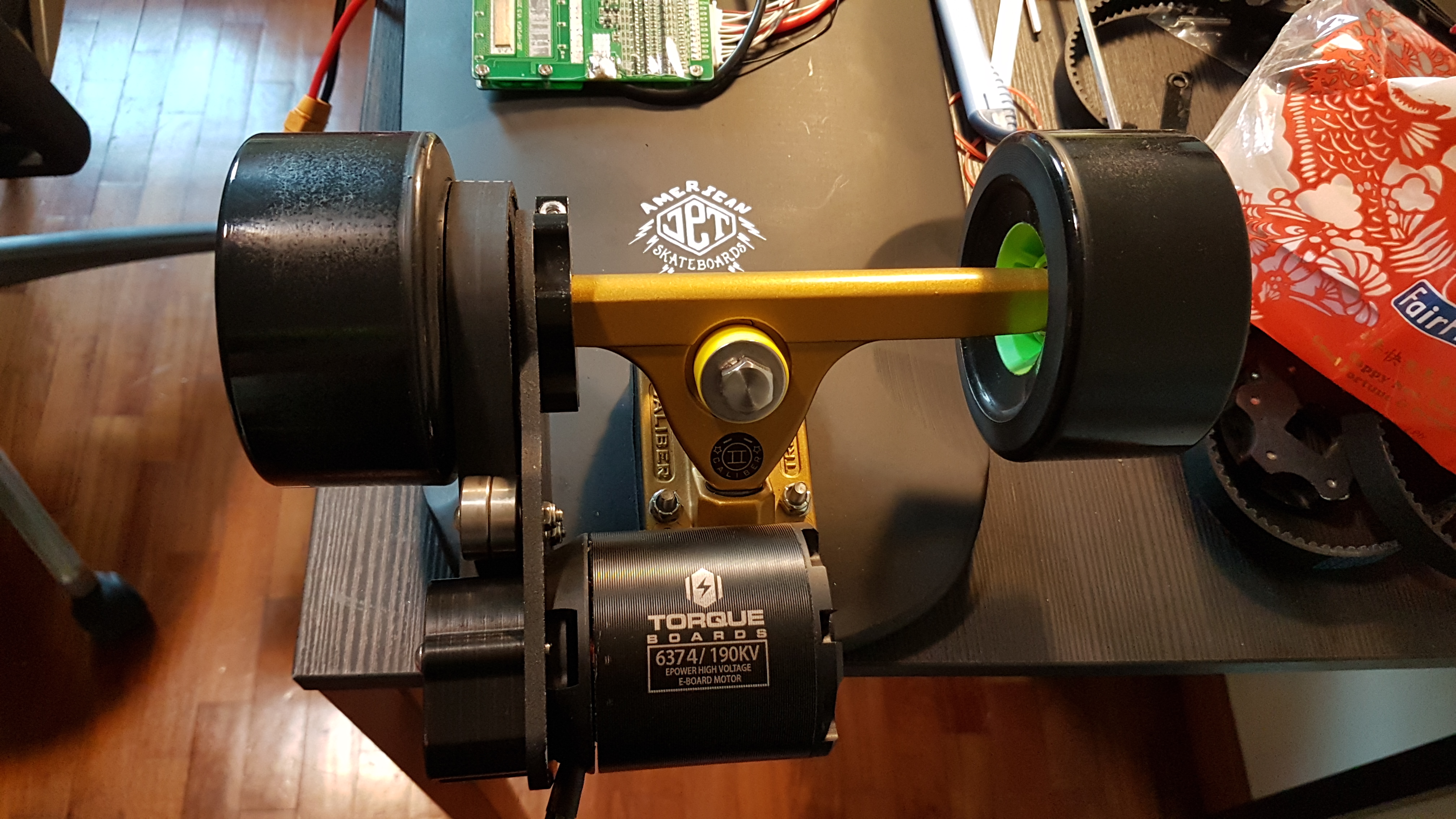

Using Janux dual idler belt drives again. Paired with it is a single Torqueboards 6374 motor.
Using a 10s3p battery and a TB VESC.
Got the @eBoosted Jet spud enclosure, it was just released at the time.
Had to reverse mount due to the long motor mount hitting the enclosure. No biggie.
And it’s done! As you can see, motor clearance is terrible.
Marc from Janux was able to cut a longer mount with a different angle for the holes so i can pivot it higher.

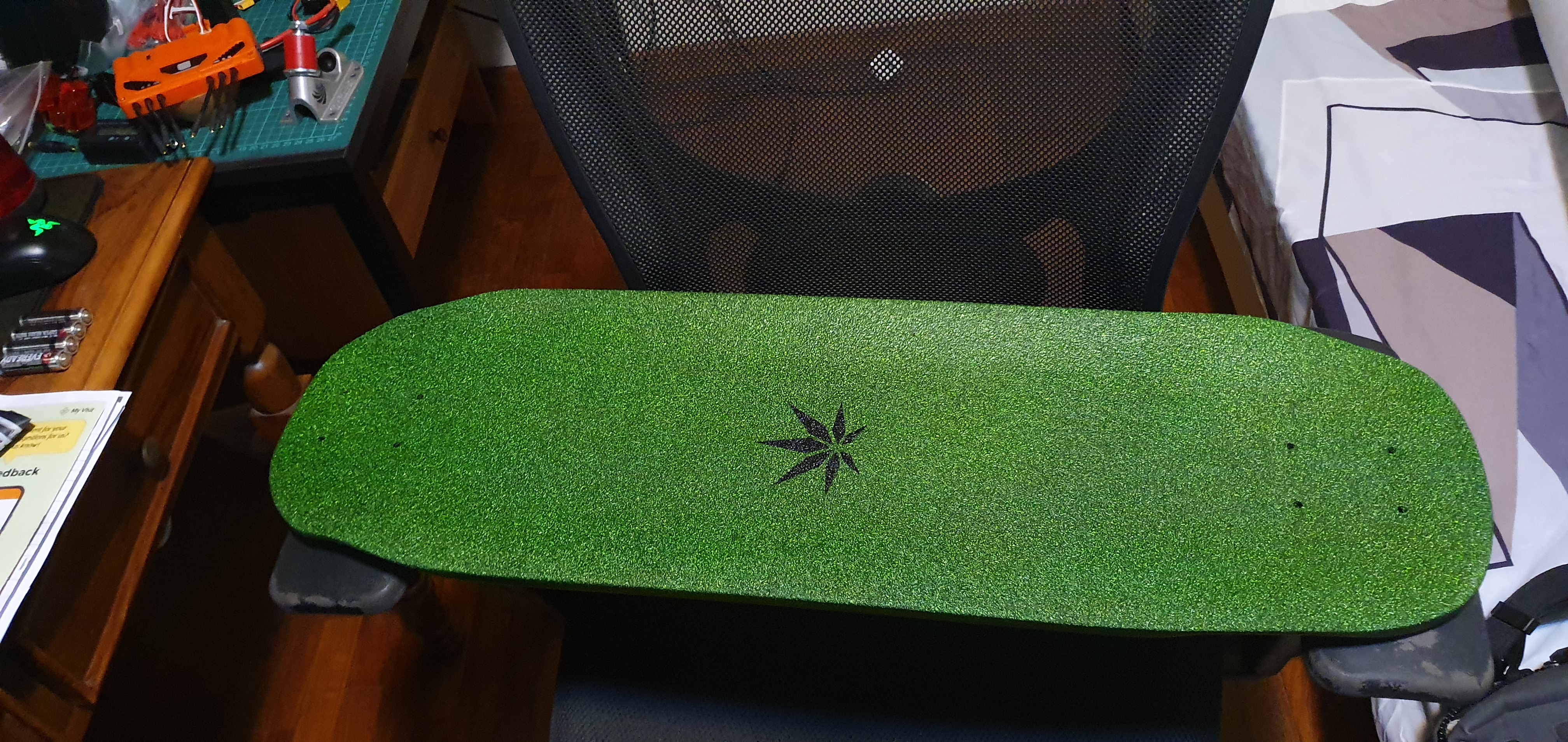

And you know that i gotta paint it.
Changed to 107mm Reflys.
Also changed some internals to make it neater and to a Flipsky 4.12
Sprayed some Truck bedliner for durability and scratch resistance. Beautiful.

First, i touched up the paint job and removed the griptape, and replaced it with truck bedliner, and then sprayed the corresponding color over it. I also sealed up the previous holes on the enclosure and placed the power switch, charge port and batt indicator on top of the enclosure instead for easy reach.

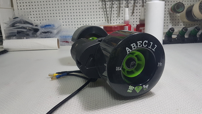

Jeff’s urethane gear drive is discontinued, so these are pretty rare. Also, it only fits trucks that are E-Caliber length or longer. @Boardnamics just released the 184mm precision trucks and the shoulder bolt is about the same length as the E-Caliber axle so i got it instead.
The gear drive mount has to be turned to a specific diameter to fit, so i did it on the lathe. Uploading: 20191213_193112.jpg…
Meanwhile, i set up the front truck first. I definitely feel the difference compared to Caliber IIs. Much more snappy and responsive, and i feel more confident going faster on it.
Comparison in truck width. The front is the Boardnamics 184mm, and the rear is still the Caliber II.
Test fitting
And with a new gearbox, the old one was beat up.

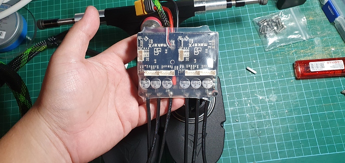

I also got the MakerX ESC. Let’s see how this fares.
Flipsky 6354s, 190kv. Almost ready to assemble.

Almost there. I got the mounts sprayed candy green to match my baseplates. It’s time to assemble!
Mounts and motors go on
Adjusting backlash
On goes the 107s, gearbox and boom! Mounted on the deck, and yep its a tunnel riser down there, routes cleanly into the enclosure since the enclosure is right where the baseplate is.
I’ve yet to solder the bullet connectors for the MakerX ESC since it’s 2:30am now so i’ll continue in the morning, run detection and all, and go for a test ride.
Hooked up the MakerX. Also I noticed that the wiring for the sensor port is flipped. I had to cut the JST connector and directly solder it to the motor sensor wire to its corresponding pinout. So yea, normal sensor wires would not work.
