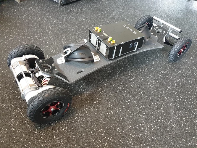

You can move a wire to disconnect the main pack, and connect an external pack. Think like one male XT90 and two female XT90 and you plug the male (ESC) into one of, but not both of, the batteries.
It’s much safer that way.
Doing it the way you’ve shown, fusing as @rusins mentioned is definitely recommended
To be honest, having an external pair of XT-90ies that connect the main battery to the ESC that would allow you to unplug the main battery and plug an external one instead would be really cool. It’s just that running packs in parallel means less load on each pack, leading to an increase in overall range than just using one, and then swapping to the other.
It certainly would be the safest, and most versatile option if you have the space for it!
This is true, but that’s a lot of safety risk for this gain. I guess it depends how hard you’re running the packs and what their current capabilities are.
Considering I have some pretty strict space constraints I’m not sure I’ll have enough room to fit 2 more xt90s in the enclosure, one panel mounted is already pushing it.
Gonna definitely fuse both packs just in case.
I do like the idea of a “select a pack” pair of xt90s though. That way technically you wouldn’t have to worry about packs being the same voltage ever, and would also be able to have multiple smaller packs that you can swap externally if the inner one is depleted.
Do I personally ever see this use case coming up? Possibly? If I am gonna be riding further then I will most likely plan ahead but it would help with the more on the fly instances where you don’t expect to need the range and would need time to charge both packs.
Now that I type it out I do like that idea better honestly. I still want to find a way to remove the human error, because you would still have to worry about disconnecting the internal pack before connecting the external.
I do have some ideas though…

You could always do Trampa style and have an XT90 jumper outside the enclosure.
Here is the idea:
Let me know what you guys think. I think with some slight modification of the captured loopkey design it would work very well.
Is the external battery removable, or simply in a separate enclosure, but fixed?
Removable, was planning on making a separate battery box for the second one that would be strapped to the top of the other when needed.
You’re way overthinking this.
Ditch the loopkey entirely. Have a male
XT90 come out of the enclosure on short 12AWG wires, which runs the ESC(s). Have a female XT90S plug in the side of the enclosure which is the main battery. Plug that together to turn it on. OR, strap another battery to it, and plug the ESC into the strapped on battery’s female XT90S.
So that would just be the main battery leads hanging out of some holes in the enclosure that you would just plug into the male XT90? Then swap to the other battery when needed? I understand that this is technically simpler but if I go with the above design then everything will be low profile to the enclosure which is a goal of mine. I also just like the idea of a slider to switch between batteries.
No, more like this
Except different, and only one of those jumpers, and it’s attached at one end, and can’t be removed. And probably dyed black instead of vomit beige.
And not one of those horrible enclosures pictured here.

You could have two loop key receptacles, one for each battery. Only carry one loop key, and that way, you can only power off one battery at a time, and it only takes a couple seconds to switch.
That way, they’re in parallel and only one can be connected at a time.
