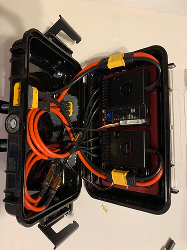

Does anyone have any tips on easy ways to make sure your phase wire holes are in a good place on the ESC enclosure? I already have the cable gaskets needed for it but I’m not sure where to start on deciding where the wires should come out from.
Here is my current progress complete with temporary hot glue that will be replaced with a suitable epoxy before actually using it.
I bought a variety set of the gaskets so I can either put multiple phase wires through one or have each wire with its own gasket.
Pelican 1200 for sure. I have a battery made by the @TheRef and it has a stormcore 60D with heatsink mounted up top, smart BMS, and 12S7P Lishen 2170LA.
I find individual holes to be a bit cleaner if you have the space, my preferred method is to have the wires fold at least once when the enclosure is closed since it’s more forgiving of changes in length
This works pretty well, only issue is there isn’t space to plug in a USB without removing the ESCs or the heatsink
What connector is that with the 3 wires? I have some similar ones but they’re way too small for the new motors. It looks easier to access the ESC/ put the enclosure on the board by using that extra section of wire too.
Luckily the heat sink is easy to remove from the controller but I’m going to have a hard time getting the phase wires from the motor to reach my enclosure :weary:
For phase leads? MR60 (3.5mm bullet row/flat connector) or MT60 (3.5mm bullet triangle connector) for most motors, there’s a MR30 and MT30 for smaller motors
MT60 > MR60
MT is only good if the phase leads are long enough to be bundled, routing MR is so much neater

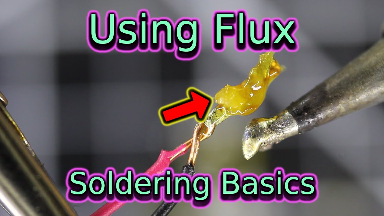

One of my battery wires keeps coming off. Soldered it 2 times now, applied force and it’s a good solder. When checking again after some weeks it’s fucked. Any tips on how to solder this mofo? Terminals are exposed in the pic, after I’m done soldering I always use electrical tape and gorilla tape on top.
Scratch the surface with sandpaper before soldering. Tin both sides, then stick together.
Needs more flux or a good rosin core solder to stick.
Take it off, wick up the old solder, then use some flux and put new solder down on the nickel. Then solder the wire to that.
Check out the difference between no flux and flux in this video:
