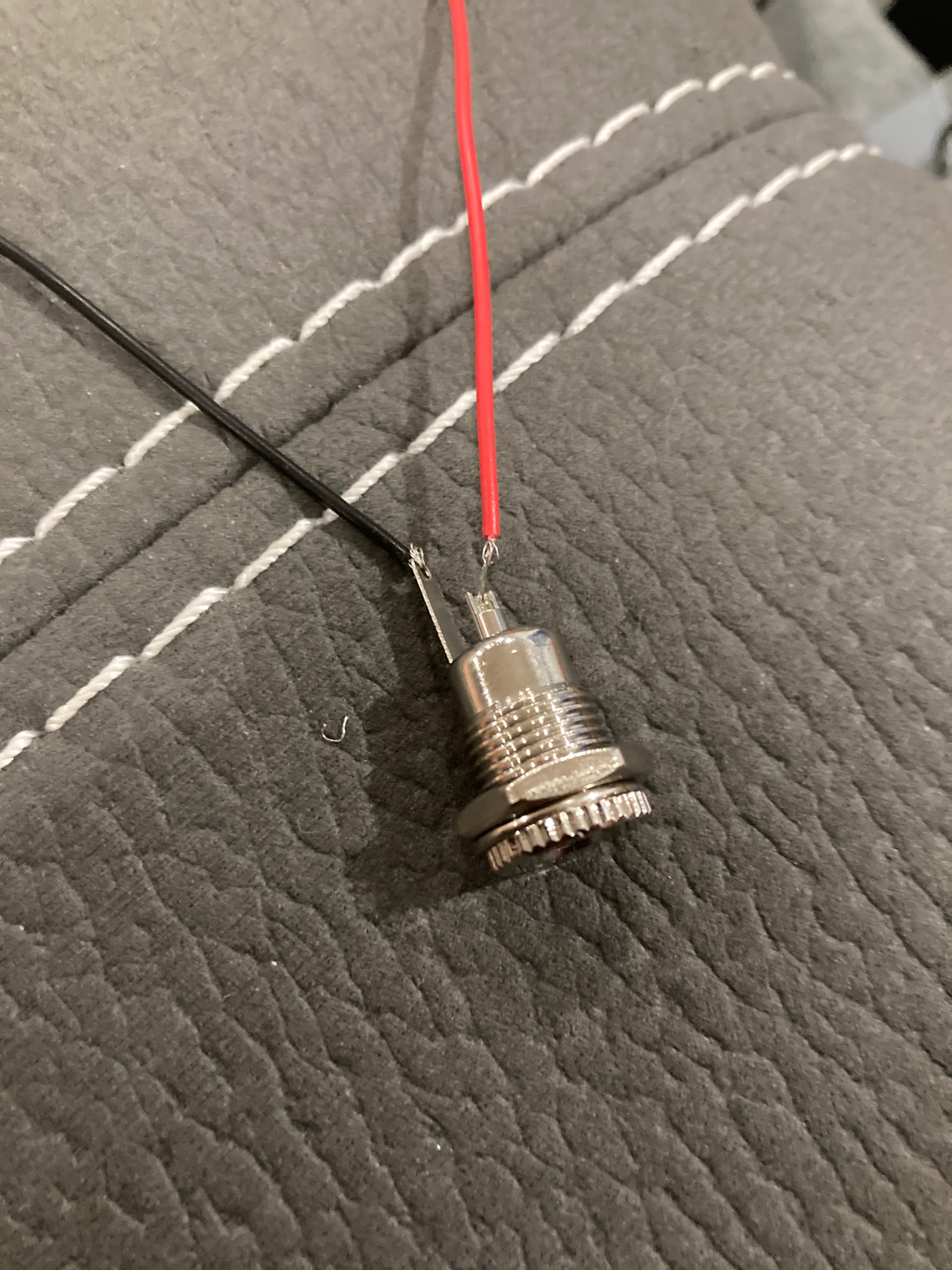

Is this the correct polarity for a 5.5*2.5mm jack? Power in the middle and ground on the circumference?
That is the most commonly used arrangement, yes.
I still highly, HIGHLY recommend verifying your charger’s polarity with a voltmeter before plugging anything in. Don’t trust blindly when equipment is on the line. See above about flipped polarities destroying a BMS.

Plug an unused male connector into this while soldering it, to ensure the pin stays concentric.

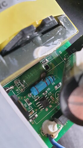

Looks the same as my yzpower one from the circuit design. Mine burnt in virtually the same places but the first time I plugged it in and turned it on without even connecting it to the board. It blew out the fuse, diode, resistor and bridge rectifier as well as god knows what else.
Maybe there’s a weak point on them, either way I got a wate one to replace it and that works fine so far.
