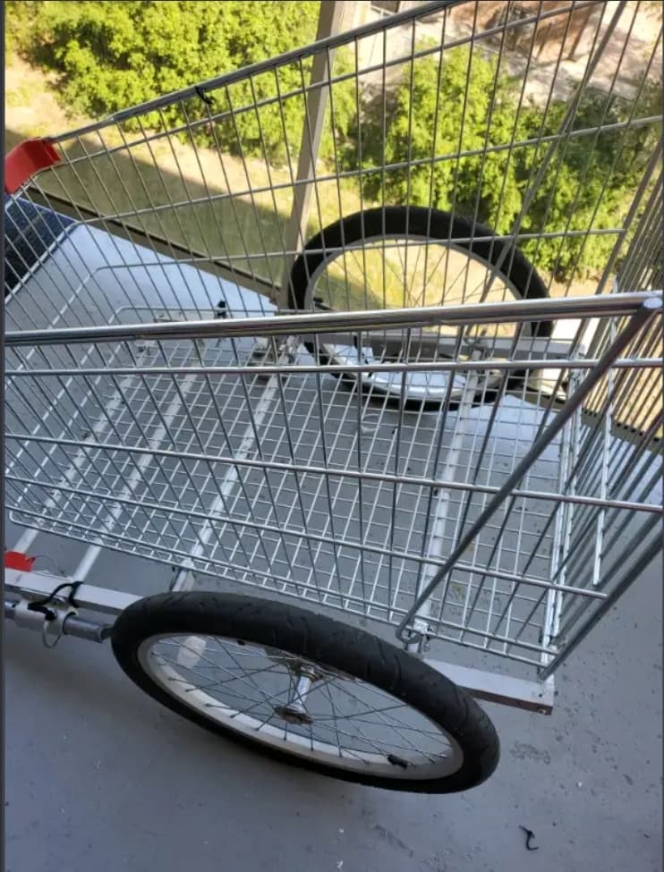

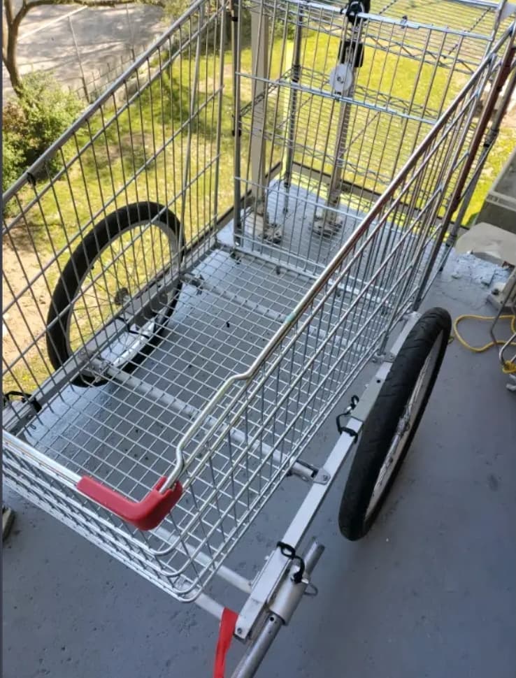

I found some good deals for double kids trailers for approx $200 with a max weight of 45kg. I’m hoping it can carry light adults ~ 60kg. I’m not so sure about that so I also ran into this for $120… looks like it can handle an adult :joy: what do you think? Could I mod this with a Dremel and make it nice to sit in?

and on the trailer I would have to say try to save up for a legit one, or a legit one that is used.
the shopping cart might roll fine… but I can’t see finding comfort in there unless you are Bam Margera…
