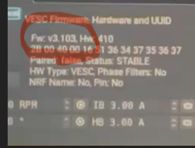

I think that says the VESC is on 3.1. But I’m both not sure that’s the vesc annd not the configurator and if that would be a problem. I had lots of trouble getting older vesc configurators installed I can try send you something for a 5.xx related one later
Wasnt tgere a weird jump in fw around 4 or 5 where you could only update to 5 from the latest 4 or some shit like tgat?

Please stop trying to read/write configurations or do any more detections until you have the firmware sorted.
That’s a screenshot from your video
That’s a quote from one of the threads I linked.

@Dnollie As Al said don’t mess with any settings, wizards or anything until you figured out the firmware. Vesc can sometimes be iffy about doing big firmware jumps, go into the archive and download an older version of the tool and update via that, then do jumps to higher firmwares bit by bit.
Remember to follow the firmware reboot instructions after flashing, they were a bit different back then (the tool tells you)

That is the firmware (and hardware revision)
Those come stock and preloaded in every vesc tool
You mentioned you flashed dv4s 5.03 firmware, if so try a normal/recent vesc tool and flash the stock 410/411/412 firmware so you’re on the latest version since you seem to have done the big firmware jump already (from very old to recent)
