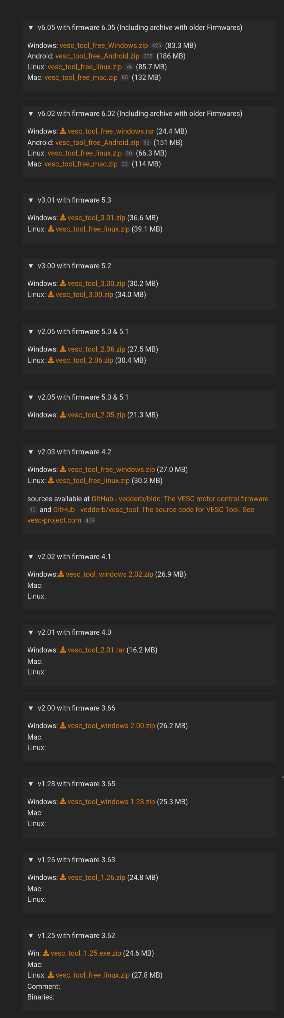

It only seems to have Vesc tool 6.06 on the website? How do I download a earlier version like you said @xsynatic?
Open up
LMFAO
When it brings you to the Vesc tool I don’t see options for different versions of Vesc tool, I’ve read through all those threads and I haven’t found an answer. You just love quoting don’t ya
Click em
vesc-project.com only offers the latest version.
Precompiled VESC tool Archive offers you every version, new and old as long as someone saved and archived that specific version.
