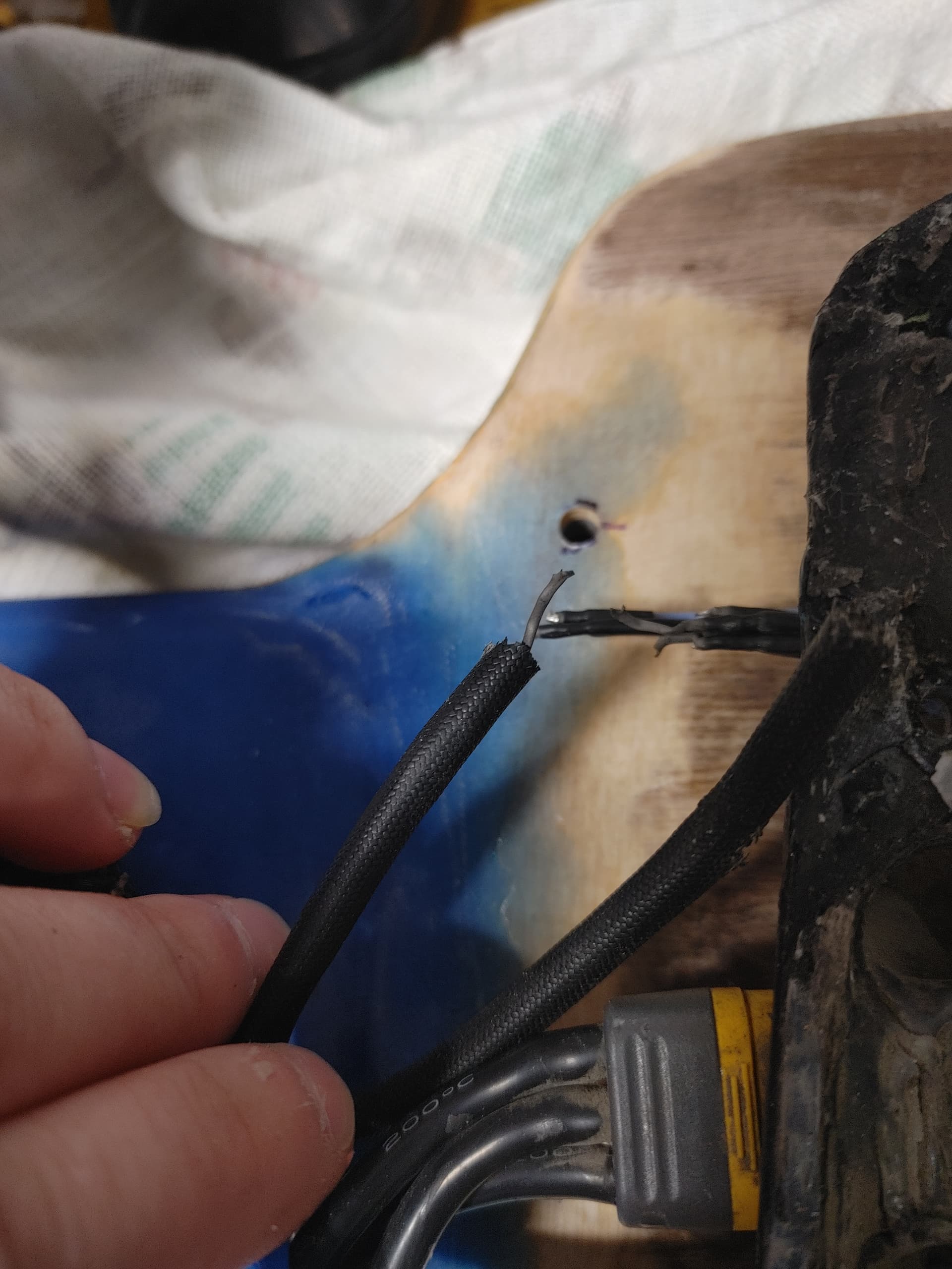

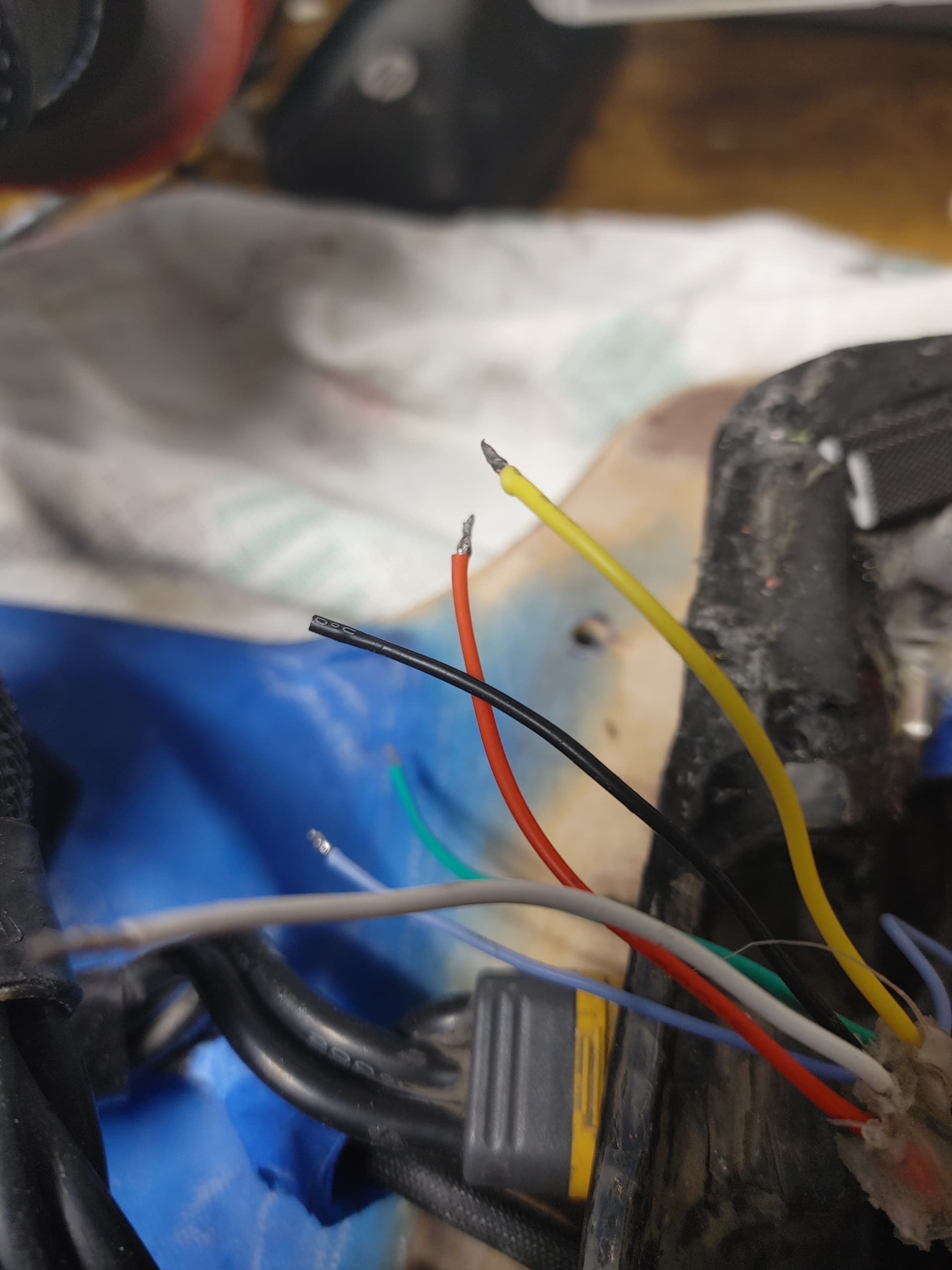

I stepped away for 30 seconds and my board fell off the desk and all the sensor wires were torn. :upside_down_face: should I just tape of the ends on the motor side so my board is def usable tomorrow to go to the store, or take the wheels and motors off to use this as a reason to switch to the new motors early?
Part of it fell on my dog but thankfully she’s unharmed. She might have a few bruises but that is it.
Update: looks like they all failed where they were spliced. I guess I shouldnt be surprised given how hard it was to splice 26awg wire to begin with. It didn’t fail until now though so good enough ? :person_shrugging:

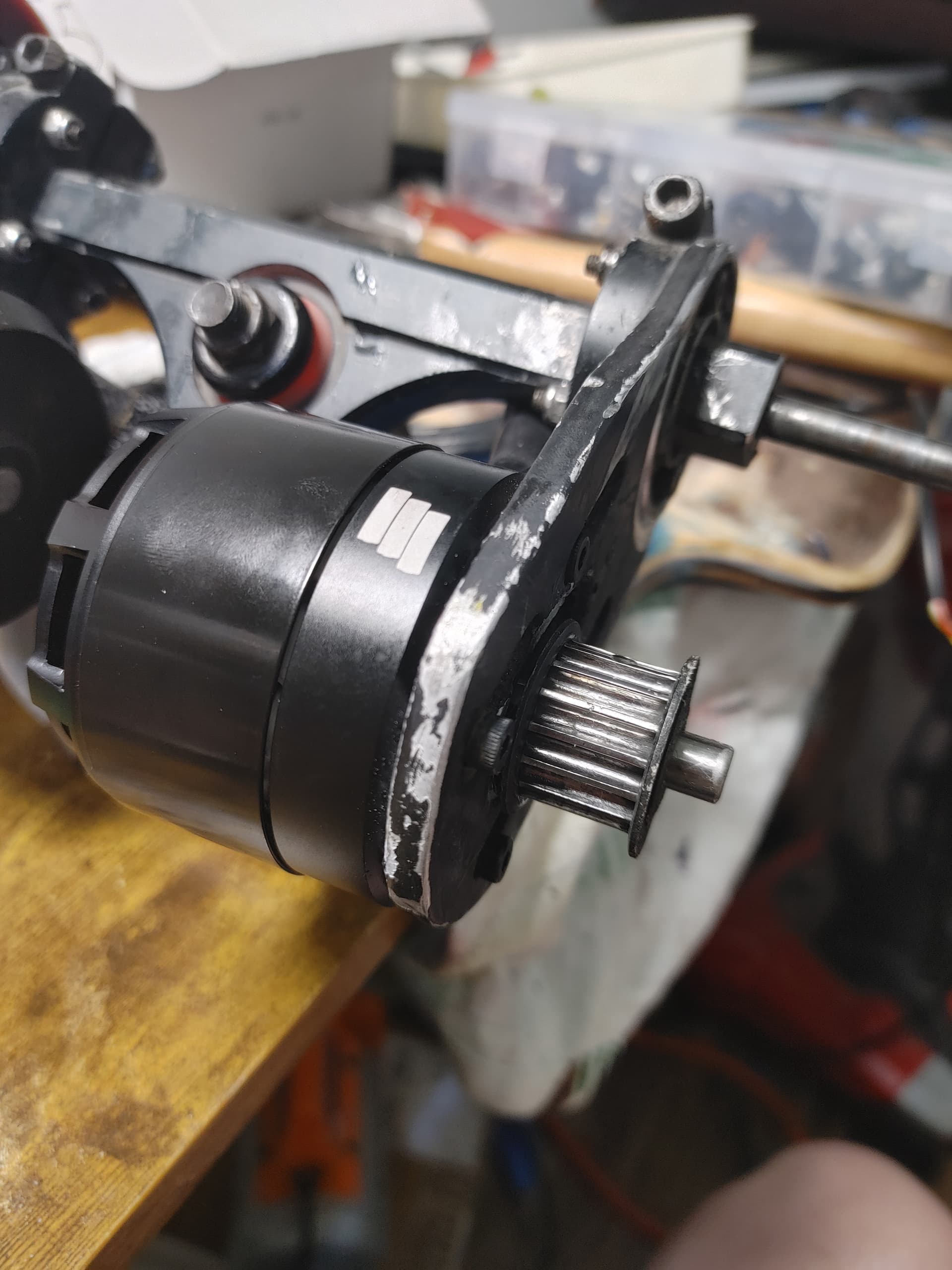

I decided to switch to the new motors and I regret it. :upside_down_face: Stupid set screw got stuck and made me waste time getting it out. So i only have 1 new motor on the board and with the proper connector on it.
It was a pain to get the pulley on too since SKP motors have long shafts. I don’t need the length but im sure it is better to have it than for it to be too short

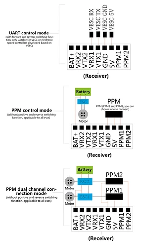

I know I’ve gotten quite a bit of help already but is anyone familiar with remotes and vesc?
I want to use multiple and different vescs. Connecting over can is dangerous and not possible. Can I wire receiver uart output (TX?) to multiple vescs and the input for telemetry of just one vesc to the receiver? Or can I put ppm al in parallel?
why? thi s is the usual way.
uart is not a bus, and not splitable without some multiplexing software in between. even then it’s sketch. so no.
second choice after CAN is split PPM ( ServoControl)
Dangerous because I have seen two instances of a VESC dieing and destroying another connected only over can. And it might not be an option if using different VESCs front - back is an issue.
I was hoping the fact that uart had separate tx and rx meant I was in luck. I definitely saw something about splitting receiver inputs to multiple VESCs somewhere.
But actually I think I can use the dual VESC ppm mode for one front and one back and connect just left - right over can.
i think @Titoxd1000 did his AWD that way.
