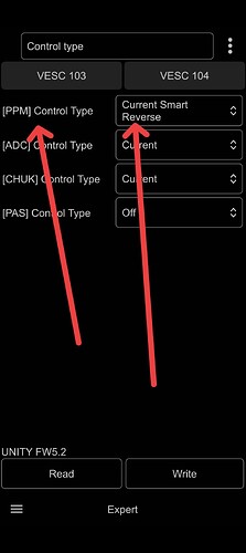

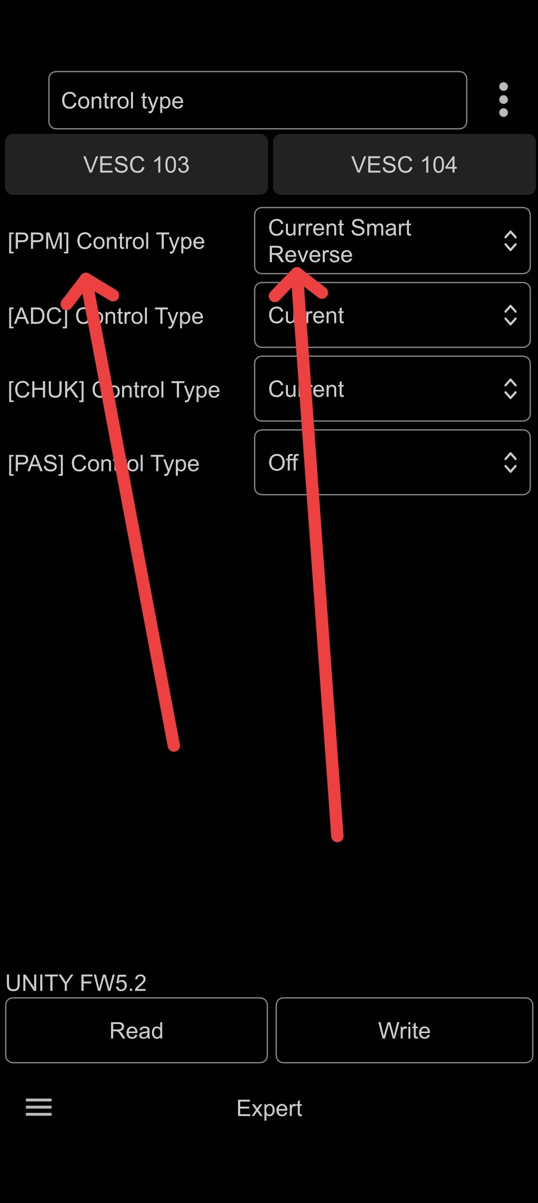

If you’re connected to metr, go into the expert settings and check for “control type”

I’m not sure. I’ve got a vx4, puck, and old maytech remote that I tried, all paired with the focbox but they just don’t do anything and there’s no data shown on the vx4 but it shows it’s paired. The metr is plugged in and the focbox’s are connected over can or whatever that is, the metr just doesn’t seem to be getting any power. Plus, I can’t get either focbox to get seen by Vesc tool, I’ve tried different computers, cords and everything. Just doesn’t show up in Vesc tool. I’m guessing both usb mini ports are messed up somehow.
