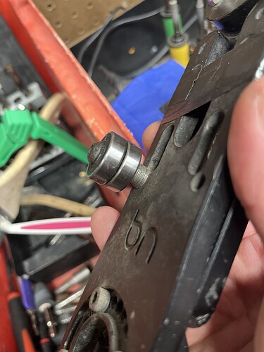

I’m struggling to get something to work with idlers, no matter what I do the belt just slides right off immediately. Could anyone provide insight or explain or send pics of how one goes together like if it has the bearing pressed against the motor mount for alignment or if the bearing fits the screw snugly.
Would a concave or convex sleeve over 2 bearings help? I can make something up on a lathe but idk what to do.
I don’t know belt drives, but could it be too tight? Seems like and misalignment would be magnified as the tension goes up but I don’t have a lot of experience.
I had plans to use these bn mounts with the idlers but never followed through. The inner races on the bearings are quite snug and have no slop though. Trying less tension and have the idlers mounted rigidly so the slop in the bearings can’t push the belt out of alignment would be my first move. A little longer belt maybe if there isn’t any more adjustment on the mount?
