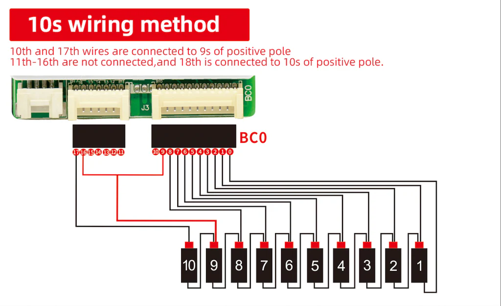

What’s the exact model of bms? Pic of the sticker and ill post up the wiring diagram. The balance leads need to be adjusted either by landing multiple on one group or adding jumpers/soldering the back of the header connector to get it right
https://www.amazon.com/dp/B0D6VBSYTX?ref=ppx_yo2ov_dt_b_fed_asin_title
It’s model no. JBD17S005 V1.6, as delivered
ok so you can do this two ways - run jumpers 9-16 to pgroup 9 or you can take the insulating sheet off the back of the bms and solder a jumper across the 9-16 pins on the back. either way will work and fix ya up. just double check yourself here and make sure you got it correct as shorting or miswiring can brick your fancy new bms.
also if you are just doing 10s, the model SP14S004 is newer and smaller and cheaper. up to 50a charging and discharging before you need to go up in form factor. only does up to 14s though so keep that in mind.
Thanks a ton! I had no idea about this. I did actually order a couple SP14S004 models to try before this, but the volt readings had a lot of noise for some reason, on both units. As in, the readout on the app kept jumping around by up to 0.1V/cell. Could also be the same wiring problem, I suppose.
You’re correct. the 14s ones, because the wiring uses the last group and preceding un used groups will read wonky but the software will keep the correct cell count. The 17 will add a group because it uses the second to last and has to invent a place for the last voltage reading. All will be wonky until the balance leads are sorted out. I did have one weird one from the factory but dozens of good one so i didn’t even try to return it - and it was a communication problem with the android app so maybe a bad Bluetooth. So cheap i just swapped it out and tossed it ![]()

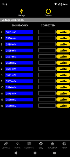

Fyi, the OverkillSolar phone app is compatible with LLT/JBD, and has cell voltage calibration that is written to the bms AFAIK:
Some manual balancing later, and everything is sorted out. Thanks again, banana man
