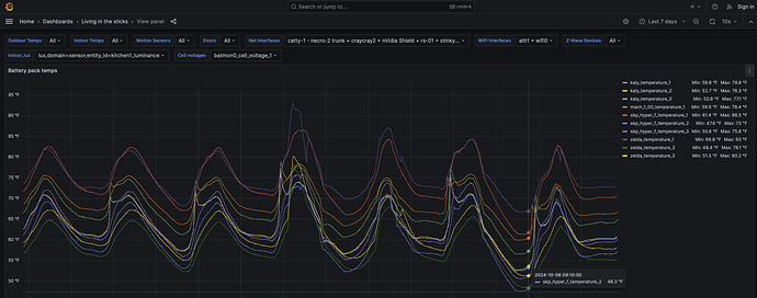

So I just moved to a place with an unheated garage separate from my house. This past week, battery packs have been started dropping into the high 40s. I know you’re not supposed to charge anywhere below 0ºC (I’d bring the pack up to room temp prior to charging if I do end up riding in colder weather), but in terms of general storage, is it ok to leave them out in the garage at storage voltage during the winter or should I bring them in? They’re all either P42A packs or P42B packs, which are rated to -40ºC for discharge.
Pretty graphs for reference.
This post is extremely useful but was wondering if anyone had any practical experience leaving boards in 0º-10ºF temps.

Check the datasheets to be sure but every cell I’ve seen is rated to -20°C or lower during storage. If those two cells are rated to -40°C for discharge then they’re probably also rated that for storage.

Datasheets for both unfortunately only cover temps for “charging” and “discharging”; nothing really specified for storage.
INR21700P42B-V1-80101.pdf (666.4 KB)
INR21700P42A-V4-80092.pdf (447.5 KB)
I hate that they call those “datasheets”. They’re just short spec sheets. The full datasheets are about 15 pages.
Weird…the full datasheet doesn’t have a storage temp other than “<23°C”. Sorry to send you on a wild goose chase.
I guess just use the other temp specs. It’s -20°C for charge and -40°C for discharge so a conservative approach would be -20°C limit for storage, otherwise -40°C.
