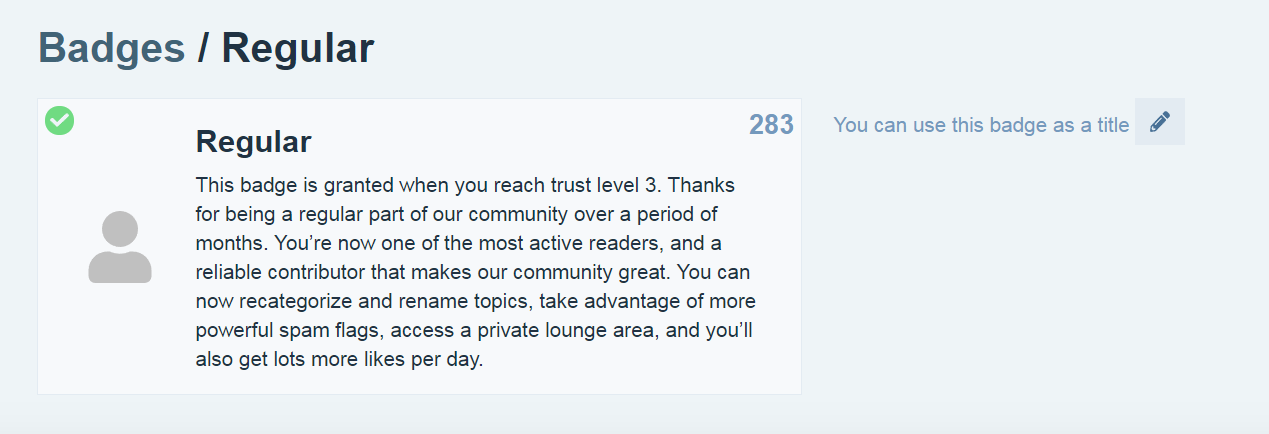

I’ve been too busy with work lately and then I come back and see that all the regular threads are gone. What happened?? my profile still has the regular badge on it so I’m very confused :fearful:
Shows you as member as opposed to a regular :face_with_diagonal_mouth:
it is right here tho? :sob: I’ve been reading the new threads every other day or daily but just haven’t had anything to reply to on most of them
am I going to have to bribe @longhairedboy to fix it? I think the system makes you wait to get it back if it is gone
A badge just means you got it once, like an achievement. When you click on my profile, notice it says regular? Your’s says member.
