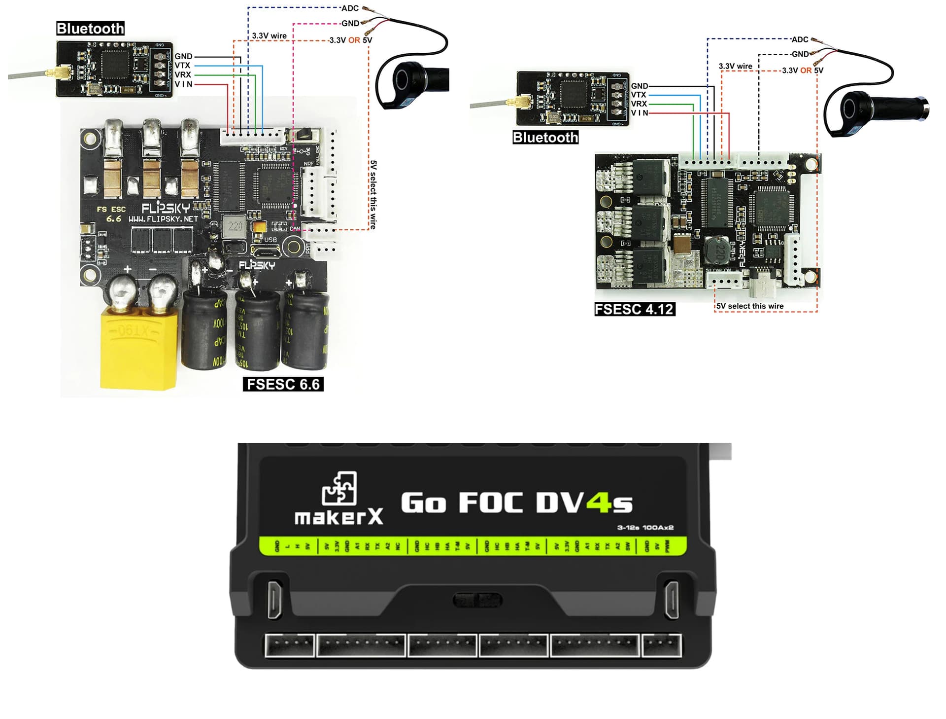

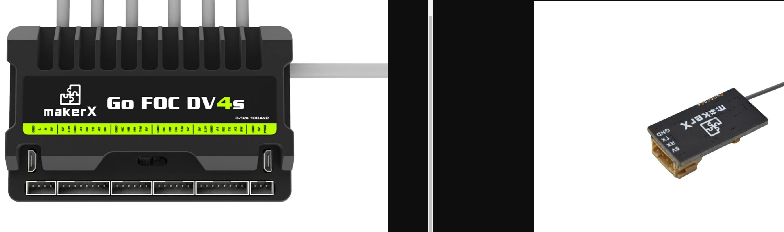

What is the best way to figure out which Bluetooth module (specifically the UART port pin readout/config.) will work with my ESC. I have a Maker DV4s on the way and I would like to order the right bluetooth module from Flipsky.
the more I look at this the more confused I am…
I might be dumb as shit…but even makers BT module doesn’t seem to fit…
Is there a way to pin a thread to the top or is it just to save the link?
The only difference between the two up there is the wiring and connector size.
You’ll want to order the 4.12 one - you may have to re pin if the pinout doesn’t match the dv4s though. Also, the makerx one does work, it comes with a cable, ofc, to connect the male to males

Are you sure tho? It looks like the JST concetor from flipsky has 7 pins and there are 8 pins on the Maker DV4s

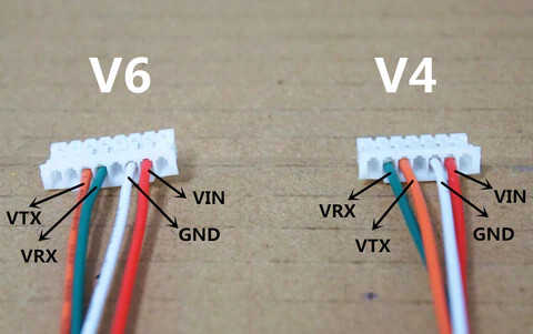

The pin out is the same, the tx/rx are flipped though. If yours are backwards. Remote won’t work, really easy to trial/error
Like I said… The only difference is connector size and pins
Order the one that is the correct amount of pins
You can put 7 pin in the 8 pin hole, just make sure it is aligned to the correct side (5v to 5v)
