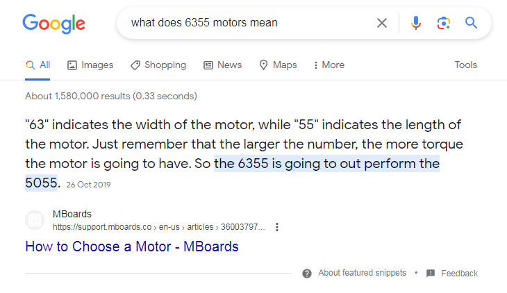

@Skyart got some potentially dumb questions about your 6355 motors. The main one being if 55mm is the motor diameter or length. I’m running 6354 motors and don’t think I have the extra 2mm if they’re longer.
Also I’m using 190kv motors now but have no idea if the 205kv would be better or not. I only run a 12s battery if that matters
Most brushless motors use XY nomenclature for dimensions. X == diameter, Y == length. 6355 is a 63mm diameter and 55mm length.
Motor kv relates to the RPM the motor spins at a given voltage, with the same 12s battery going from 190kv-205kv you’ll gain a small amount of top speed and lose a bit of torque similar to if you changed to about 7% more tall gearing.
Edit: also if you’re going from flipsky motors to reacher motors of a similar sizing, as long as you have the headroom in your battery/vesc, you should be able to increase the amps to make up for the decrease in torque and then some.
honestly not even hard to google
Thank you for explaining it so well. I might be cutting it close with the extra millimeter but looks like I might be able to get away with it if the motor gear isn’t put too far down the motor axle
Sounds like I should just go with the 205kv then since I don’t need more torque and losing a bit shouldn’t matter that much to me
