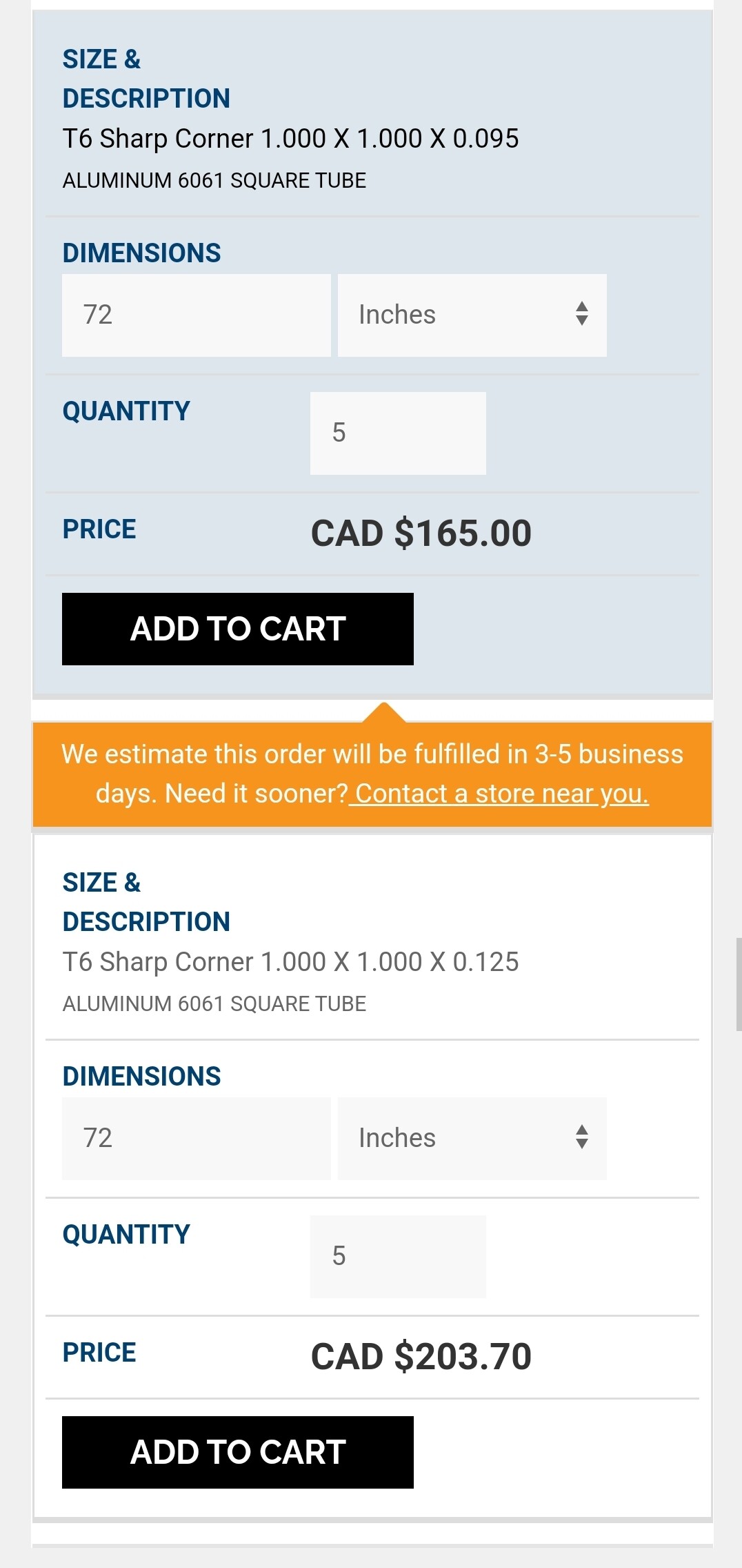

So given that mild welded steel from metal supermarkets will look bad since I don’t plan to paint it and stainless steel sucks, will aluminium look better down the line if I don’t do anything to it?
In that case I’m considering this which is close in $ to that welded steel above
Aluminum can be left unpainted and it will be fine. Steel needs to be painted, but honestly you could take the money you save going for steel over aluminum and pay yourself for time and materials to paint it. Just some rattle cans of primer and paint would do it, it doesn’t have to be fancy.
Stainless is expensive and heavy, not worth.
Mild steel is just as heavy as stainless, but much cheaper.
Aluminum is somewhere in the middle price wise, lighter, but not quite as strong. (It would probably be fine though, .095 wall is pretty sturdy.)
The way i see it:
  • Aluminum will not rust, so you don’t need to paint it.
  • Aluminum is much easier to cut/drill
  • Aluminum tubes are generally manufactured to much tighter dimensional tolerances than hot rolled steel ones. (they also have a much more square shape)
  • aluminum is much lighter than steel (~1/2)
so yeah, id probably go with 1/8" wall aluminum tubing (.095 is probably also fine). Im quite confident that will be strong enough, and i think aluminum is definitely the right material for this application.

Are you aiming to have a metallic finish, and want something easy to weld?
You could sand the steel to give it a even finish, then clear coat to prevent rust.

I don’t plan on doing any welding, so I guess metallic. I just don’t want it to rust?

Then I would also vote for aluminum :+1:
