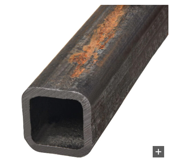

Thank you for your help @MysticalDork, I requested a quote from metalpros as you suggested for 6061 flat bar and it looks to be only about $15. I am now planning to build a trailer and I could use some more help.
I’m planning to make it using this DIY kit Bike Trailer | Cargo & Child Bike Trailers | DIY Cargo Bike Trailer…. For this, I will need to order square tubing. Their kit is designed for a max of 150lbs but I will be carrying sometimes 200lbs (an adult) so they suggest steel for extra heavy loads.
In doing so, I’m thinking of getting 5 of these SQ TUBE,304SS,1 OD SQ X 7/8 ID SQ,6 FT https://www.grainger.ca/en/product/SQ-TUBE%2C304SS%2C1-OD-SQ-X-7-8-ID-SQ%2C6-FT/p/WWG4YUJ5?analytics=cart. This will be cut to 4 feet x3, 2 feet x5, 5 feet x1 (for hitch). (2 feet x1 and 1 feet x1 extra). So I’ll be making a 2’ x 4’ trailer. It should be enough for someone to sit with legs fully flat forwards.
Then I will probably get a sheet of plywood to make the floor and put the top half of a desk chair or lawn chair screwed/bolted on top, to keep it lightweight because it’s already quite heavy altogether.

Metal Supermarket has steel tube for much cheaper than Grainger, haven’t checked shipping but 5x 6ft steel tubes comes to $109. If you live in a city with any sort of industry you may also be able to find a metals supplier locally that would save you shipping.
I have a question about that, it seems welded metal has a rough finish? I was thinking do I get stainless steel instead to make it more weather and rust resistant or else it will look like this down the line?
