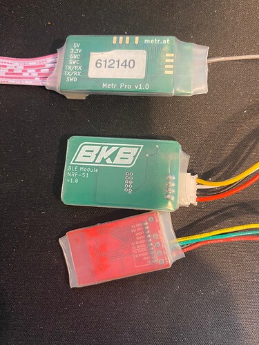

i also tried to connect to the ubox via the app (ios) with no luck. i have tried detecting is with the native bluetooth on the ubox, thought im not sure if this one has that or if I’m just crazy thinking it does as ive never gotten it to connect or detected an available connection. i tried using the provided external blue tooth module from spintend… same nothing burger - it has a blue indicator led on it that flashes but no connection via the app or Bluetooth on my pc. i also have an old bkb Bluetooth module (V1) but im not sure if it is can or uart and the board pin out on it isn’t labeled so i may have killed it trying to plug it in.
i also have a metr pro v1 uart that i have tried to connect to the ubox with no success but i believe there is something i read a long time ago saying that no only are the uart metrpro v1 kinda finicky but they also wont work on a ubox fsr…

Mashed all the buttons, no change i can see :frowning: just to put the cable to rest i have two different ones ordered to try. I just feel like it shouldn’t be this hard, maybe i burned up the uart chip? Repairing that would be quite a bit beyond what I’m currently comfortable doing.
Got in!!! I grabbed 4 different cables from it at my work and non worked, then i got a super short (6”) cable and it works!!! NonShielded cable issue? Idk, now to turn on the bluetooth ffs

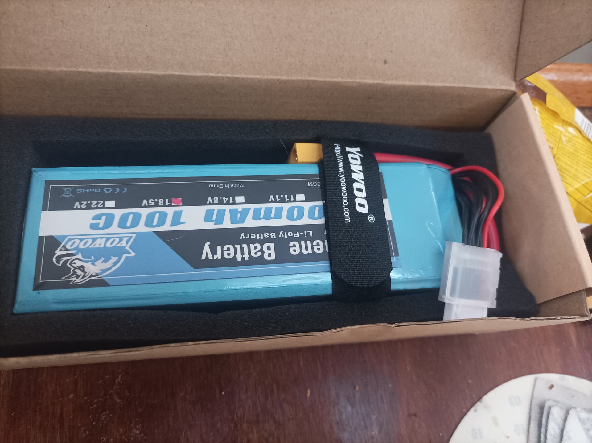

Anybody got a link for wiring 4x 5s lipos into a 10s2p with bms? Tried searching but couldnt find the specific case so figured id post the question here :innocent:
One BMS or two?
That’s going to be a lot of balance wires. Typically the 10S2P battery won’t be exposing its balance wires, either. Does it already have an internal BMS?
Show a pic
Typically LiPo pouches don’t have a BMS and are just charged on a balance charger.
Yes, but I would add a BMS or add them onto the existing BMS, hence the questions. I would not use them without a BMS.

So it’s 4x 5000mah 5s batteries, one 10s BMS, my idea is to parallel 2 to make it 10ah and then series connect them to make it 10s
Yes, that will work. Do yourself a favor and get these things
https://www.amazon.com/gp/product/B07PYYM5PD/ref=ppx_yo_dt_b_asin_title_o05_s00?ie=UTF8&th=1
They are lipo balance lead extensions. But you can cut one end off of them and wire them up to the BMS balance connector — and work on it while it’s not energized — then simply plug them in at the end.
I do not recommend directly soldering on the live balance wires if there’s such an easy alternative.
Also when you have connectors plugged together in the enclosure, use a piece of string or a tiny cable tie to make sure they don’t come undone from vibrations.
