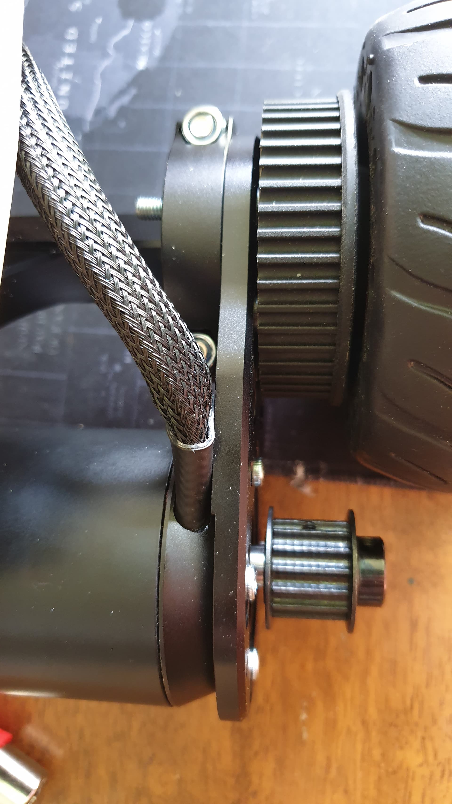

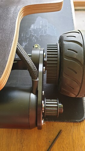

Thanks, doing it like that though is too close due to the collar on the motor shaft and can’t add more spacers due to the pulley size vs axle length
so still have to do it by eye. Does the below look acceptable? I will obviously make sure it’s perfect before tightening everything up properly
I’d find a piece of metal or paperboard or something to put between the wheel pulley and mount while you tighten the clamp. So they still stay parallel.
The closer those are to parallel, the less skipping and less belt wear and/or problems you will have.
Will do thanks

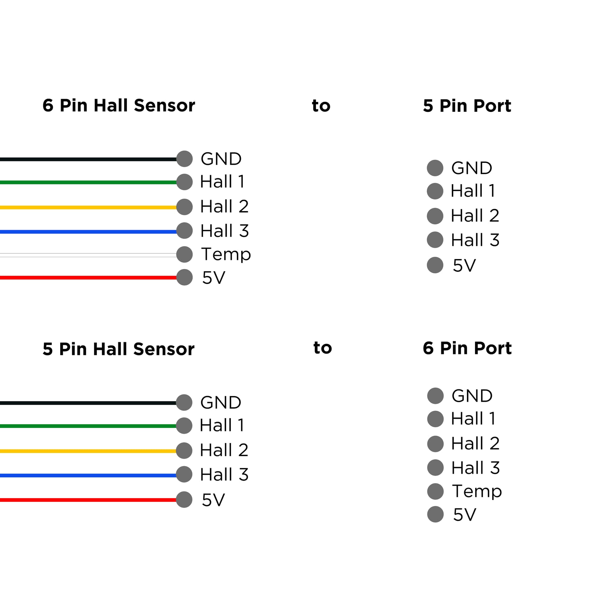

My Parts have arrived and I notices the color of the sensor cables on the motor is mixed around (they also said on their website that it is somehow different but nothing in detail…)
I found this graphic for the sensor cables and the ground seems to be switched with temp (on my motors)?
It is a 6 pin/strands btw and I think temperature readout on hub motors could be pretty useful … :thinking:

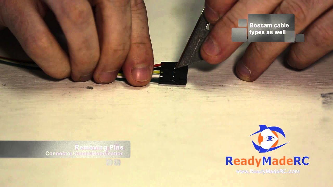

You can change those around really easily with a safety pin or a knife.
The order of the hall sensors doesn’t matter, it’s autodetected. The other ones matter.
Don’t bend the plastic up more than just enough to pull the pin out or it won’t grip very well.
Thank you
and how do I find out if the white one (on my photo where ground/black should be) is temp or ground? Or is there any way to find out where temp/5V/ground are?
There’s a very good chance that red is +5v, black is ground, white is temp, and the other three are the hall sensors. The motor documentation should include that info.

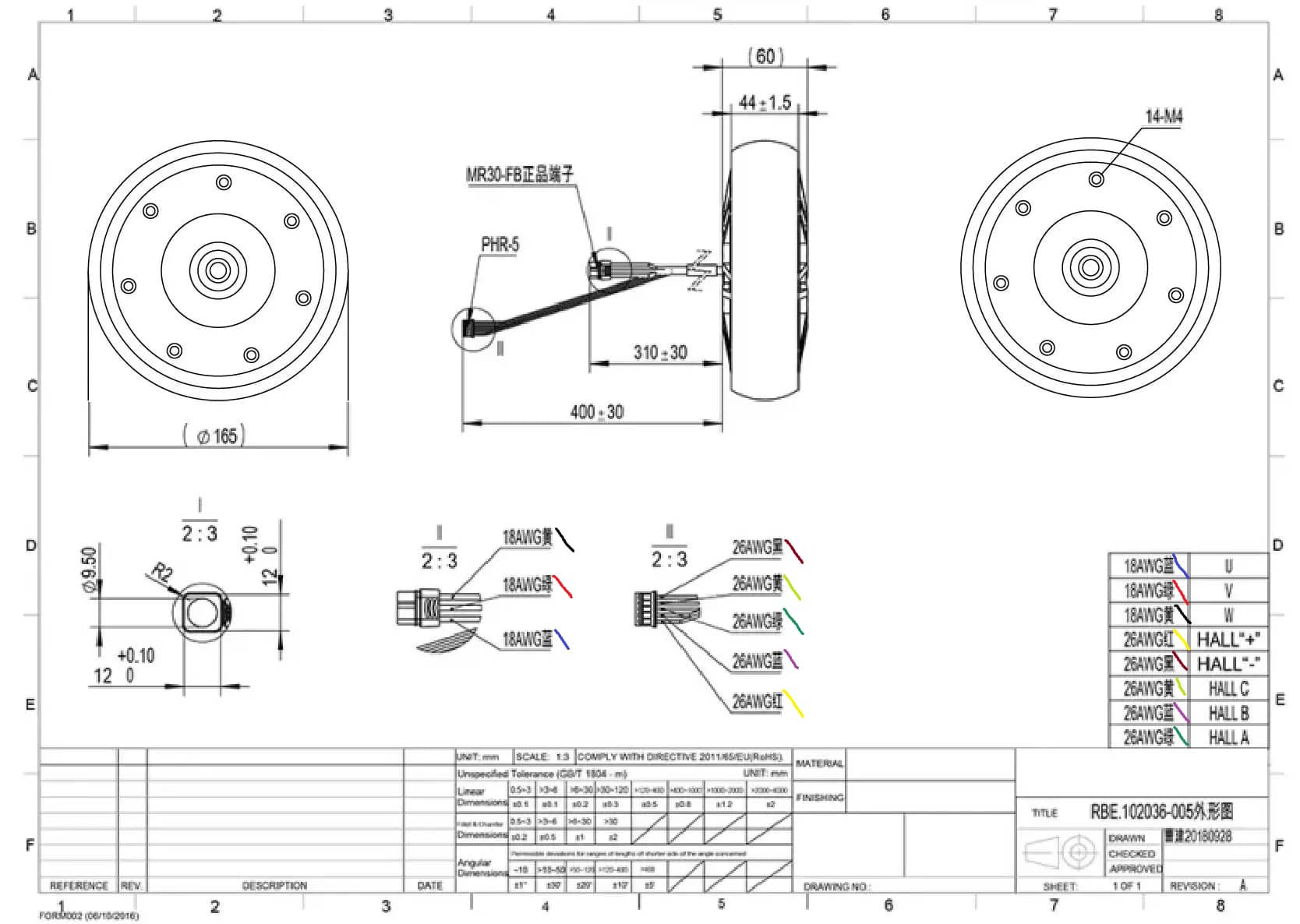

The motors sadly dont come with any documentation as they are being sold as replacement parts for ranger x2 boards and I guess are intended to be used with their “proprietary” hardware/escs.
I found this picture on the internet (ali-seller) selling similar looking hub motors under a different name/brand (maxfind?)
I could not translate the symbols next to the cable description (too few pixels) so I just color coded which symbols look like the other…
Sadly this datasheet describes a round plug and doesnt help me at all. If anyone knows how to get datasheets for such “custom” parts from companies like Backfire pls enlighten me!
I wrote something wrong there… not a round plug but a 5 pin plug (means no temp?)
And I just got an idea: is the temp analog or digital? Could I just measure the resistance on the “temp” pins and look for a change when heating the thing slightly in an oven or something? Or if its digital would it work to apply voltage to the pins and read out on the esc tool if there is data for temperature or something? (worst thing that could happen would just be a broken hal-thing, no? I heard I could just power the motors with the 3pin alone and drive “blind” so the hal doesnt affect that at all.
there is no temp sensor on most hobbywing motors (this one u showed is hobbywing motor)
and the translation for the table on the right side is as follow
Blue | U = empty
Green | V = empty
Yellow | W = empty
Red | HALL"+" = V+
Black | HALL"-" = GND
Yellow | HALL C = HALL C
Blue | HALL B = HALL B
Green | HALL A = HALL A
HALL ABC doesn’t matter the order when u r using vesc, as it is automatically detect and arranged in the vesctool software, so their order doesn’t matter.
in most case, red is always V+ and black is GND, white is temp if it exist but rarely it does. other colours usually correspond to HALL ABC (or 123 if u want)

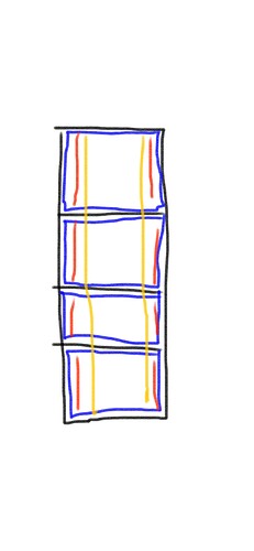

I want to put some lights on my lacroix lonestar supersport
I’m wondering about how to set up the light strips in regards to not tearing them due to the flex in the board
So the picture is a sketch of the bottom of the board, black squares represent the battery compartments / flea lines, Coloured lines represent led strip configurations, what would you guys do
