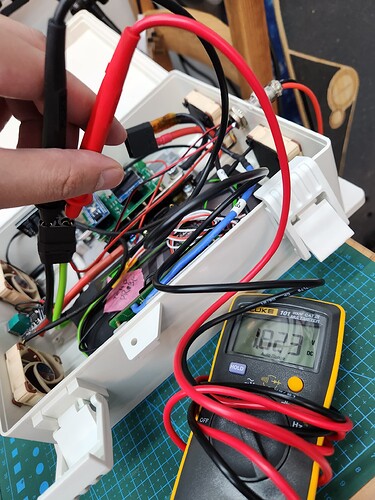

I have a stormcore 60D+ issue.
I finished a ride a few days ago and turned off the board. I went to turn it on the next day and it wouldn’t. This has happened before and I usually just have to disconnect and re-connect the battery. I did it a few days later and my boards battery was almost dead, and my stormcore was 27° C in a 19°C room (80F and 66F for the americans).
My stormcore had been warm this entire time (4-5 days), draining the battery and not turning on. It had a green light when I looked at it too but that’s all I know.
It’s connected to a battery built by @Skyart so I doubt there is a fault there. If anyone is familiar with the issue please tell me what I need to do.
Thanks.
Could be that your momentary switch has failed and is stuck in the “closed” position which, as I understand is rare. If this is the case, you could add a loopkey to your circuit as a way to disconnect the Stormcore from the battery instead of having to open it up to do so. You could also try replacing the switch but it’s possible that the built-in anti-spark circuit has failed in which case a new switch wouldn’t accomplish anything.
I’m def not an expert tho.
This thread may shed some light or else reach out to Lacroix directly for support.
@jaykup might also be able to shed some light.
I think its a switch problem as well
You can find cheap replacement 12v led switches that work but i think you want 5v.
open the enclosure, unplug the battery, unplug the power button from the stormcore, then plug battery back in, then two things can happen:
  1. if stormcore power itself on right when u plug in the battery, then ur AS is stuck in closed position and u will need a loopkey to hard disconnect to turn it off
  2. if stormcore doesn’t power on, then get something metal and short the MOM pin on the power button port on the stormcore, this should power on the stormcore. if that works, grab a multimeter and check the continuity on the power button MOM pins, if it beeps, then u need a new button, if it doesn’t beep, report back.
Thank you very much guys.
While I fix the board or wait for parts is there any risk of a battery fire? I would’t normally ask this but the fact that there was current flowing through the ESC for a few days is rather concerning.
