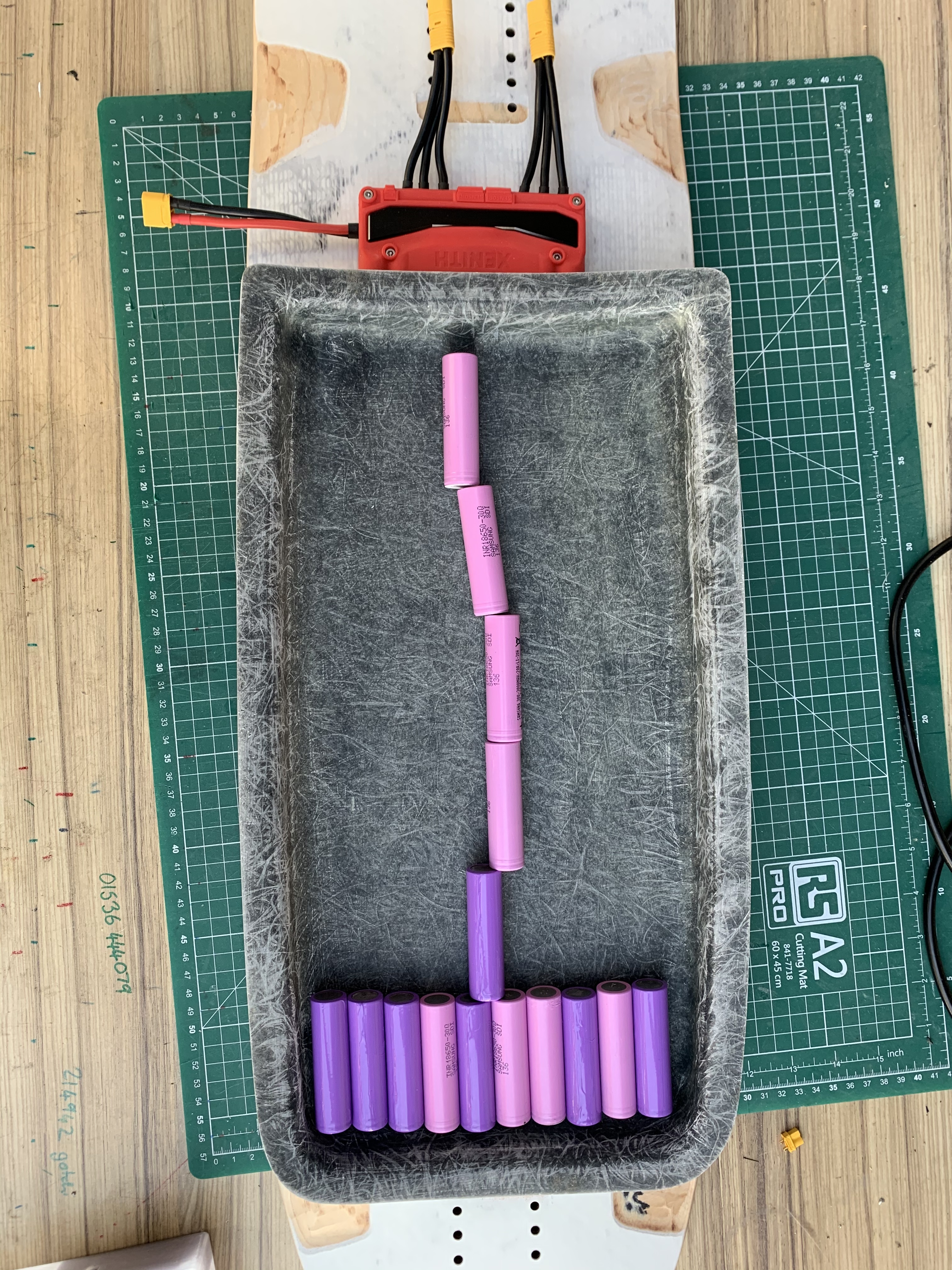

The enclosure is beautiful and fits the deck perfectly but I’m afraid it’s not possible to fit three rows of 3P.
Edit: If the pack is raised to take advantage of the wider area on top it should fit, it has enough height for that. So probably solvable by putting some layer as a base to raise the pack.
You should get 3 layers of 5p if the wider part of against the deck?
Edit 3 blocks of 5p?
Oh so it’s designed to be a TS and not a DS? In that case you advise a 5P instead of a 6P to have enough space for routing the wires?
Ds, 3 cells close to the deck 2 on top with space to spare.
That should work yes, 12S5P it is. :+1:
Does the SS fit a 12S3P? (I packed it already, otherwise would try it myself)
Yes.
I think there’s photos somewhere on the thread?
There’s no real space on these decks to pack in more cells. Unless you start making the enclosures wider than the decks really… it’s a constant battle.
There is, just to make sure it didn’t change with these enclosures.
I think with a deck like this it’s already very good to have these configurations possible.
