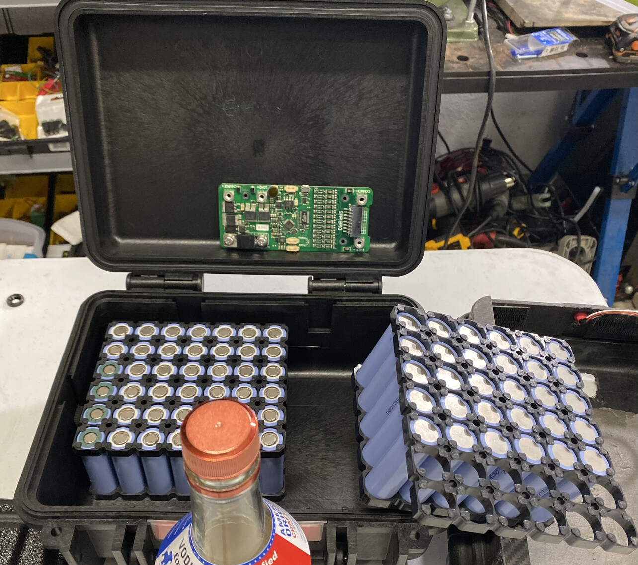

Battery and electronics will fit in one?
Thanks for the photo, you just saved me from possible future mistake.

no problem man, i got really freaking lucky, i printed the neese modules and bought the case to see what config i could fit them in and this seemed to be about all i could get in. their is just about no wiggle room side to side, but their is enough room other way to fit a chunky BMS

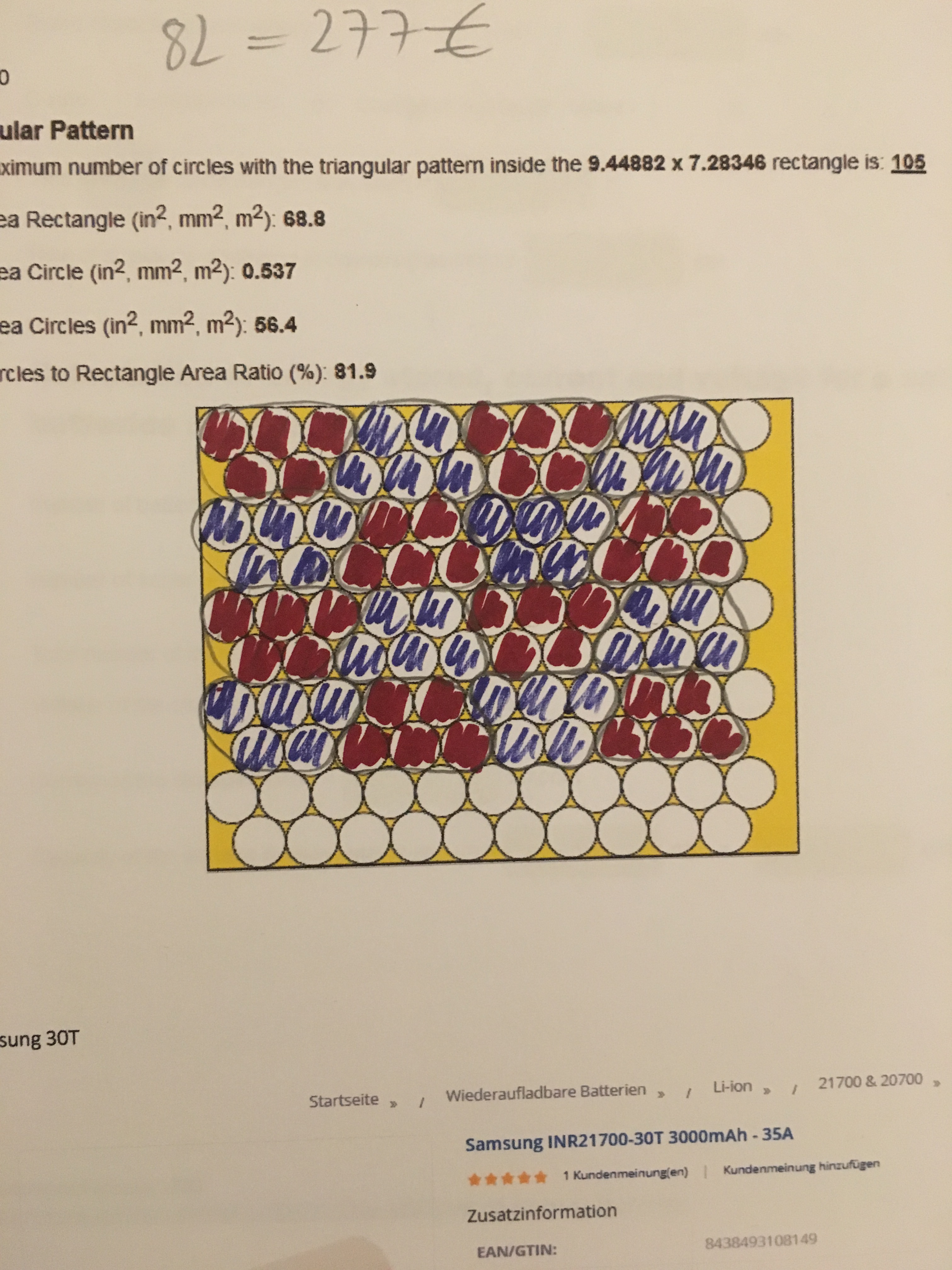

Has anybody the dimensions for a 16s5p 21700 pack?
I made a 12s7p for @Saturn_Corp awhile back. Sure there are better ways to pack cells, but it seemed unreasonably tight to me. (Pictured: 1200 pelican, 21700 cells)
What config? Brick?
If you do a 8x10 brick it’s around 180mm x 230mm with fishpaper between every p group.
80 cells vs the 84 cells, just about the same if you are looking at this case.
Ok so when i do it this way it could be fitting in a pelicase 1200?
What you think?

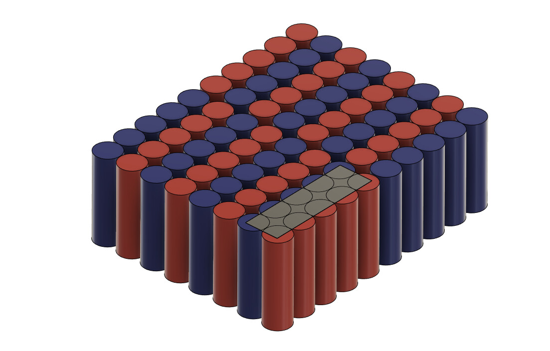

That would work but something like this is probably way easier to build. You can just use a piece of 30mm nickel for each series connection.
The size is around 215mm x 174mm, but the cells are right against each other. Its probably closer to 182mm x 220mm with fish paper and wrapping.

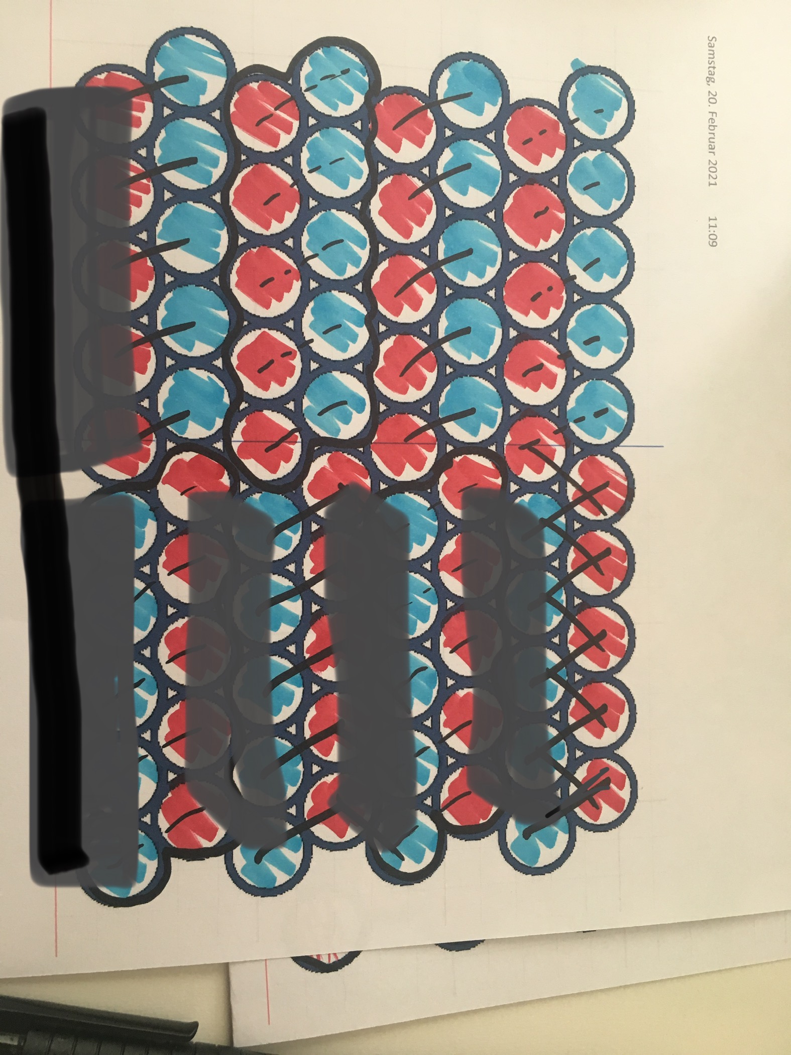

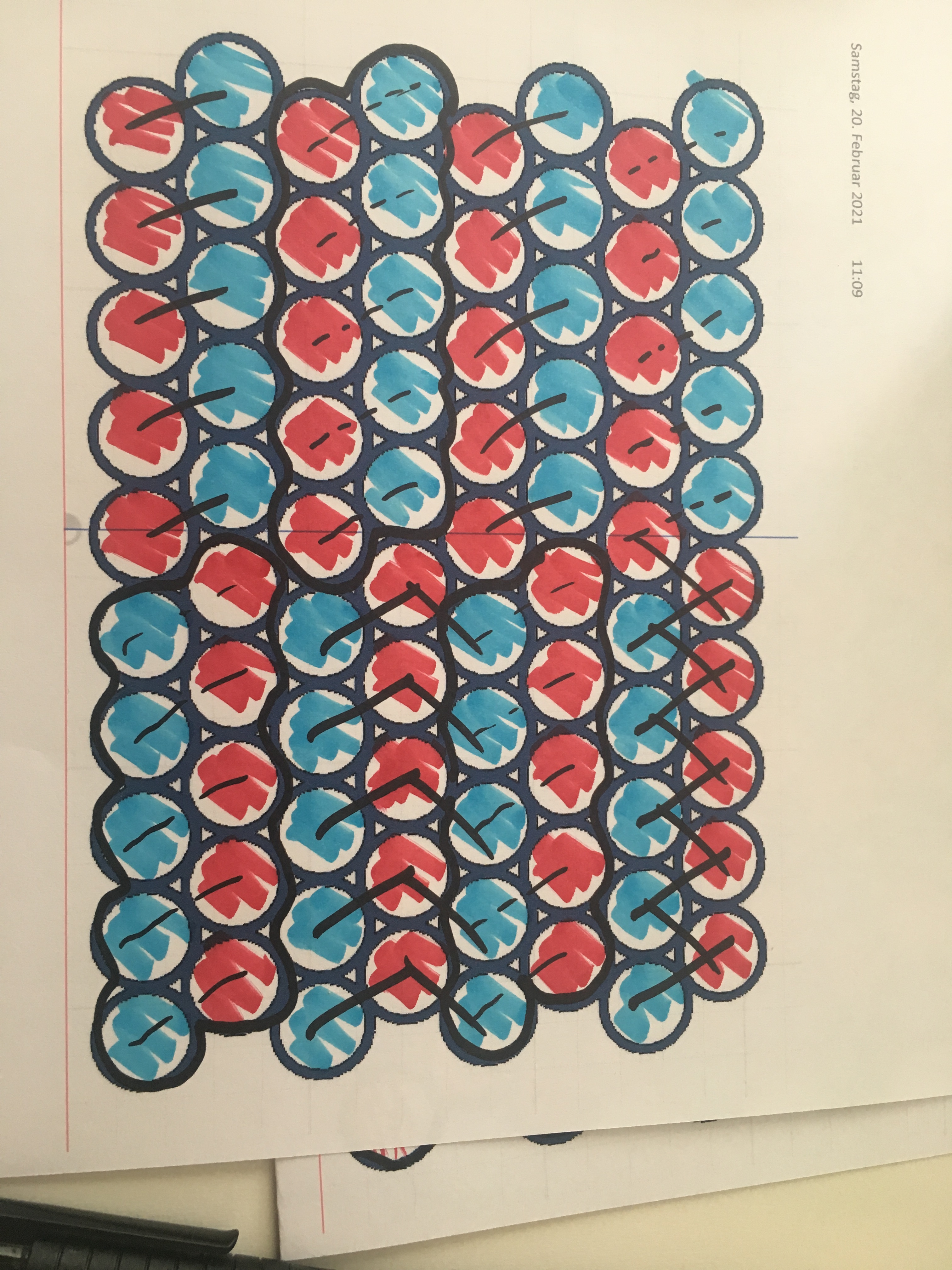

Ok adapted the layout like yours saves me space again
Think ill double the series connections with 2x 0,2x30 or 25 nikel strips
Because the current is going across the width of the strip and not the length, you only need 1 layer for most of the series connections. (Shown at bottom right)
The length of those strips will be approx. 95mm which is a cross section of around 19 mm^2. Nickel can comfortably carry 10A/mm^2 so you are good for ~190A
For the series connection on the end, I would fold over the nickel and use big copper braid or a couple pieces of 12 AWG like shown. Or you could use a bunch of layers of nickel.
Ok great now i understad why i often see packs wothout additional copper braid or similar on top
