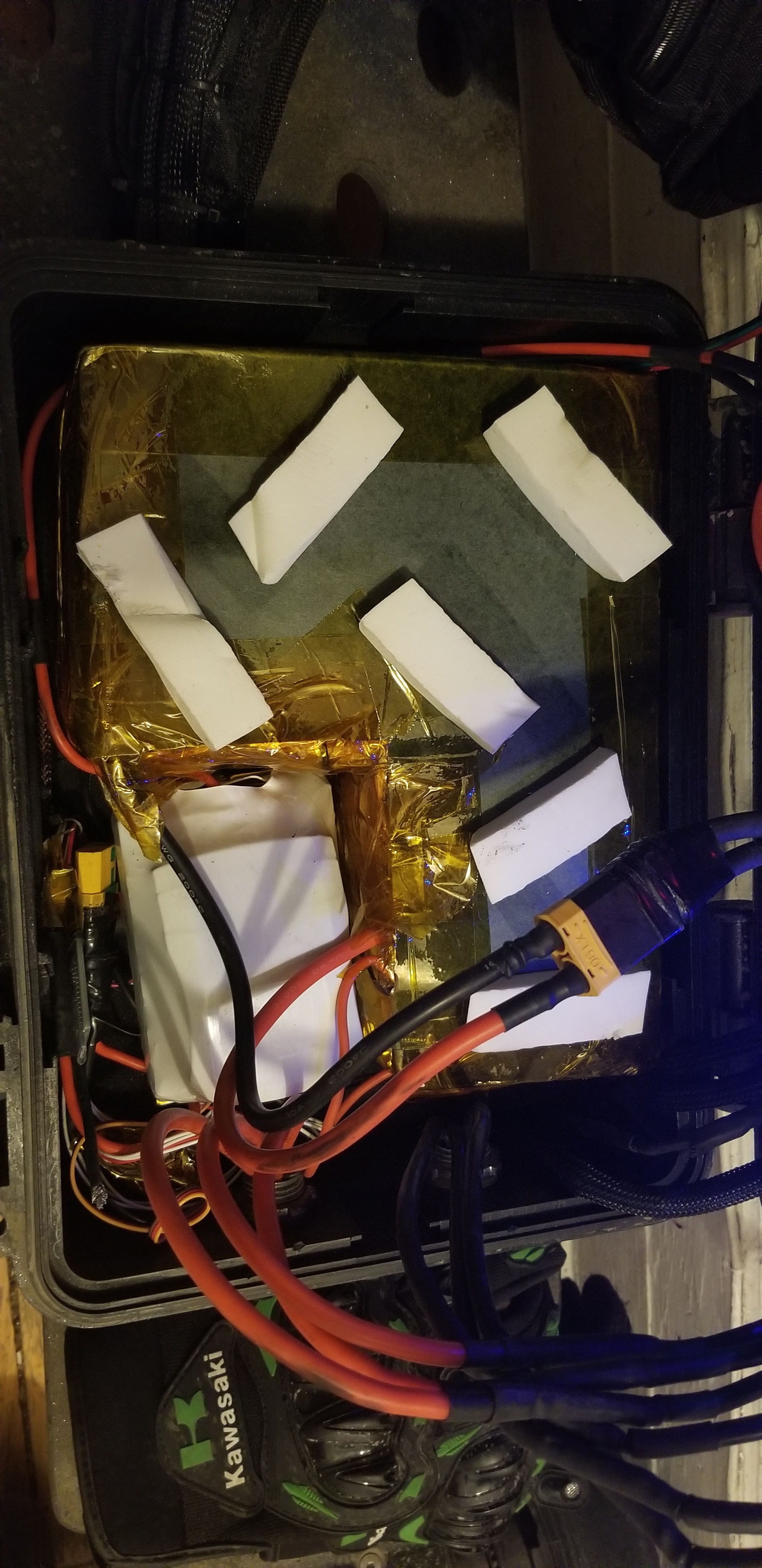

Hey, were you able to fit the 12s7p 18650 nese in the Peli 1200 case? I’m thinking of using Peli 1200 for 12s8p nese and bms. I would put VESC and stuff outside the case.
hey yeh it just fit it wont fit a 12s8p unfortunatly if you go the neese route 12s7p is the max that will fit with neese as the lid just closes
Thank for the answer. Are you sure that 8p doesn’t fit? Here jehugarcia inserted 8p into the case, but I’m not sure if it would be possible with 12 modules. Also now the nese modules got slimmer with the version 2, so that could also help.
Excuse the mess I need to rip it apart and redo it but I can confirm that they will not fit.
HOLY FUCKING SPAGHETTI WIRE CHRIST!
why in tarnation didn’t you cut the wires? :man_facepalming::joy:
