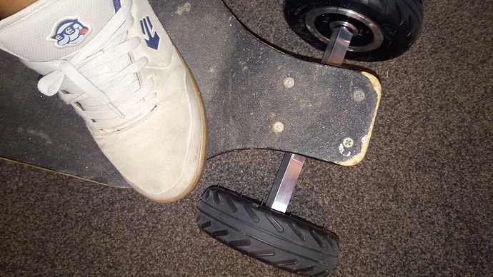

I’ve installed 6x2 pneumatics on a Landyachtz Evo / Caliber 50/Boardnamics 220 hangers, and after my first run around the block, I’m facing the issue of wheel-shoe bite. With my front foot where it belongs on that deck, the wheel can touch my toes when leaning toeside, and it’s clearly not something I’d want to repeat too much. I’m kind of surprised because I’ve seen quite a few builds with pneumatics on Evos. I’m just a size 10 shoes, and there’s only a couple of cms that overhang, but that’s all it takes to allow contact. Unless I retrain myself to keep my foot a bit less angled and a bit less wedged against the front hump, but that’d feel weird. Any AT evo users who can share their experience?
Pic of board? Just curious
hard to fully lean with no speed and taking a picture, but you’ll get the idea…
Ah yeah, is a bit close. Don’t think there’s anything you can really do about it though tbh without you running some mad weird spacers. I was eyeing a very similar build to that, now I’m reconsidering lol
I can pack the wheels outwards an extra 5mm, but that won’t make much of a difference. Maybe this is an older Evo deck, it’s about 40" with steeper wedging, and what seems like a thicker construction, compared to my other Evo. More angle means more turning, which might be too much with those wheels.
I’ll try on the other deck to see if it is the same.

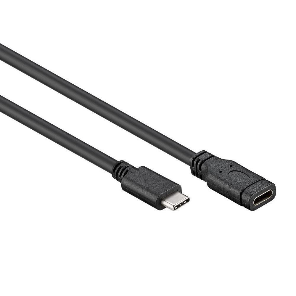

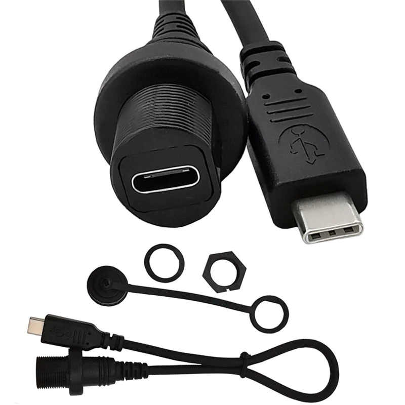

I’m thinking about extending my usb from the esc, to outside the enclosure, so I can do setting changes without Bluetooth and I don’t have to open up the enclosure
Also thought about doing that but vibrations might damage the port on the vesc
Magnetic usb type c might work slightly better if you glue it in place

Buy a metr pro you wont ever think about plug in a usb cable again. But if you have tolook at a waterproof solution combine this with a 90 degree usbc adapter. #Aliexpress AU $10.72 5%OFF | 30cm USB-C IP67 Waterproof Cable type-c 3.1 IP 67 Male to Female Panel Mount Water Proof Connector Extension cord

Look for a panel mount usb c extension cable so you can mount it nice and flush. Preferably with a dust cover
