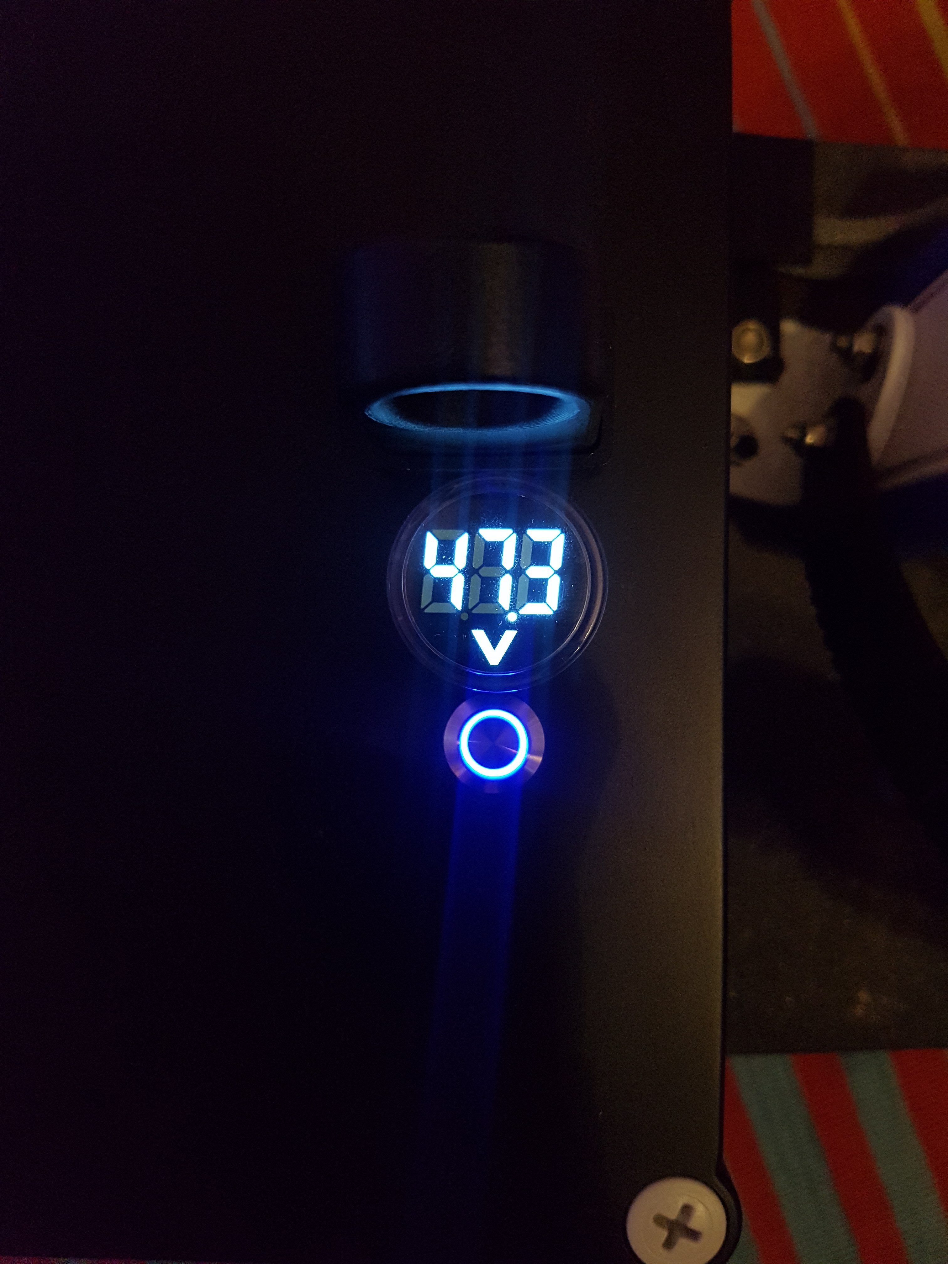

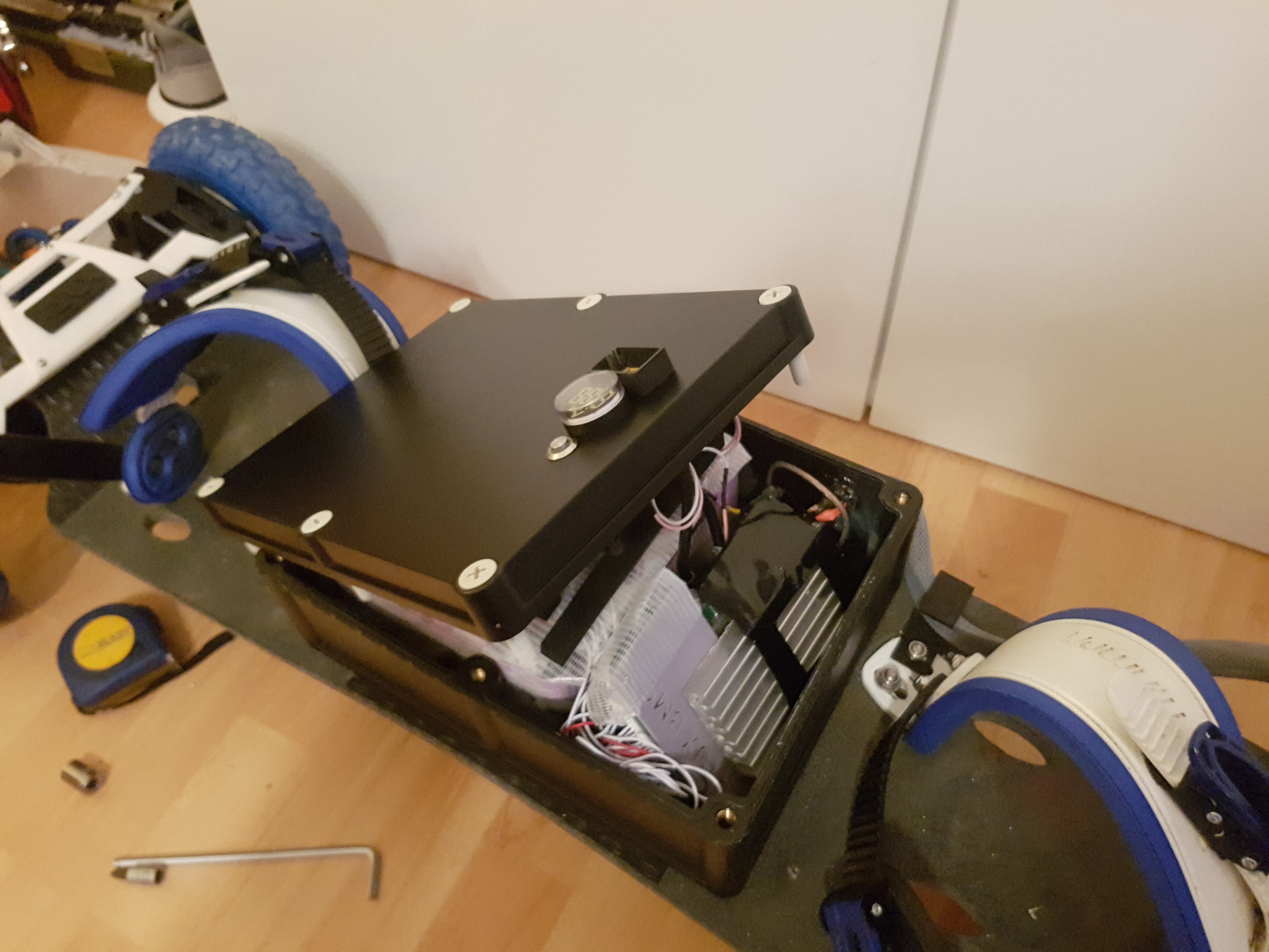

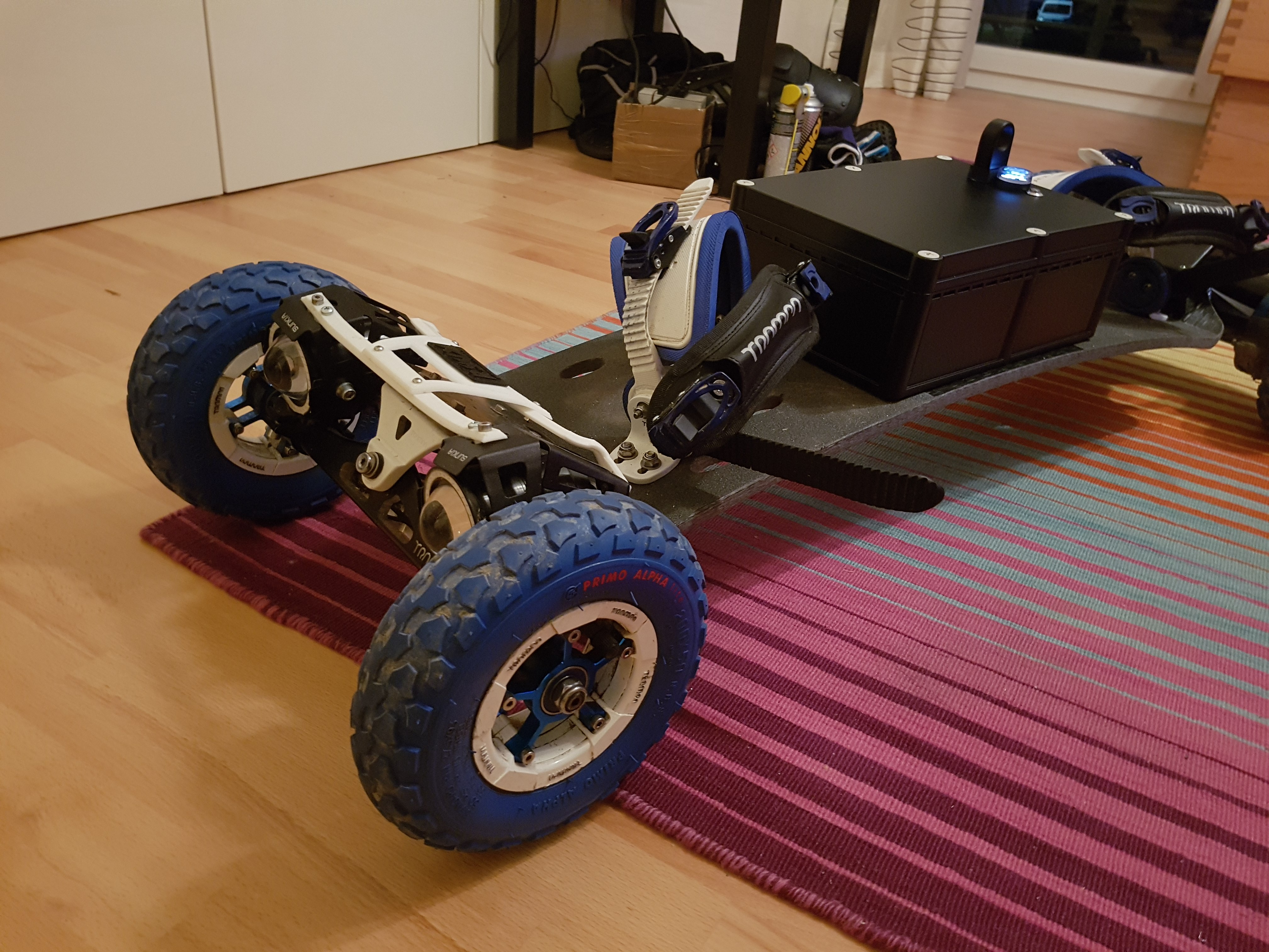

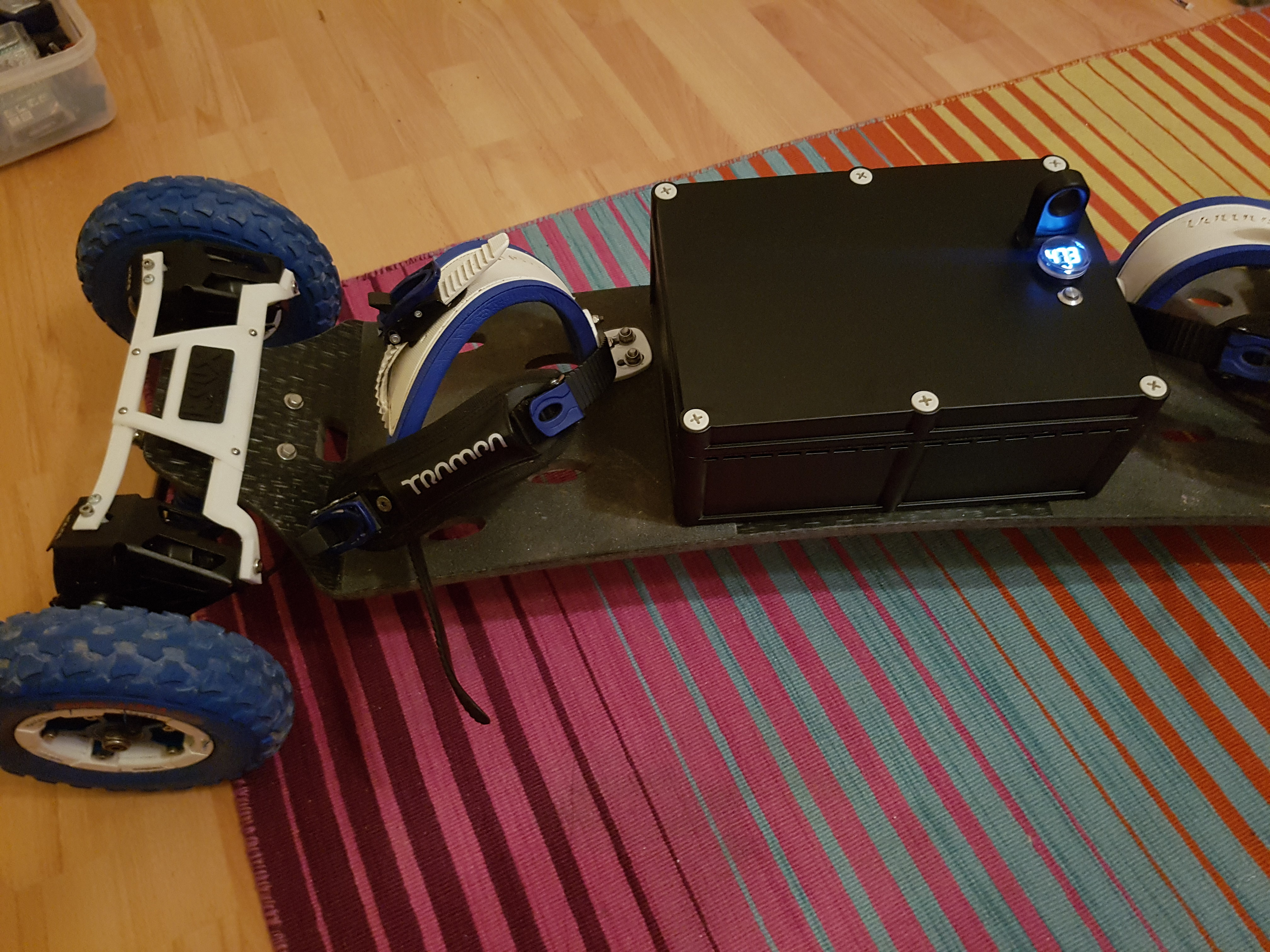

Search up “pvc junction box” and you will find a sturdy, cost effective, non signal-interfering solution that comes in all sizes.
Credits to @RyuX for taking it next level with sanding, priming, and painting it. I will be copying soon.
That is super nice!
It is not what i am trying to acheive. I have a trampa board with and undertray (fiberglass not carbon) and i am scared the metr pro won’t have a strong connection so i would prefer having a small box like trampa beast box that sits on top of the motors with the esc and antenna of the metr pro
Do you think i will have an interferance with a metr pro between a fibre glass enclosure and a trampa deck?
