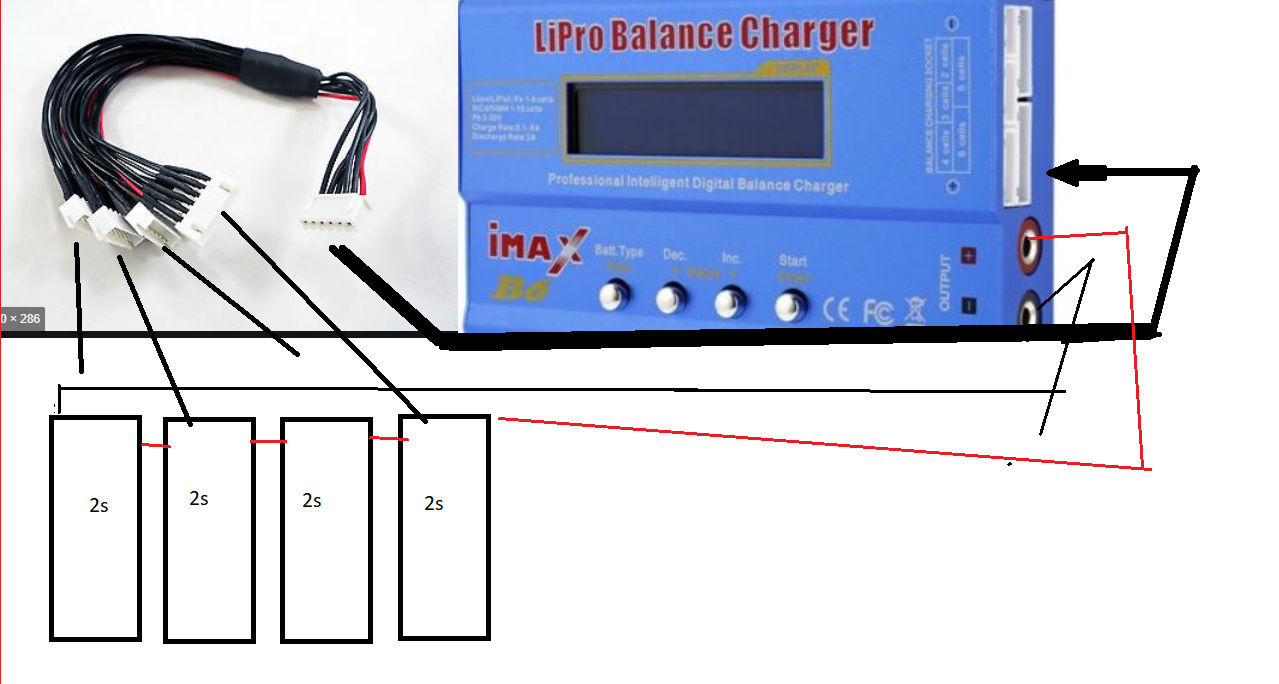

Any reason why this won’t work?
Also if it does why use a BMS for charge only over this set-up? Kinda seems safer?
I think I answered my own question re: why use a BMS> you don’t have to open the enclosure…but is that basically the only difference between a BMS or the above?
most lipo chargers only go upto 6s. the ones that go above that are stupid expensive.
Opening the enclosure to charge the board sucks ballsack.
true just checked it only goes to 6.
It does a bit but BMS and not being wired perfectly seem to be one of the main contributors to fires or bricked batteries so i’m looking for temp solutions till I get the balls to go all out cut the batteries cables and seal it up for good.
equally noob question regarding the same.
can i plug 3x2s batteries into the charger at once? (at this stage I am charging 1 by 1)
Without trying it for fear of ruining my batteries I think the JST connections wont go into the 6s slot unless they are one big JST not 3 small ones?
