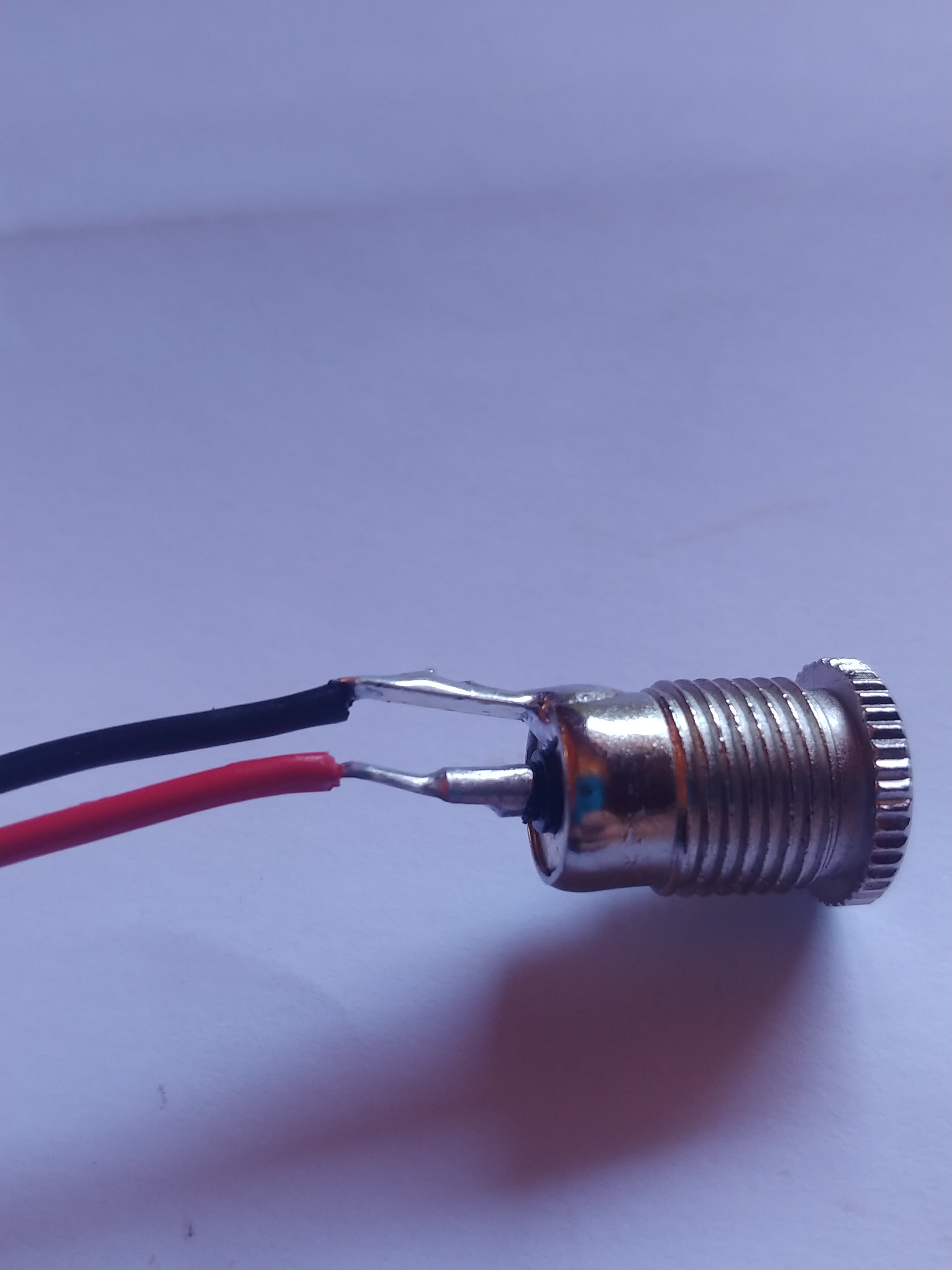

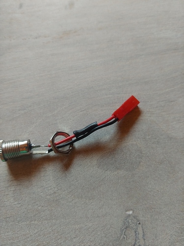

@b264 Does this look okay? I put to much solder on the side pin (black) and it went down the pin and soldered the pin better to the port itself which is a good thing but will the contact be an issue or does this look fine?
I think it looks fine. Don’t forget the fuse.
Fuse?
What bms is it?
Yes, I would solder a fuse inline with either the black or red wire
https://www.mouser.com/ProductDetail/576-099707.5WXN
It’s saved me at least twice
A 7.5A fuse is fine for up to 4A charging
can you post a link or explaine how i do that?
There is a photo in here with one
Don’t have anything else handy right at this second
I would potentially insolate the positive wire all the way to the base of the port. That nut could potentially vibrate loose over time and land on top of the solder joints of the + and - terminal and create a short.
