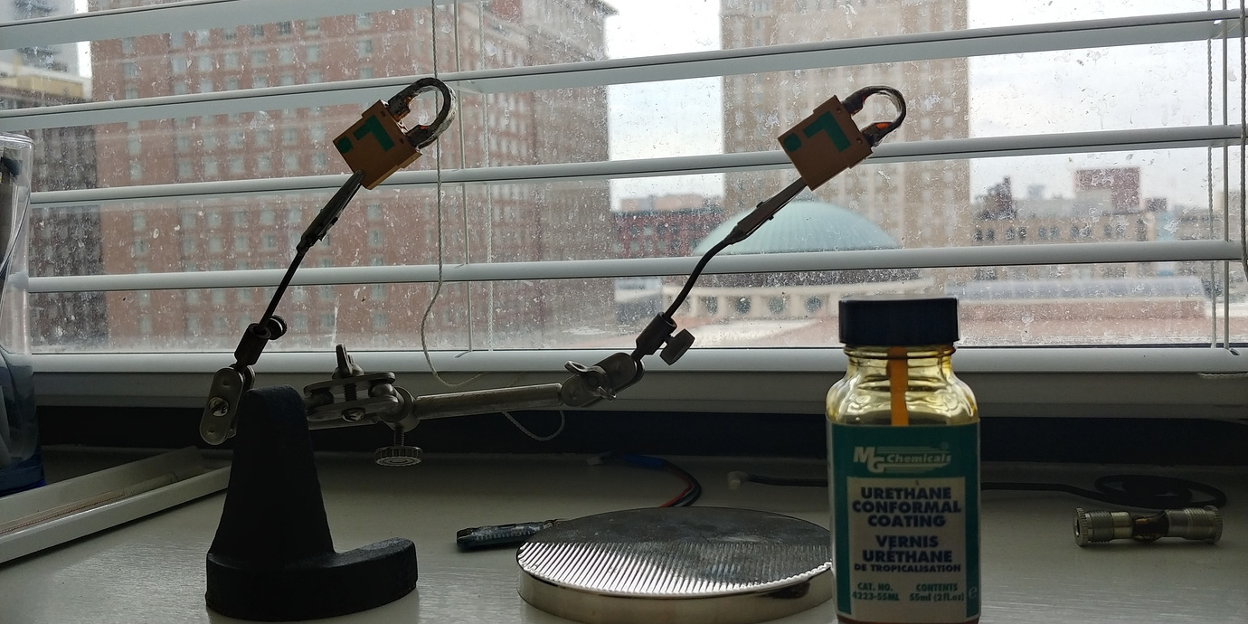

I usually put threadlocker on there to prevent that — and then cover the exposed electrical connections with MG Chemicals #419D Acrylic conformal coating in the 55ml bottle with brush-cap (not separate brushes on the side)

You could use neutral cure silicone like “GE Silicone 2+” in the paint section at the local home improvement store, but then it will not be serviceable. The conformal coating is designed that if you need to, you can solder through it then reapply it again.

Edit i can just saw that they are basicaaly the same. the 419d is more suitable for my application. Ans the 4223 is highly toxic. I mean both are toxic but the 4223 is really bad.
4223 - URETHANE CONFORMAL COATING
4223 is a one-part, fast drying, thermoplastic polyurethane conformal coating. It cures to a durable, flexible, scratch resistant and smooth finish. It is easy to apply and can be handled in 15 minutes. It may be removed with appropriate strippers, or soldered through for repair or rework.
4223 protects printed circuit boards in extremely corrosive environments. It protects against moisture, fungus, dirt, dust, thermal shock, abrasion, short circuit, high-voltage arcing, and static discharge.
Warning: This product contains 2-butanone, oxime (MEKO); therefore, use in a well-ventilated area and continue ventilation for 10 minutes after use.
419D - PREMIUM ACRYLIC CONFORMAL COATING
419D is a one-part, acrylic conformal coating that cures to a durable, flexible and smooth finish. It is easy to apply and can be handled in 10 minutes. It may be removed with appropriate strippers, or soldered through for repair or rework.
419D creates a robust moisture barrier that protects printed circuit boards in humid environments. It strongly protects against moisture, corrosion, fungus, dirt, dust, thermal shock, short circuits, high-voltage arcing, and static discharge.

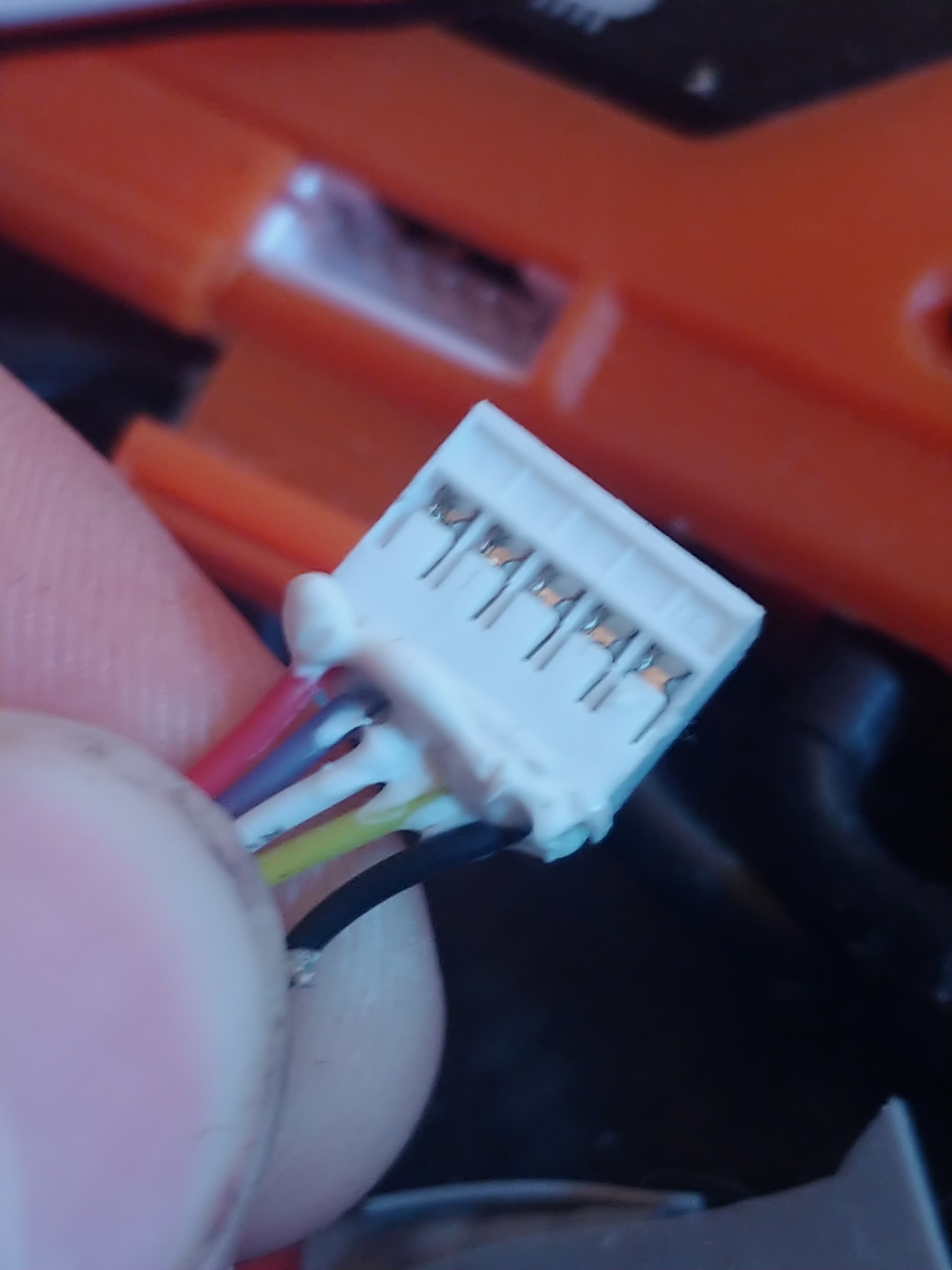

My jst-ph 2.0mm 6 pins connectors just arrived for my motor sensor wires. What order should the wires go into the connector? My motor has 5 wires and the connector (and Focbox Unity) 6 pins.

I like the 4223 only for loop keys and 419D everywhere else. I miss 419C so much. It’s out of production. It was like 419D – except really thin and dries in 30 seconds.
I can’t stress enough – ask the seller before you buy. Get the cap-brush and NOT a cap with brushes on the side.

I don’t have a Unity or any other “dual” ESC, maybe someone else knows.
Which motor?
evolve stock. so like a racestar motor.
Give me a minute I got it
