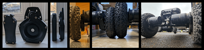

Detailed Features
This drive is seriously compact. It’s only 16mm thin, and sits close to the wheel ensuring a better ground clearance angle than any other drive. This reduced size also means we have managed to get the drive down to 585g all in, including the wheel mounting and all hardware. This is lighter than most POM gear drives with similar ratios.
They look so tiny on 9 inch wheels! :smiley:
The gears themselves are as thin and light as we could get them without compromising the strength. These are blackened so they won’t rust, and hardened where necessary to survive heavy-duty abuse.
They are also incredibly easy to remove and clean/re-grease, or even replace.
The motor pinion assembly also includes a thrust bearing to deal with the axial load.
Additionally, we also use ‘high-quality symmetric left/right gears to ensure that axial loads during heavy acceleration are always supported by the thrust bearings. From what we have seen, other designs have the same helical gears on both sides, meaning that one drive pushes the shaft into the motor whilst the other pulls away. We believe that the Jump Drive is the only steel helical gearbox on the market to fix this issue.
Additionally, in competitor drives, we have seen these side loads cause the drive gear to break free from its lock tight.
However when using Jump Drives with Apex motors the motor pinion can be retained by circlip only, meaning no retaining compound or glue is required, and no heat is needed to get the gear back off. Swapping pinions or motors becomes a ten-second job! As far as we know our motor/drive combo is the only DIY drive with this feature.
The wheel adapter is a true Push Fit design; you do not need to make any changes to your wheel at all to fit it to the drive. You can easily swap a wheel for a fully-inflated spare by just removing the axle nut: the wheel simply slides off the drive.
This allows not only quick puncture changes, but also very fast wheel rotation allowing you to keep swapping your tyres front to back as they wear down. Imagine swapping all four corners from Shit Slingers to Street Slicks in less than four minutes!
The adaptor fits three common wheels. You could have a 6” track setup on Rockstar II’s, 8” street tires on Fivestars, and some 9” offroad tyres on Fatlads. You would be able to swap between them quickly without buying a collection of different wheel adapters for each set.
The Fractional Difference Mount is a revolutionary design that allows many different angles to be achieved. Adjustment steps are merely six degrees apart meaning there’s 60 different angles you can mount these drives at. That’s 15 different adjustments between Vertical and Horizontal.
For improved maintenance, all adjustments are made externally, including backlash adjustment, with a 3mm Allen key. In fact you can fully disassemble the drive with that one tool, making field adjustments quick and easy.
