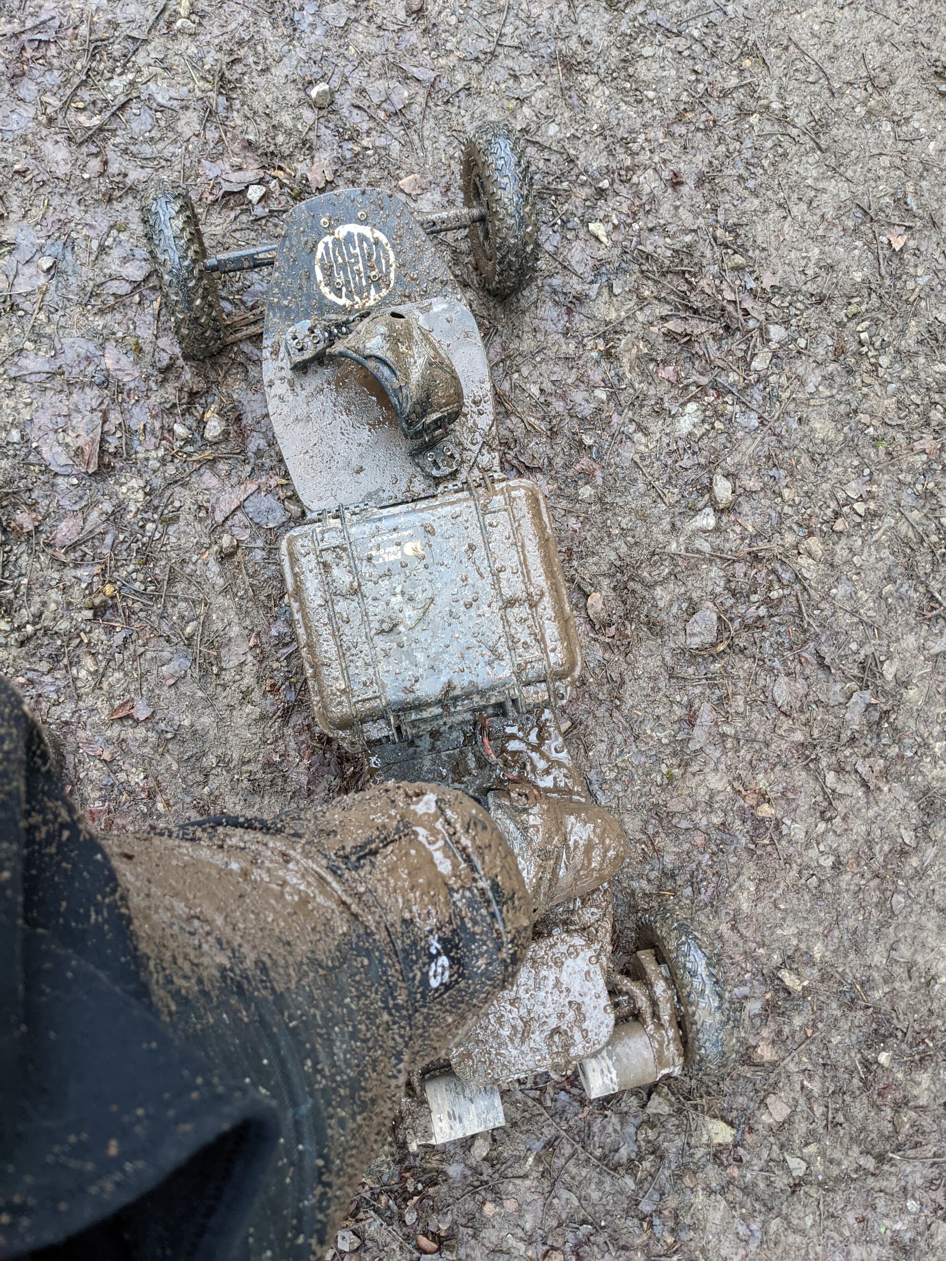

Nice work Apex. How does the weight of the jump drive compare to the chain drive ?
Id be interested in swapping my trampa spur gear drive for something a lot lighter. It only gets used in horrendous muddy conditions but it would be good to shed a lot of weight to make it mroe comparable to my obd board.
