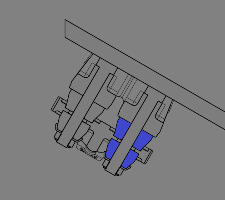

PKP Terminology
We’re going to start basic here to make sure everyone is on the same level.

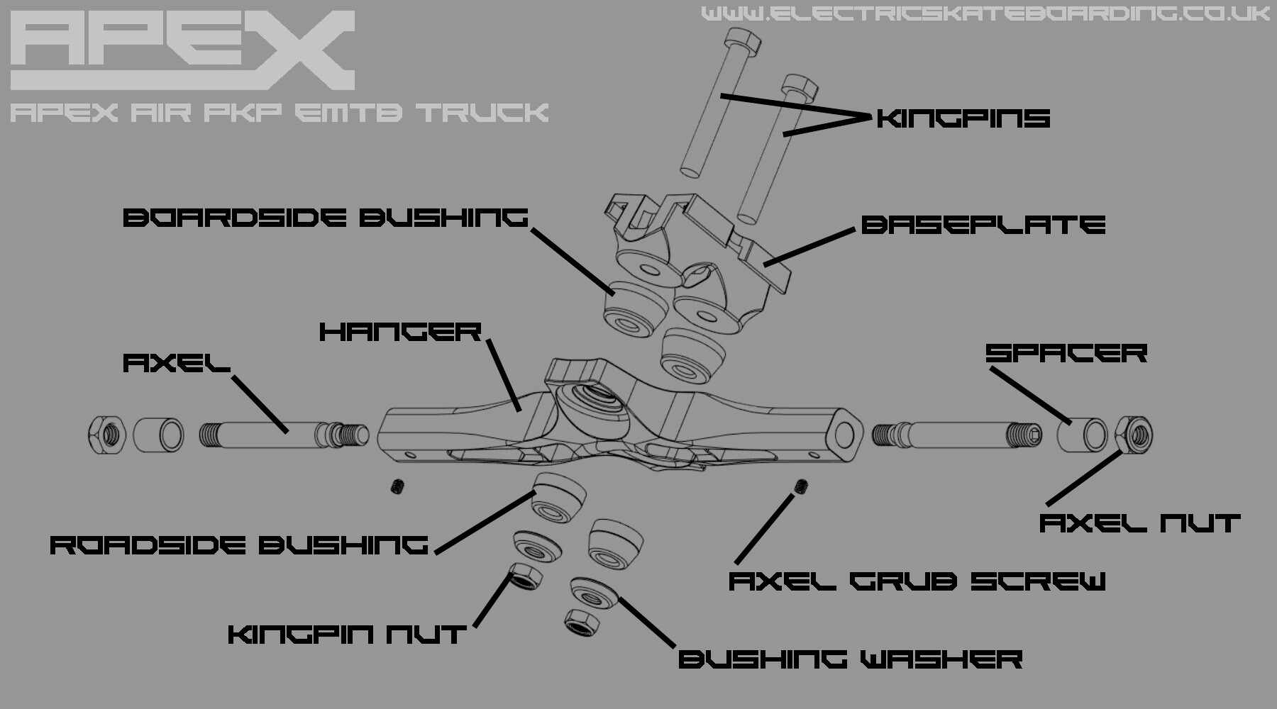

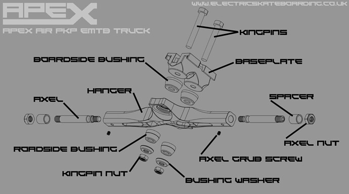

Components
Baseplate - The part that bolts to your board.
Kingpin - Traditionally this is the main bolt in the center of the truck. The PKP truck has 2 kingpins that are mounted in parallel to each other. They slide into the baseplate from above.
Hanger - The main moving part of the truck. On a PKP this has no solid coupling to the baseplate so may be referred to as a “floating hanger”.
Bushings - On PKP these act as the main interface between the hanger and the rest of the truck. They control every aspect of the ride feel.
Cup washers - Keep the bushings central on the kingpin and stop them slipping around during riding.
Kingpin Nuts - Apply pressure to the bushing and hanger assembly. They can be adjusted to set preload on the bushings.
Axles - Screw into the hanger and allow the wheels to be mounted.
Grub Screws - Are used to secure the Axles in place
Axle Spacer - Keeps the wheel bearings correctly spaced away from the hanger. On some electric setups this will be replaced by drive mounting hardware.
Axle Nuts - The nuts that hold hold the wheel on.
Features and Geometry
Bushing Seat - The part of the hanger that the bushing sits into.

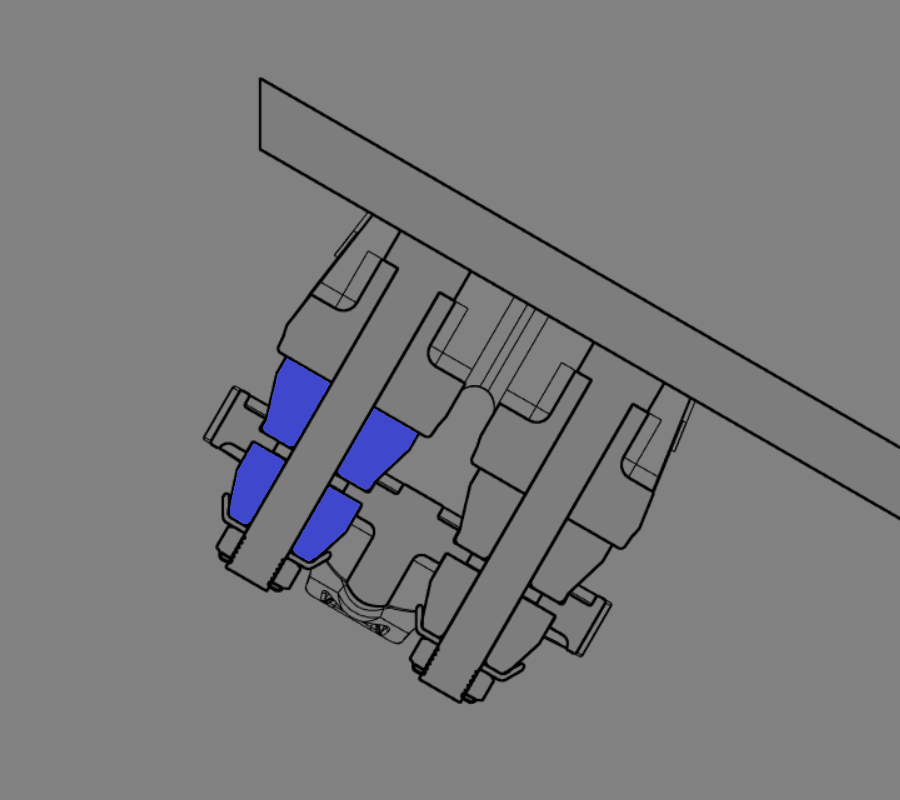

Pivot Axis - Whilst the PKP truck is able to rotate slightly on all 3 axis, the dual sets of bushings constrain this movement to be predominately in one axis. This is called the pivot axis and it goes directly through the center of the bushing seats, front to back, parallel to the board.
Pivot angle - This is the angle between the pivot axis and the ground. As with many other channel trucks we have been using a pivot angle of around 35 degrees.
Axle Offset (sometimes called Rake) - This is the distance between the center line of the axles and the Pivot Axis. Apex Air has a positive axle offset like many other channel trucks (The axle sits below the pivot axis).
Bushing Positions
On the PKP Truck there are 4 bushings on each truck. When discussing bushings we will use these names for their positions.
Road-side Bushings - face down toward the road.
Board-side Bushings - face up towards the board.
Far-side Bushings - On the kinpin furthest from the rider.
Near-side Bushings - On the kingpin closest to he rider.
Traditionally the road-side bushing is called the “top bushing” despite being on the bottom whilst riding. Similarly the board-side bushing can be called the “bottom bushing”. We found this gets confusing so prefer using road-side and board-side as they are easier to remember.
When discussing setups a single bushing can be specified with both terms eg. “I use a green cone on the far roadside bushing”.

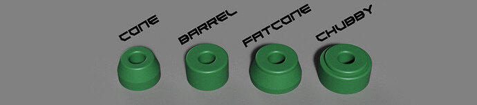

Bushing Shape
The bushing shape controls the relationship between between the lean angle of the truck and the amount of force required to produce that lean angle. Its what controls how linear or progressive a turn will feel.
We have been testing KranK™ bushings in the 4 standard shapes.
Cone
The cone shape has the lowest resistance and stability of all the shapes and can allow your trucks to easily achieve their full lean and turn without loosing the feel of the truck. On PKP this results an a super carvey setup that feels like no resistance is added the more you lean, similar to DKP trucks.
Barrel
The barrel shape offers the next step up in stability above cones. On PKP these seem to give a very liner feeling where the more you lean the more resistance you feel and the more force is required. This is the type of response that feels familiar if you’ve ridden barrels or shockblocks in the past.
FatCone
The FatCone shape has the same initial stability as a barrel but as you lean they offer a progressively higher resistance. On PKP these can be used in high speed carve setups where pushing hard into a carve will give a lot of resistance improving stability.
Chubby
The chubby shape offers the highest stability of all the shapes. They still turn very well and can be used in a softer durometer If you are looking for a stable yet plush and comfortable setup.

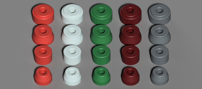

Bushing Durometer
The KranK™ bushings come in 5 durometers.
Orange Red - 84a - Softest
White - 87a - Soft
Green- 90a - Medium
Wine Red - 93a - Stiff
Grey - 96a - Stiffest

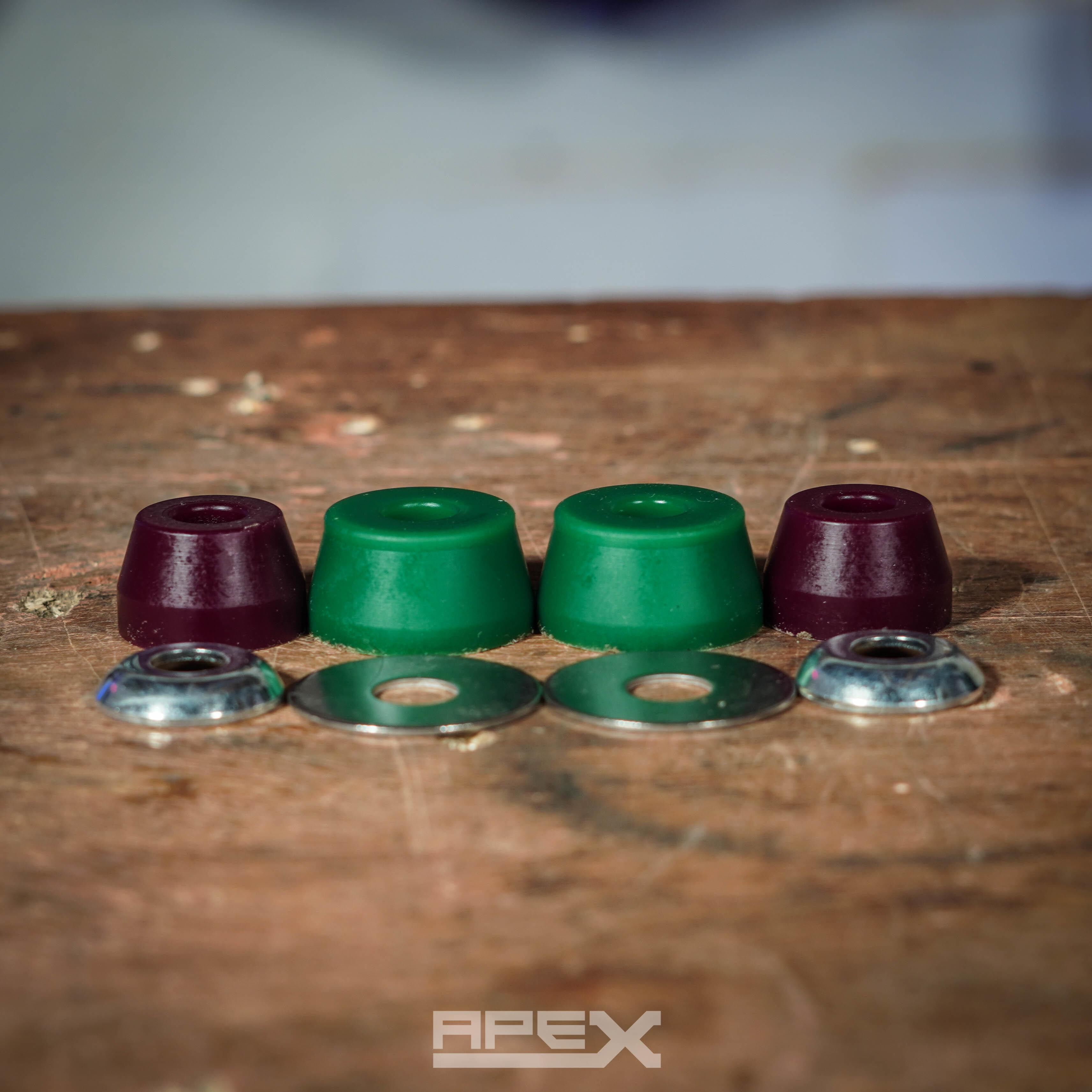

Apex Recommended Setups.
We have 3 main bushing sets that are available to purchase with the Apex Air and will also be available separately.
All of these sets use a fatcone & cone combo. We found this to be a well rounded combo that feels similar to what riders are used to from other channel trucks.
All our sets also feature softer board side bushings to give you that bump-free AIR feeling.
Medium Bushing Pack
Orange red fatcones board side and green cones roadside. This is the default and recommended bushing set for most riders. Its a the best option for getting started. This soft but stable setup is ideal for riding street and mixed terrain.
Soft Bushing Pack
Orange red fatcones board side and white cones roadside. This set is for lightweight riders who want a carvey feel for riding street.
Hard Bushing Pack
Green fatcones board side and wine red cones roadside. This set is for the hardcore riders who plan to “send it” at 30mph through the forest and off huge jumps.

So the axle is directly in-between the bushing seats more or less?
I’m trying to think which bushing is predominantly taking the bodyweight load, traditionally your boardside bushing is a little harder to support rider weight. Obviously here both boardside bushings are taking up some of it, but because of the axle location and mounting angle weight is going to go towards one more than the other.
Wonder if there’s any scenarios where you’d run two different boardside bushings because of this.
One of the hypothetical limitations of this family of trucks is that you’re relying on the bushing seats to limit rotation outside of the pivot axis much more than on a traditional kingpin truck. I’ve never actually touched one, but I presume that you have a trade of appearing between precision turning and degree of lean based around how restrictive the bushing seat is. Is this something that’s been noticed? Any difficulty at all getting appreciable lean without the trucks becoming sloppy?
Have there been any experiments with putting the kingpins out of perpendicular with the pivot axis?
With TKPs, that’s one of the reasons they’re able to lean so much with compact bushings.
There was one of these 4 bushing trucks I saw a long time ago that actually had the two kingpins at 90 degrees to each other, that’s about as extreme as I imagine it can get.
I‘m definitely going to play with that as soon as I do receive my set of white fat cones.
I think I can get my setup a bit more turnable while maintaining the same stability at speed.
On apex air the hanger is symmetric and the axle runs in the centre of nearside and farside bushings. However there is positive rake so there is a small offset between the center line of the axle’s and the pivot axis.
When at a 35° angle during normal riding this means that the far boardside bushing carries slightly more weight than the nearside bushing.
Im not sure if this carries over due to the weight being distributed through more bushings but it would be an interesting experiment.
This is a great question. I have not tried a setup like this but it could be possible that running softer nearside to compensate for carrying less weight might soften the ride a little.
At super low speeds a setup that lacks preload feels a little odd but as soon as you reach snug it seems to sort it’s self out.
This is true and softer business definitely limit off axis less but we have yet to notice any issues with this.
It’s hard to explain but off axis “slop” doesn’t feel as you would expect. Bumps that knock the truck off axis are not transferred to the deck, and without constraint from the deck the truck easily jumps the bump and returns to its correct rotation.
Additionally the the reduced inertia of the hanger and means it can bounce and respond much quicker to un even surfaces. But as these quick movements are decoupled you don’t feel them. It’s a strange sensation looking down at crazy vibrations but hardly feeling them.
